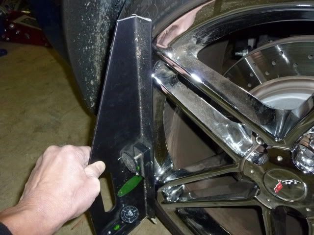

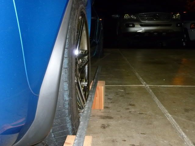

These are the tools that work for me...
Is that toe gauge available anywhere? Id like to buy one
Old Dec 5, 2020 | 01:07 PM
383vett's Avatar
383vett
Joined: Apr 2003
Posts: 17,700
Likes: 1,667
From: moraga ca
Amazon Amazon
