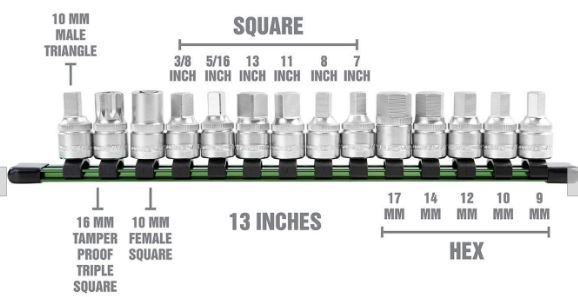

A set like this would be handy... https://www.summitracing.com/parts/oes-25374
