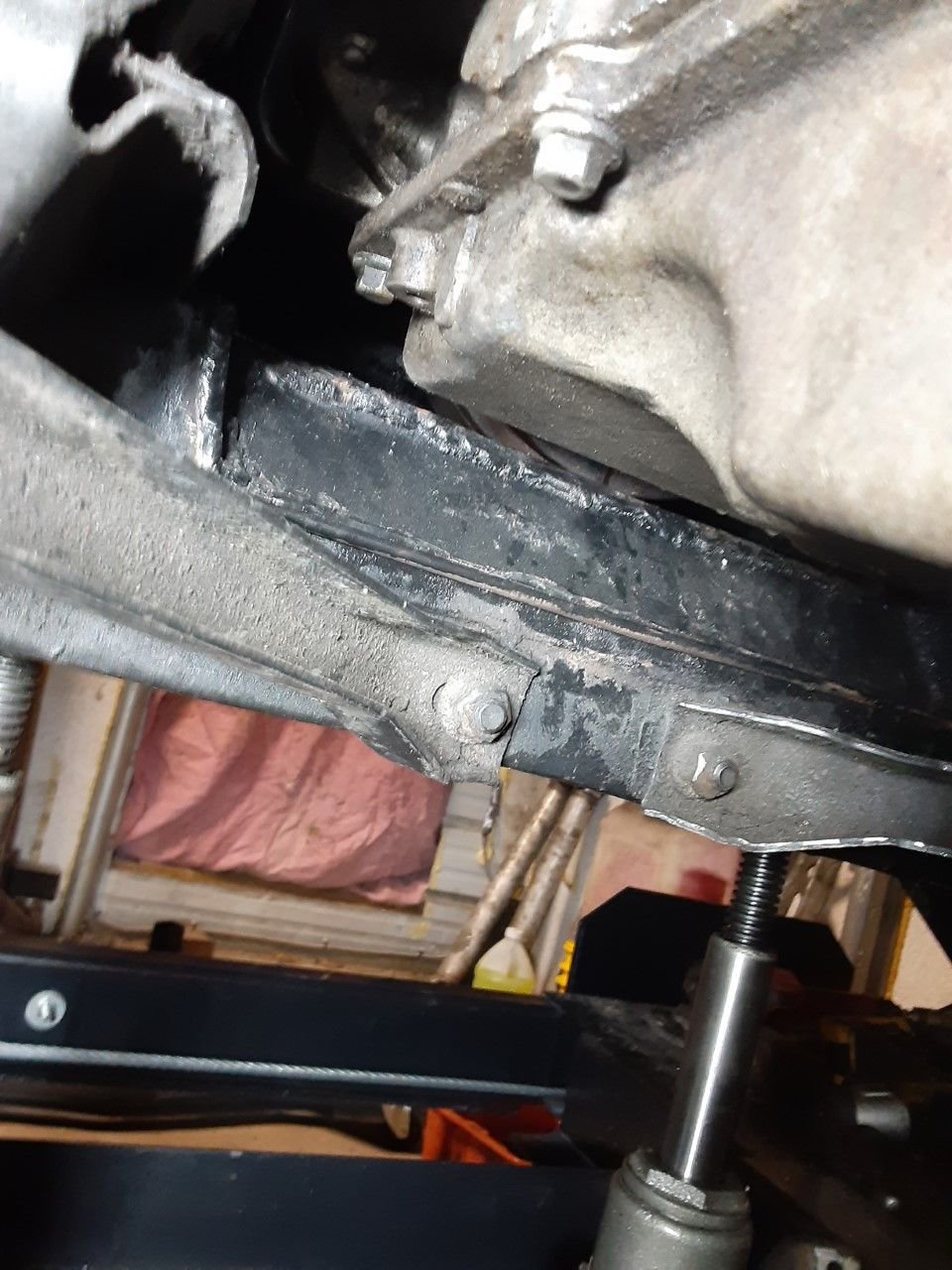

Ok so I have a really unique problem and I'm looking for some advice. The car is a Z51 84 that's LS6 swapped with a 4L80e and a Dana 44. Here in PA we have a foot of snow on the ground so I'm not driving the car any time soon, So after I got the new transmission in I decided to lower the front of the car. I got the basic kit with the rubber wedges and I pulled the factory spring out. The rubber was all shot. The spring looks ok though.

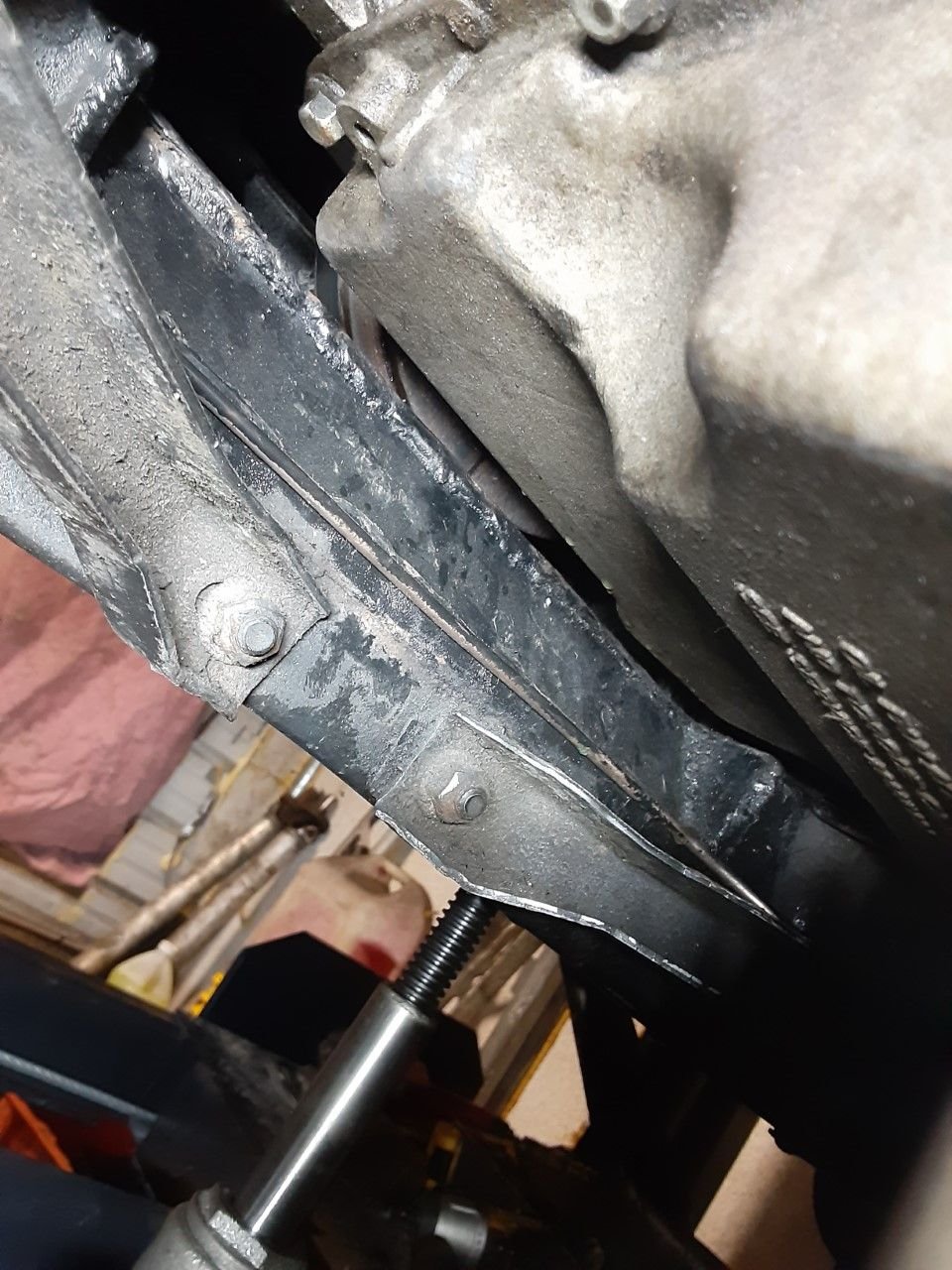

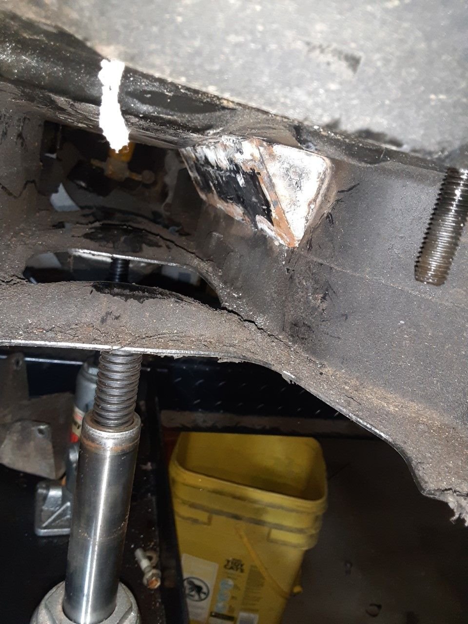

Here's the problem. When I did the LS swap years ago I used a Camaro oil pan. I had to notch the cross member to clear the oil pan. I welded in a 1/8" thick steel plate over the hole to fill everything in nicely. Well when I went to put the factory spring back in last night with the lowering blocks, it won't fit. Because of the shorter blocks It will hit on the plate I welded in. So this leaves me with a choice to make. I could pull the motor back out and re-fabricate the plate in a way that will allow the spring with the shorter wedges to go in. Or I could install coil overs.
I have absolutely zero experience with coil overs. I don't auto cross the car at all. I do enjoy some "spirited" driving and I love the handling of the Z51 spring with Billstien shocks. So if I did coil overs I just want something that would handle the same as what I had but would allow for adjustable ride height. I know that most coil overs won't fit on an 84 without work. I found an old thread here with this picture of what user rklessdriver did.
I like this idea. I could easily weld the mount on top like he did. I was thinking about a set of QA1 shocks and springs. 350 to 400 pound spring rate. The shocks are one way adjustable. The price of all the parts seems really reasonable. But will I get the same feel as I did before. What do you guys think?

You should be able to approximate the same feel with coilovers but you may have to tweak the roll bar. You lose some of the anti roll properties of the mono leaf removing it. But that being said a good set if coilovers should be as good or better imo.

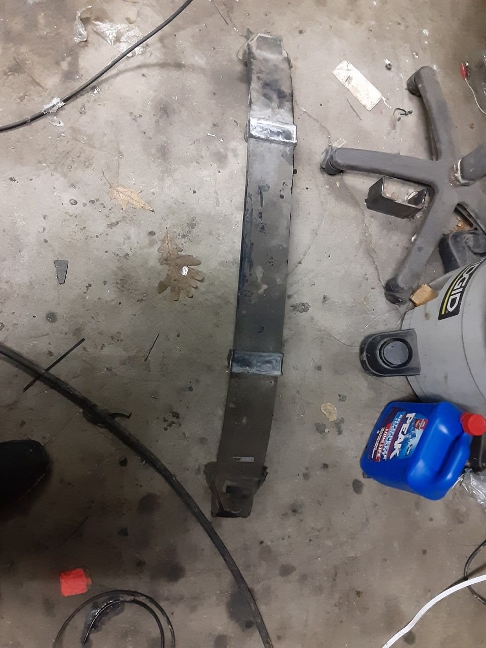

That's what I was hoping. After a little more research I think this is for sure the route I'm going to go. A lot of people want the 84 Z51 front spring. They sell on ebay for way more than I thought they did. Also my Bilstein's on the front are still in good shape so I can sell those and the aluminum spring brackets I got from an 89. I could sell all this stuff and only spend around $100 out of pocket to do coil overs. Kind of nuts really.

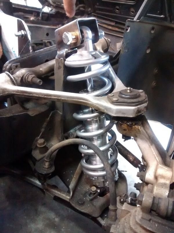

Just a little pointer I learned from my conversion.
Spend some time mocking everything up with the front suspension at various heights/travel. You will have to grind or cut the factory shock tower back a bit towards the top. The further you can angle the coilover back at the top the less it will rub on the upper A Arm at full droop.
I only barely ground my tower back at the very top and my spring rubs pretty hard on the A Arm at full droop.... it dosen't bind anything up and mine being a radial tire drag car the front suspension extension is limited anyway but it would be more important on a daily driver.
Also fully weld the tower to frame seams..... there's only a few spot and seam welds from GM.

In my opinion restoring the cross member is the safe route. Pulling the engine is the main part of the work.
For street use, or even for racing, you have to invest some time and parts before you get a coil-over soluition that is 'better' than the stock spring and shocks.
To do the coil-over correctly you have to spend a lot more time designing and fabricating top shock mounts compared to just restoring the cross member.
Even if restoring the cross member it is still possible to do the coilover conversion in the future if you would decide to do that.
