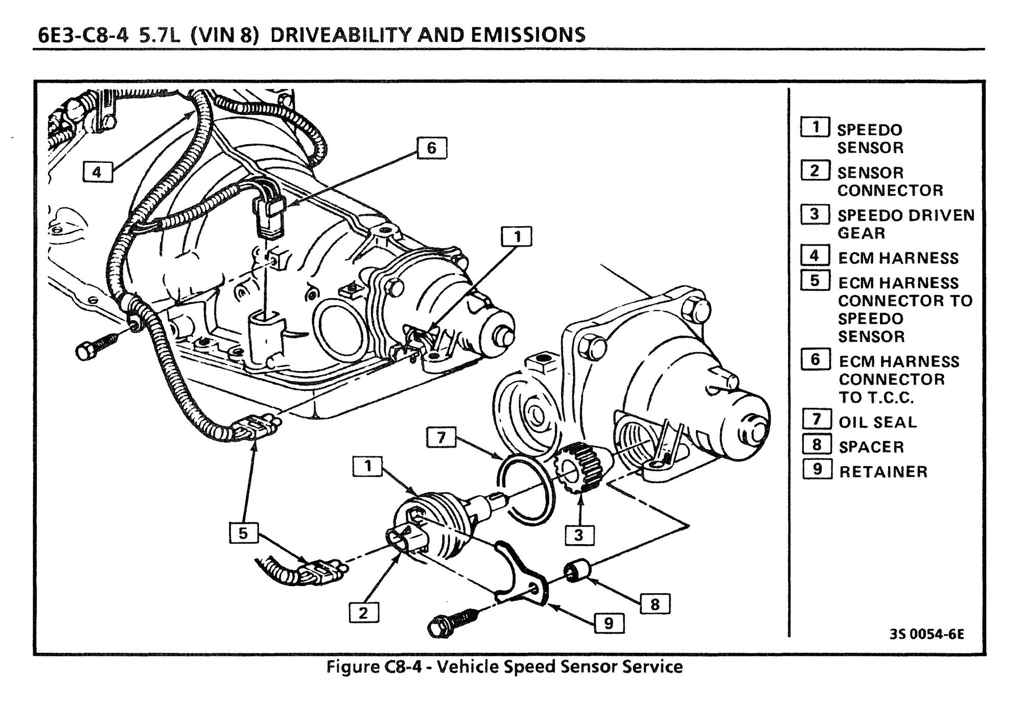

65Z01, do you mean the TCC electrical connector to the ECM? Connector #6 in the diagram?
Thanks, Went
