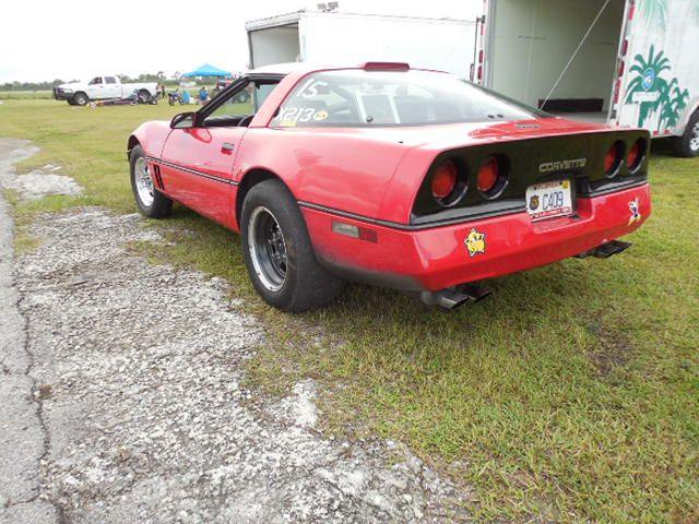

..... Mickey Thompson ET Drag slicks ... 26x10.00x15 on 6.5" backspaced Weld Pro Star Wheels ... 87 C4 ... I have a pair of the slicks for sale (no wheels) 25 passes in case you're interested ... I have also run 275/50/15 M/T drag Radials ... selling a lightly used pair of those as well .....

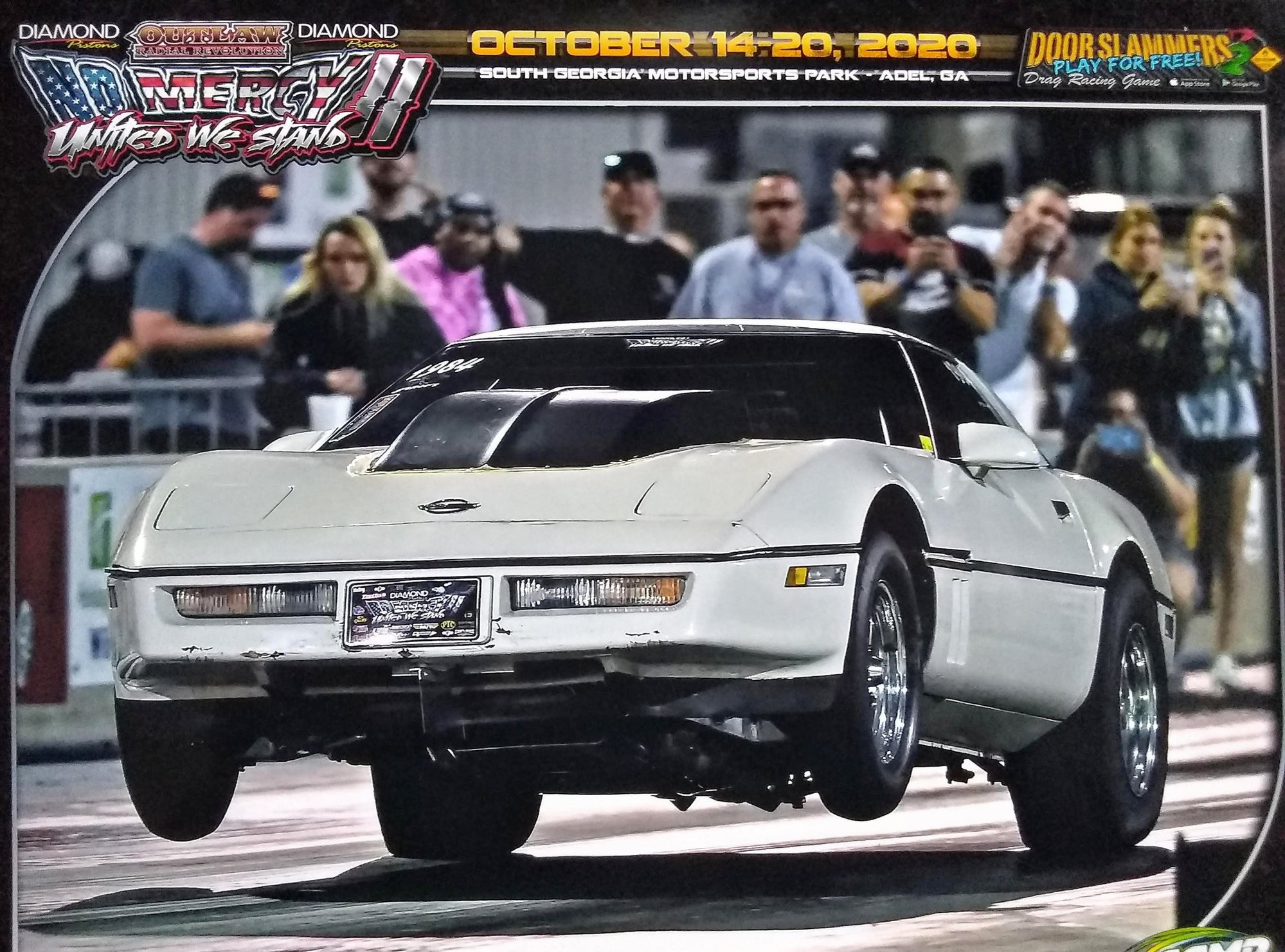

1984 C4. Started out running the 28x10.5 stiff wall bias slicks, then moved to the 275 60R15 Pro Radial and currently run the 275 60R15 SS radial which is a class mandatory tire..... 15x10 6.5 Back Space wheel.

Because they are the best tire for most heads up racing. MT has put more R&D into small tire racing over the past 20yrs than everyone else combined. Espc radials. Cars are faster on 315 radial than they on Pro Mod slicks, and by a bunch..... current record of 3.57 at 206mph in the 1/8th... 3.69 on a 275 radial. Pro Mods struggle to go 3.70s. Heck my C4 runs low 5s and 1.15 60ft on the SS 275 which is a real street tire.
The only place MT does not have the best tire is the NHRA Fuel classes and Pro Stock. Goodyear owns them period. Goodyear is a giant of a company, the team relationships they yave and the R&D $$$$$$ they have spent in those classes over the past 35+ yrs can't be matched.
Lots of experience with Hoosier. The bias slicks are fast for a short period on high powered cars.... right before the sidewall gets knocked out of them. Lots of guys run them for No Prep but I'd rather not take tire tips from guys that destroy hundred thousand dollar race cars every weekend. Their 275 radial was pretty good about 10yrs ago but they stalled out on the R&D and MT has just ran away from them. They are fine tires for bracket racing.
M&H. You got to be kidding. They haven't made a competitive drag racing tire since the 1960s.
Will
