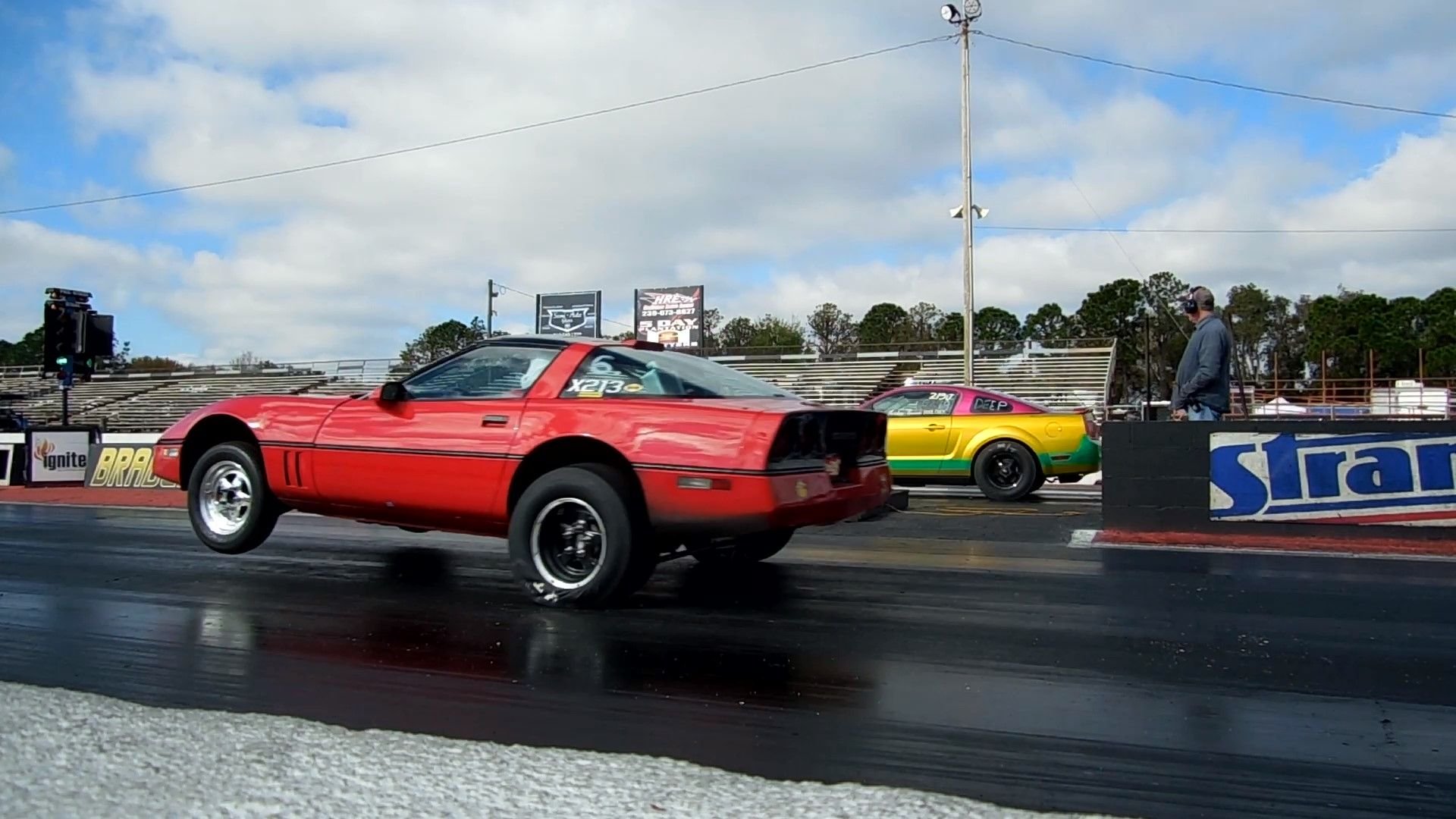

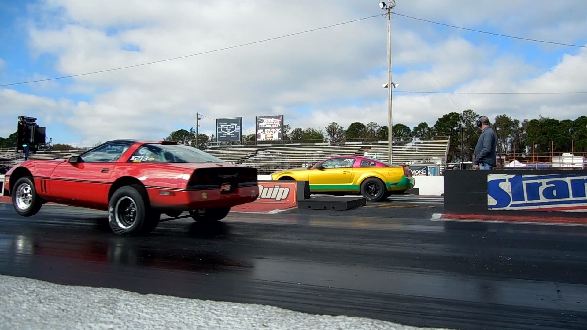

..... Check out that extension ! ... really planted the slicks ... got some tuning to do to get the front down .....

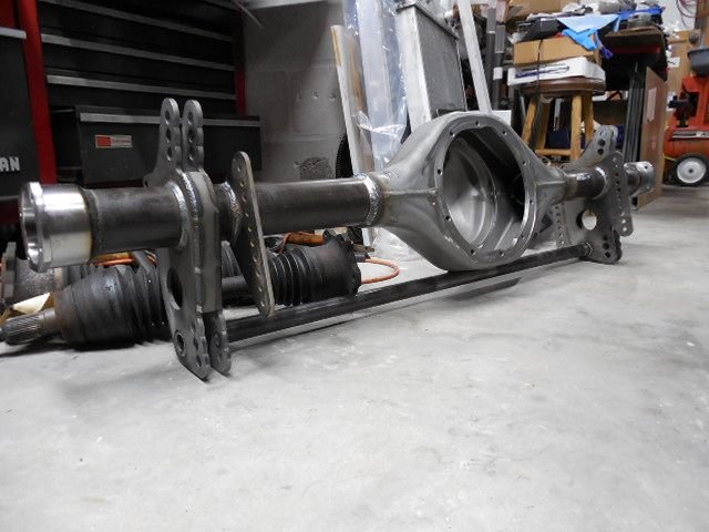

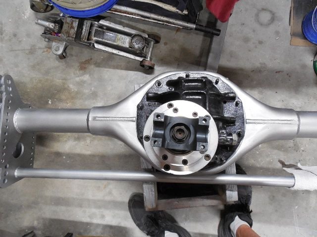

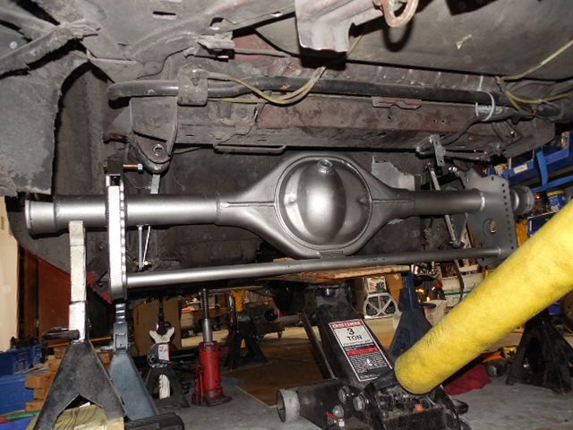

..... Moser Housing and Axles .....

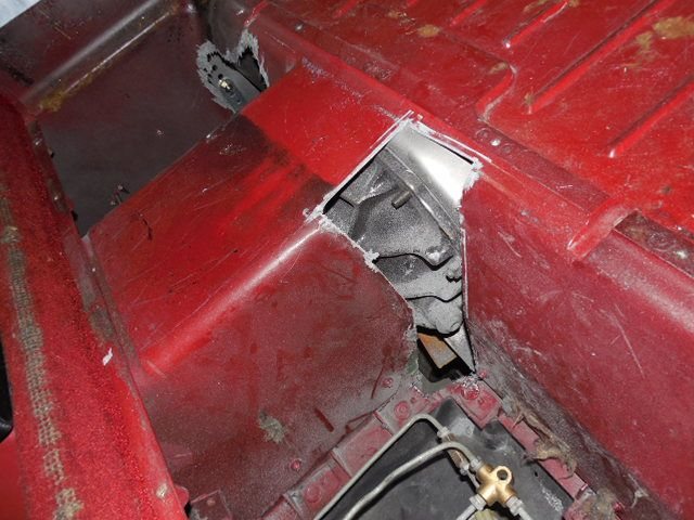

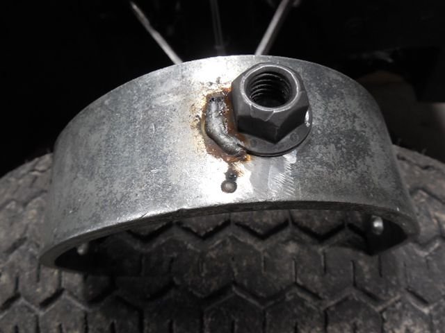

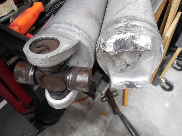

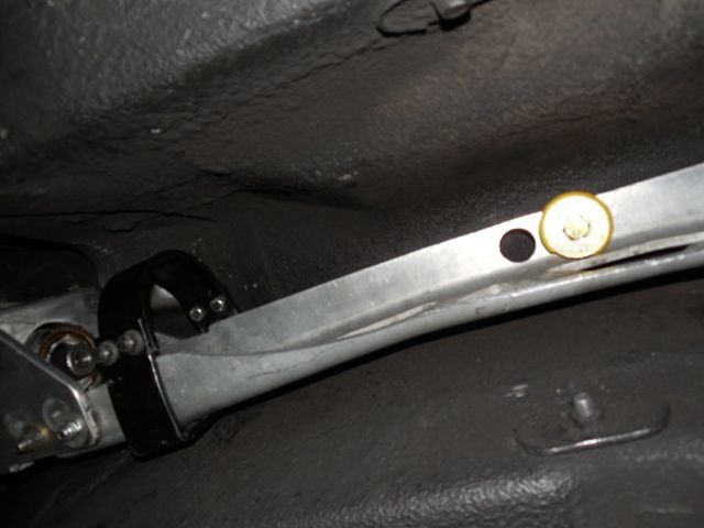

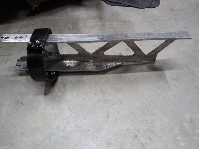

..... Trans mount ... I went up instead of under ... used the C-beam , half of a driveshaft hoop , and a poly mount to secure it to the hump under the console .....

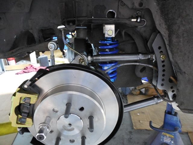

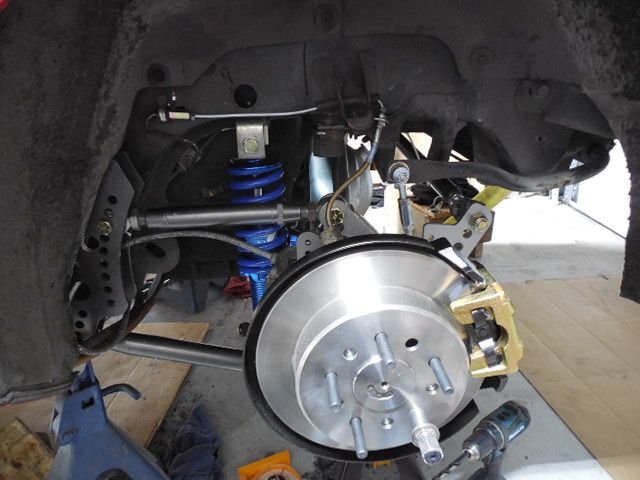

..... The economy brake kit was from Moser ... 96 Ford Explorer ... the park brake in the rotor hat was almost the same size as the OG 'vette's ... I was able to modify the Ford brake lever and attach the 'vette cables .....

Nice Job!
What is locating the rear? What size rear springs (pounds and height).
Do you use a transbrake?
Thank you,
Steve
Old Feb 21, 2021 | 02:04 PM
C409's Avatar
C409
Joined: Feb 2005
Posts: 6,481
Likes: 566
From: Clearwater Florida
Originally Posted by STEVEN13
Nice Job!
Thank you,
Steve
..... Panhard bar ... springs are 7" 400# on 4" stroke shocks ... I have a pair of 10" 250# that I will try ... I have a trans brake but this hit was from idle ... I need to calm down the extension but keep the tires planted ... best 60' was a 1.403 (previous best was 1.41) and unfortunately , I never made a full pass but went 3 rounds ... based on the incremental ET's I was on a 6.67-6.68 pass with the 1.40 60 footer .....

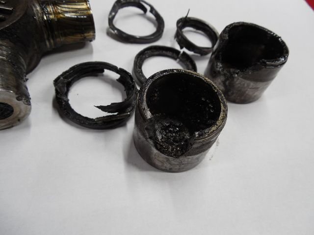

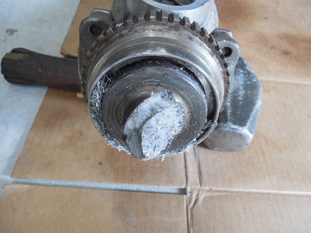

..... I was breaking u-joint caps and crushing the needle bearings and broke a couple of outer axles ... I tried hard to stay with the D44 and even tried to down tune the car to help ... the last straw was when I drove 3 hours one way to Imokkallee for their Winter Fest 3 day race and broke an axle on the staring line on the very first time run ... it was a long drive home ... as most drag racers have already discovered ... There just comes a time .....

Old Feb 22, 2021 | 05:27 AM
JoBy's Avatar
JoBy
Posts: 2,150
Likes: 304
From: Timra, Sweden
That looks like a lot of anti-squat
Old Feb 22, 2021 | 08:09 AM
..... The body actually settled about 1.25" higher than anticipated/planned when it finally hit the pavement ... that put the Instant Center slightly behind the center of gravity and just below the Anti Squat line ... the intended I/C was just ahead of C/G and well below A/S ... I was surprised by the amount of separation and how hard it hit the tires but I have a lot of adjustability in the link bars and shocks ... this was the 1st hit on the new set-up ... I'm stoked .....

..... I can't get the video to load ... this is the last snapshot I could get before the front of the car went out of the frame .....
WOW some serious carnage, i have only ever twisted a half shaft.
Got some steel copies made to replace them, the only thing i am not keen on is the brace bar below the 9 inch diff.
You must have well maintained highways over there, be a disaster if that brace bar caught something propping up.....
