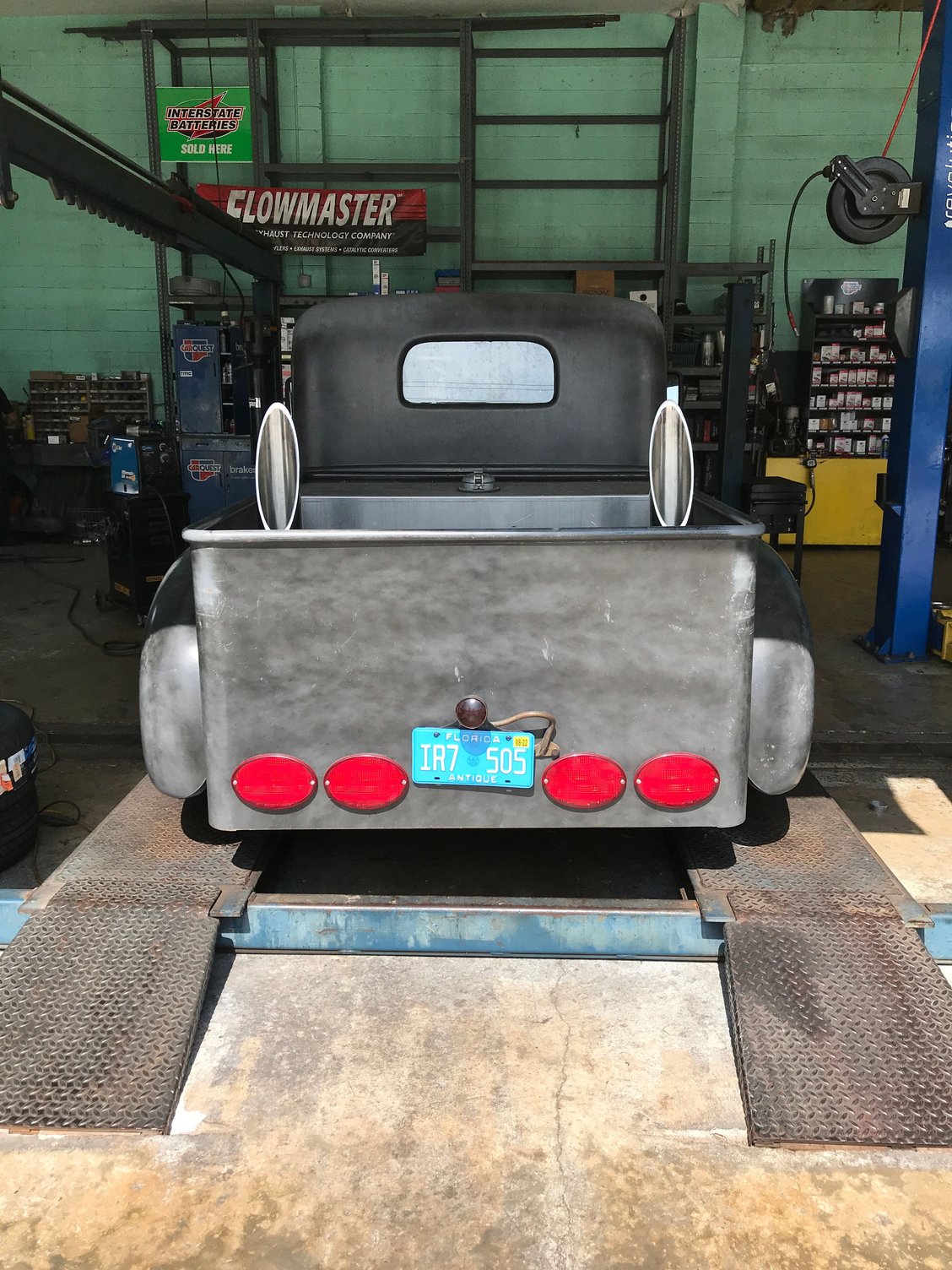

I have a 47 dodge pickup on top of an 1986 corvette The frame was altered to accommodate the pickup cab. 15 years later I’m starting up again.
My 4786 Dodge Vette
Any ideas on how to quiet valve lifters easily to begin with
