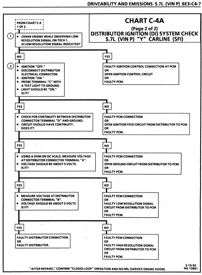

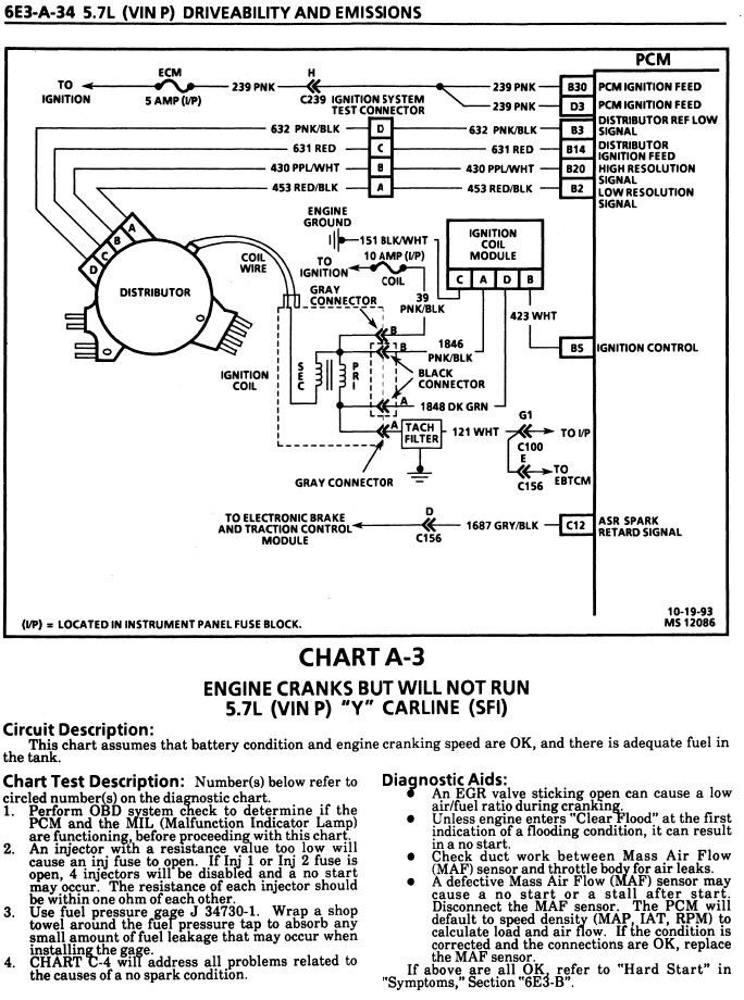

If you don't have a FSM, you really should get one ASAP. It's infeasible to work on a car like this without one. But for now, here's the relevant pages to check your opti circuits...

Likes: 6
This is good stuff. In the meantime, I was wiggling wires between my ecm and opti and my car started. I pressed down on one of the places where I shifted them and it cut out twice in a row. Now it won't start again.
