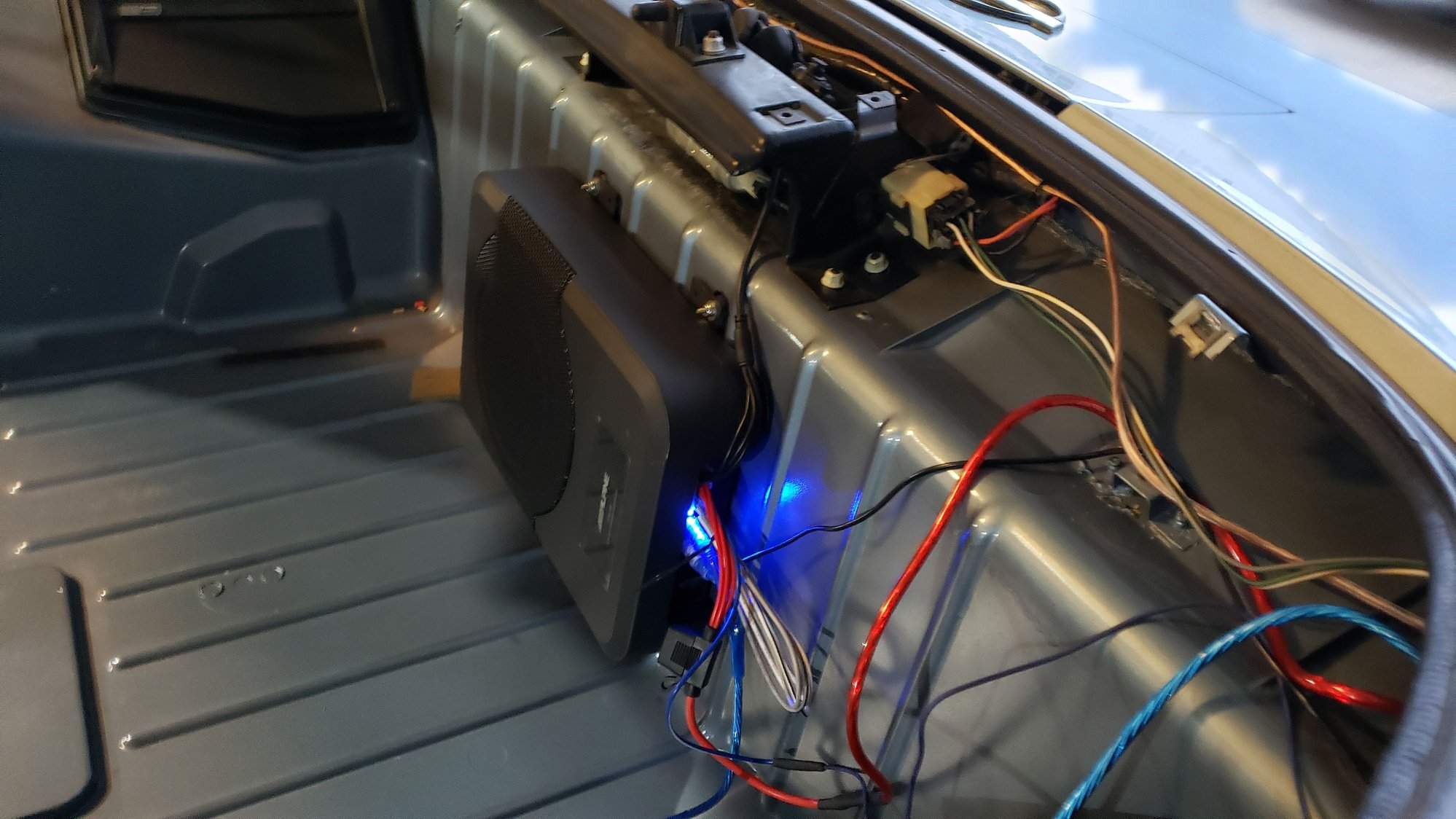

I just finished a total removal of the Bose system in my 85. I used Alpine S-S65C 6.5" components up front, Alpine S-S69 6x9 coaxials in the rear, a PWE-S8 compact sub, ILX-W650 double din head unit and KTA-450 compact amplifier.
These speaker adapters work perfect for the doors https://www.ebay.com/itm/Exact-Fit-F....m46890.l49292
For the rear 6x9s I was able to use the original mounting ring once the Bose speaker assembly was removed.

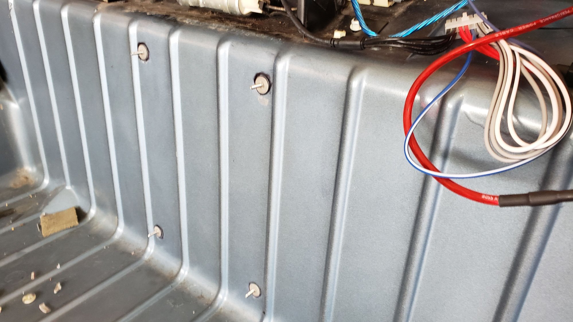

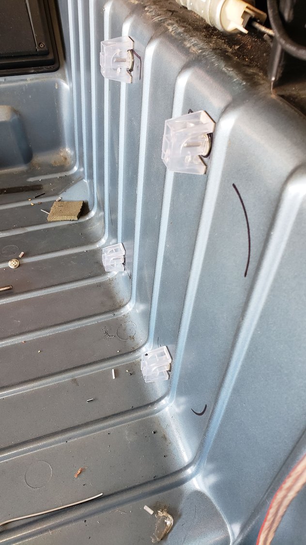

I mounted the sub with clickbond fasteners onto the back wall of the cargo area. I didn't want to drill through it because of the gas tank location.

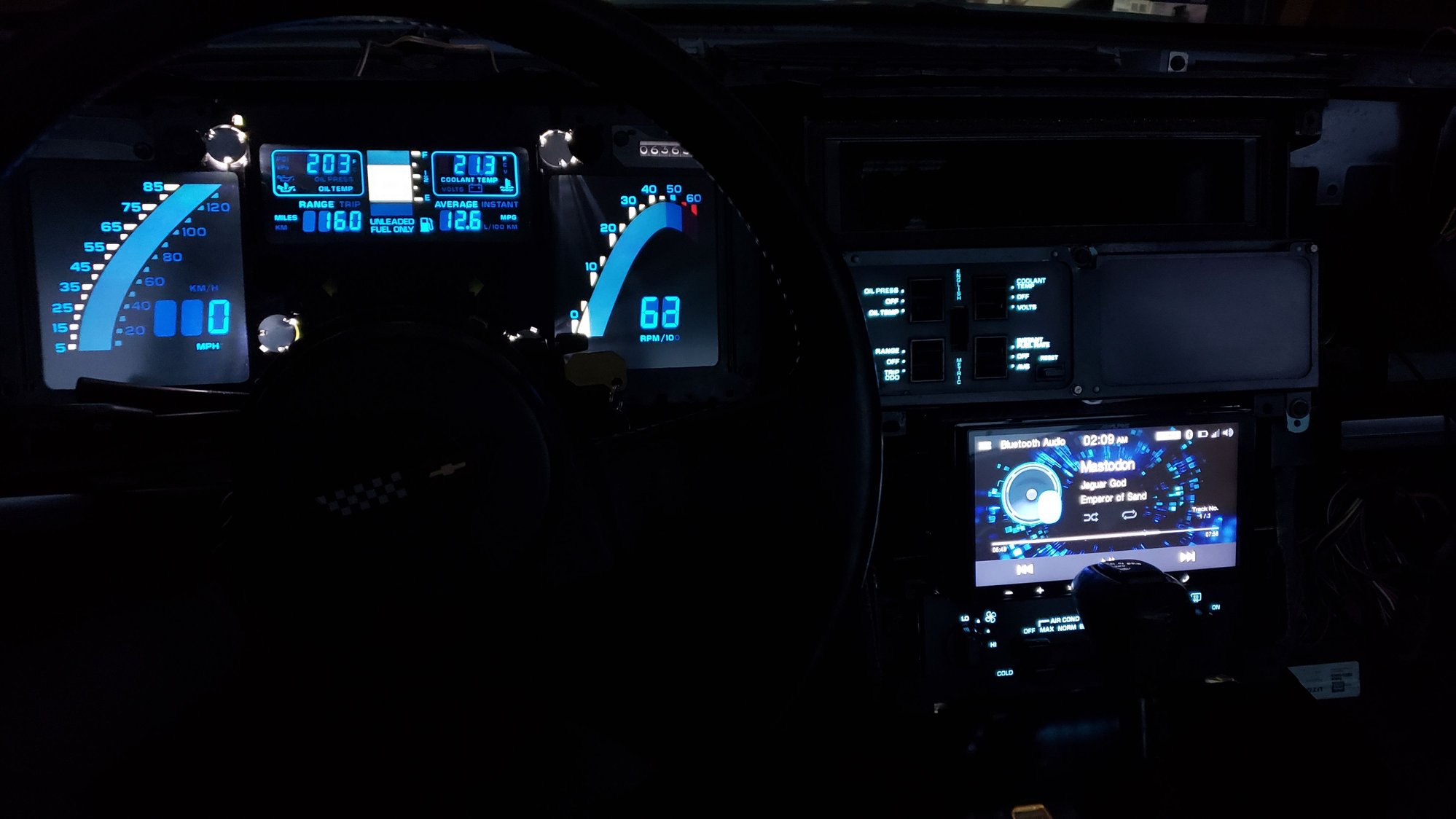

When I yanked the Bose out, I went with Kenwood everything, 6x9s in rear, 6.5" rounds in the doors.

That's a great setup! Gauge cluster looks great, how did you turn it that color? Thanks for the info.
There are colored polarized film overlays that you can insert in the digidash unit to change the color, or you can do various LED upgrades.
My 86 had a red film overlay in the digidash to make all numbers show in red.
