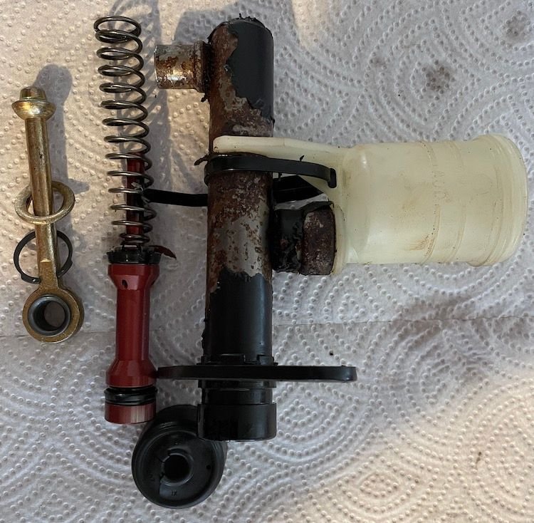

I have the Master out and took it apart to look at what it had. See attached picture. The car has 45K on it and I don't believe this is a GM part as I don't think they would have used a ty-wrap to hold on the reservoir.

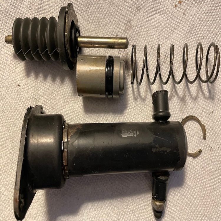

The slave is out. The piston is much bigger in diameter than the new one, but it didn't look like it had been leaking. There was quite a bit of black clutch dust around the piston on the outbound side of the piston. It is easy to see how that gets inside with movement. The original clutch line from master to slave is SS braided line so I am not planning on replacing that even though I have a new one. It looks like it is bent and formed for a better fit than the aftermarket one. What did you guys do?
Believe it or not that is actually the original GM master, which does indeed have a zip tie wrap holding the reservoir on. My '89 has the OEM one and it looks the same. Yours has been leaking a lot of fluid to remove all that black paint, probably from the gasket at the bottom of the reservoir by the look of it.

Thanks for the reply. I would agree or maybe it is just spillage from refills, I don't know. It looked that way when I bought the car almost 2 years ago. I wasn't having clutch problems, as I kept an eye on the fluid level, but you are most likely correct. I have had to add some fluid over the time I have owned it. Looking at the slave I didn't see any evidence of leakage from the slave piston into the bell housing. That was what I was most worried about. I am just doing preventative maintenance as I don't want to have the clutch/tranny done over$$$$$

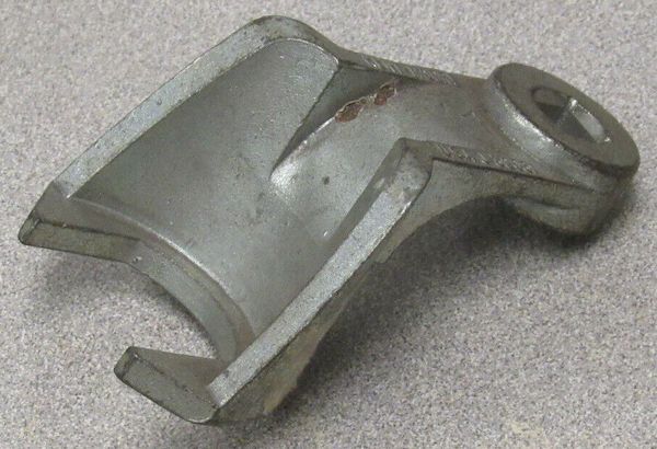

Thanks for the tip. I don't have welding capabilities, so I bought an M20X1.5, allen head plug which I hope is the right size. I should have the J 39081 Solenoid wrench tomorrow so I can remove the CAGS. With that gone I should be able to put the new slave cylinder in without a problem.
Special tool as referenced above.

The tool is exactly what you need if you have to remove the CAGS. You will need a breaker bar to get it loose then it easily unscrews. If you are going to buy a plug, M20X1.5 is the correct size, but it will tighten right into the tranny if it doesn't have a flange on so it can be tightened down like the plug next to it. The slave goes it tomorrow.
