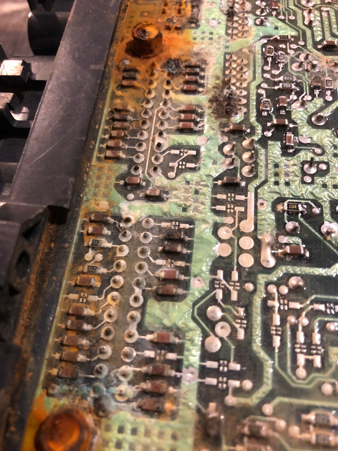

to the OP, my 1990 ecu was showing signs of issues.
the ecu is used across many platforms while the chip inside is specific to the vehicle.
it could be the chip in your factory ecu. it could be the ecu.
that ebay ecu will work fine in your 1985 vette, or any of the other cars if u have them.
myself, i looked up the 1990 ecu and learned that SEVERAL other gm cars shared ghe same one. I picked up THREE at my local junkyard in 25 minutes by cutting the wires and and loosenimg two ten mm bolts (my first time ever going to a junkyard) for $10 each. Swap chip from old suspect ecu to new ecu. works fine. maybe i can sell the other two i have or just keep them for my future cars that i know my habit will result in.
when wvzr1 gives advice, its always good. He is a man of few words as he has said himself.
personally, id rather send an email question to the ebay lister and ask for details on how the ecm warranty process works.
but, if its not really about saving a bit of money just get it from a local provider as other have said. depends on your situation.
no matter which computer u pick up u r likely to have to provide the chip.
good luck with whatever you decide.
your 85 uses the prom chip + calpak deal.
later cars used the memcal deal. in my example, i pulled my memcal from the 1990 ecu and put it into the ecu (same exact ecu) from a buick regal.
if you buy from zone or like , would be worth your time to ask them if the prom and calpak are included (in which case they need to ask verify auto or manual) or are u swapping yours anyways.
good luck with it all. VT.
ps, my factory 1990 ecu looked like this inside.
pss, if zone will let you return the ecm if its not the ecm, that may be a bonus too.
note this is not your 85 ecu. this was a 1990.
