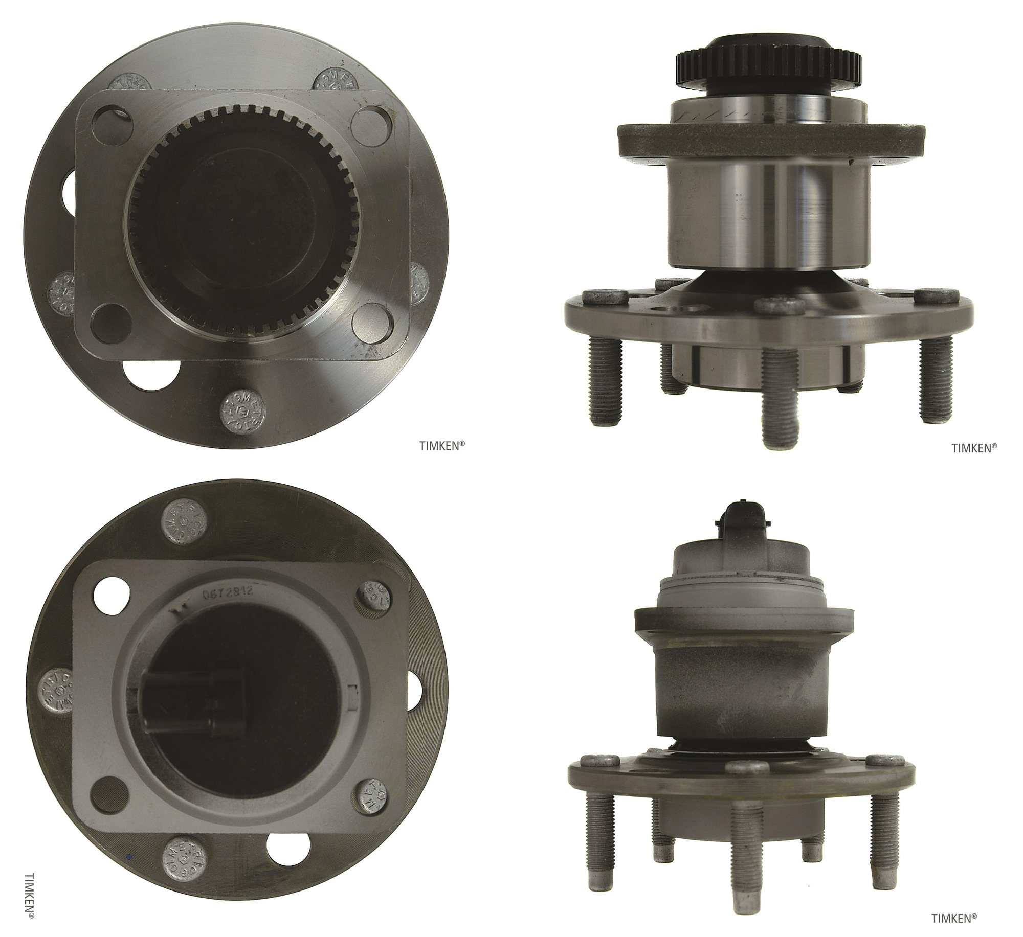

I would imagine it 'might' be somewhat challenging to use that package on early spindles regardless the year, use on '88+ I'd think certainly less challenging. If a person with an '88 - '90 were serious I'd think it might make good sense to just use '91+ spindles for the conversion. I'd think '91+ spindles at this point should be quite inexpensive and easy finds.
What X-Tracker hub are they actually using for the kits?
Once a person reviews the instructions it's much easier to absorb the requirements for an install. The X-Tracker Hub is actually a 'rear hub' and adapters to use on the fronts. '88+ there's no issues. Would Detroit Speed sell you a pair of the adapters separately? Actually early might be very straight forward bearing/adapter to spindle.
https://www.detroitspeed.com/img/pro...pter%20Kit.pdf
I don't think 'lazy' is a proper #tag to hang on DS - the 2 applications they mention are direct bolt-on. Stretch of the install to 'other than' might imply some liabilities.
Why?
1984-1990 use the same front wheel bearing hub.
Did the bolt pattern on the spindle change from 90 to 91? I think not.
At least the hub pilote diameter is the same. Hub bolt circle 4.0 in vs 3.9 in is probalby conversion from metric. 100 mm = 3.937 in.
I also measured the relation on the bolt rectangle from pictures of each hub, and they are at least very close.
I tried to measue the offset compared to diameter in pictures, and did not see any obvious differance,
I think the hub dimensions are exaclty the same and the only differance is a different ABS-sensor.
1991-1996 hub dimensions:
http://www.hdeautoparts.com/782-chev...ing-unit-.html
Flange Diameter:5.79 In.
Bolt Circle Diameter:4.75 In.
Wheel Pilot Diameter:2.76 In.
Brake Pilot Diameter:2.78 In.
Flange Offset:2.72 In.
Hub Pilot Diameter:2.83 In.
Hub Bolt Circle Diameter:3.9 In.
Bolt Size:M12X1.5
Bolt Quantity:5
Bolt Hole MET:11.94
Bolt Hole qty:4
Flange Shape:RECTANGULAR
ABS Sensor:Has ABS with Integral Sensor
Number of Splines: N/A
1984-1990 hub dimensions:
http://www.hdeautoparts.com/787-chev...ring-unit.html
Flange Diameter:5.78 In.
Hub Bolt Circle Diameter:4 In.
Bolt Size:M12X1.5
Bolt Quantity:5
Bolt Hole MET:11.94
Bolt Hole qty:4
ABS Sensor:Has ABS with Tone Ring Sensor
Number of Splines:N/A

In addition to also using the 91 spindle, you will need to modify the abs connector.
They are using C5 hubs and at one point and time, you could buy the adapters themselves and source the hubs. Now they are shipped and bolted ready to be installed right out of the box.
Lazy works, they don't want to be bothered possibly expanding their market with a little bit of research. But more power to them. They could have come out with a rear kit as well, but somebody else has beaten them to that punch. Granted the market for people willing to spend 1,000 for a package for quality front bearings is small in the C4 market, most of the people who want to run this kit race.

Hello fellow Vette heads, I figured I would do an update because I FINALLY got around to doing the bearing mod on my 84. COVID kinda threw a wrench into things over here hence the long delay in update, but I won't bore yall with that story. ANYWAYS
I purchased the Detroit Speed X tracker kit and it does indeed bolt right up to my 84 knuckles. The 84 was the last year without ABS so unlike the newer C4 Corvettes the back part of the spindle is solid so I had to cut the wires off the ABS sensor, with no place to go it would have rubbed on the backside of the hub. At this point I have to assume the reason that its listed as not working for the earlier cars is because of the change of ABS sensor. I have a track day planned in April to do a systems test on the car. Its at Road America, so it should be a good test as to how much hell the new bearings can take. If I find any issues I I will update, but at the moment it looks like I'm GTG.
Old Feb 13, 2022 | 04:28 PM
JoBy's Avatar
JoBy
Posts: 2,149
Likes: 303
From: Timra, Sweden
As suspected the change in ABS sensor design is the reson.
1984-1985 - Not an issue as there is no ABS on these cars. Just cut the wires off like you did.
1986-1987 - Probably makes it difficult to keep ABS. Probably both sensor signal and frequency has changed. If not then you could use a hole saw thru the bottom of the spindle to get the connector out.
1988-1990 - Same problem as 1986-1987.
1991-1996 - Bolt on.
