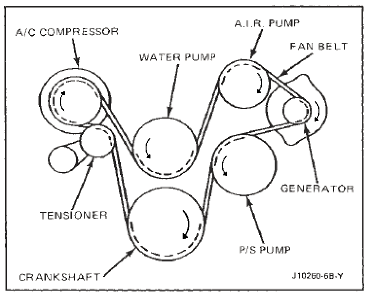

As I am in removing everything in sight to fix the fuel lines, I have decided to remove the A/C as well - really do not use it and i could take it out to make some space. does anyone know if there is anything special to consider with the belt fitment/direction - I would really like to remove everything from that area -and not have a belt delete pulley if possible I thought I read somewhere that was a thing but for some reason I cannot find the images or thread again

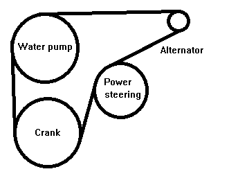

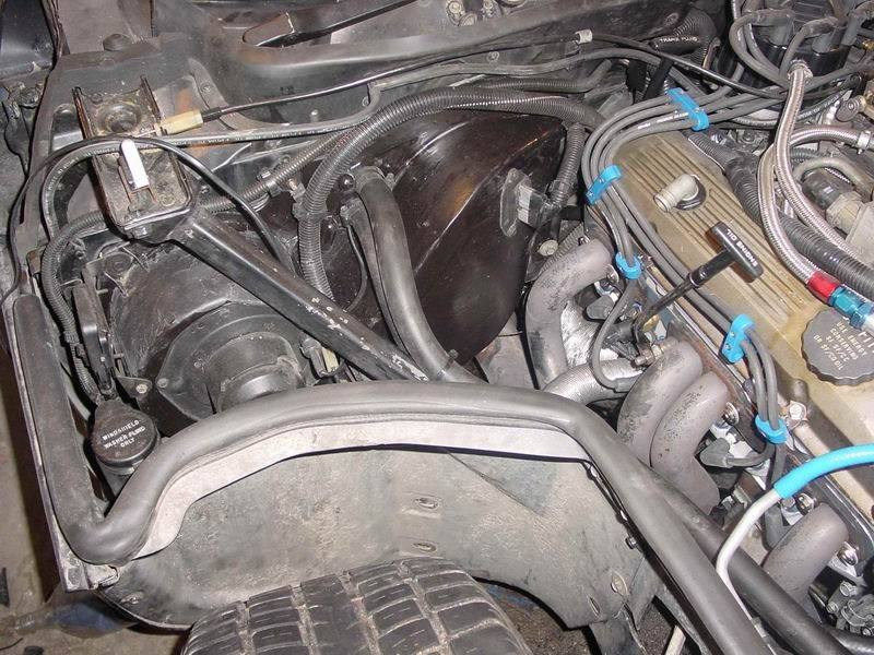

What year?
There are everal options.

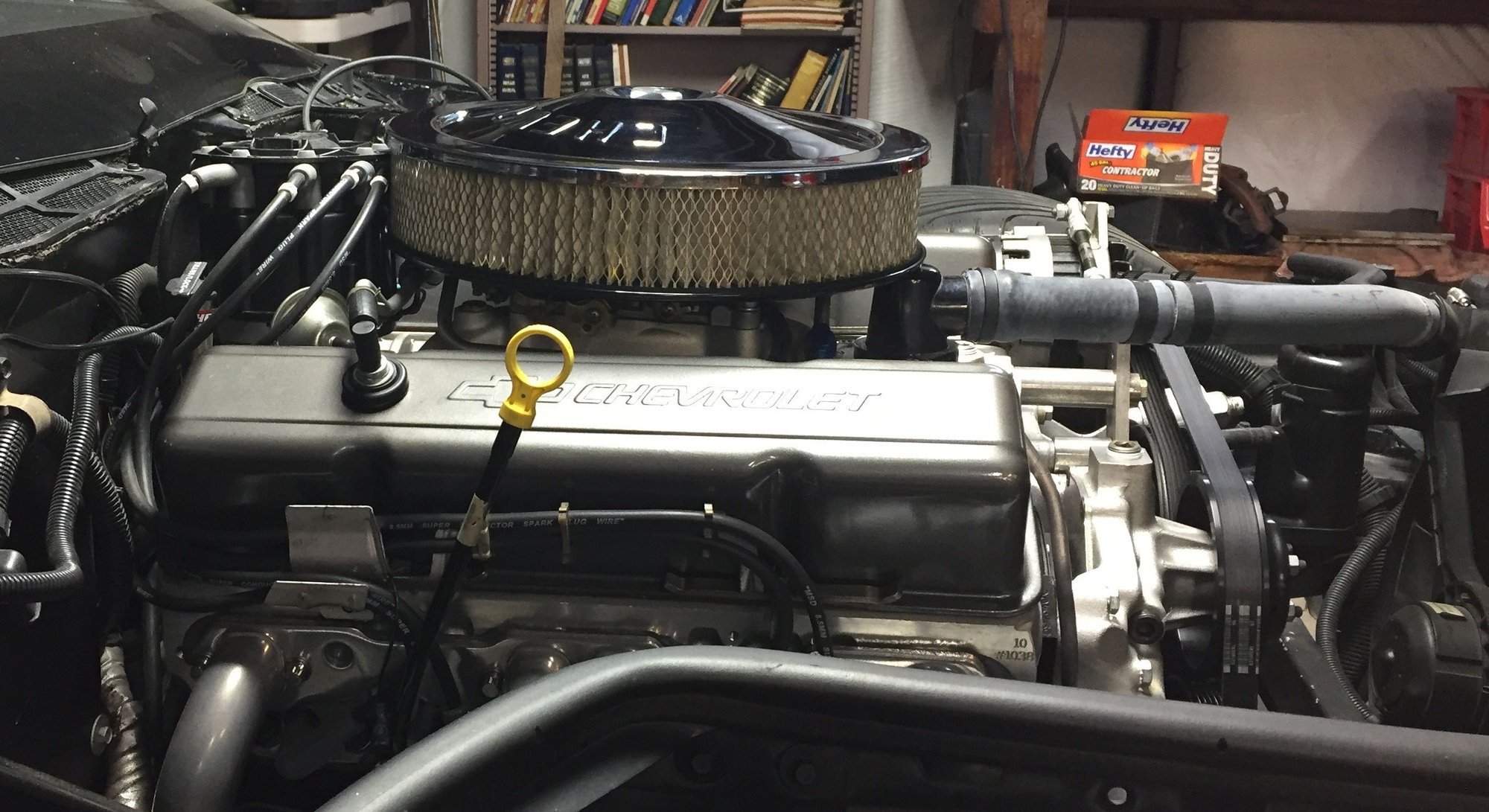

For many years I have used a standard rotation water pump and only four pulleys. Crank, Back side of power steering pump, alternator and water pump.
I use a turnbuckle on the top alternator mount for old style belt tensioning.

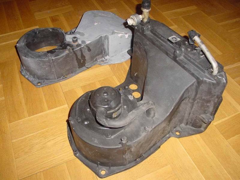

After removing A/C pump I also removed the core and modified the fan housing.
https://www.joby.se/corvette/mods/20...3_fan_housing/

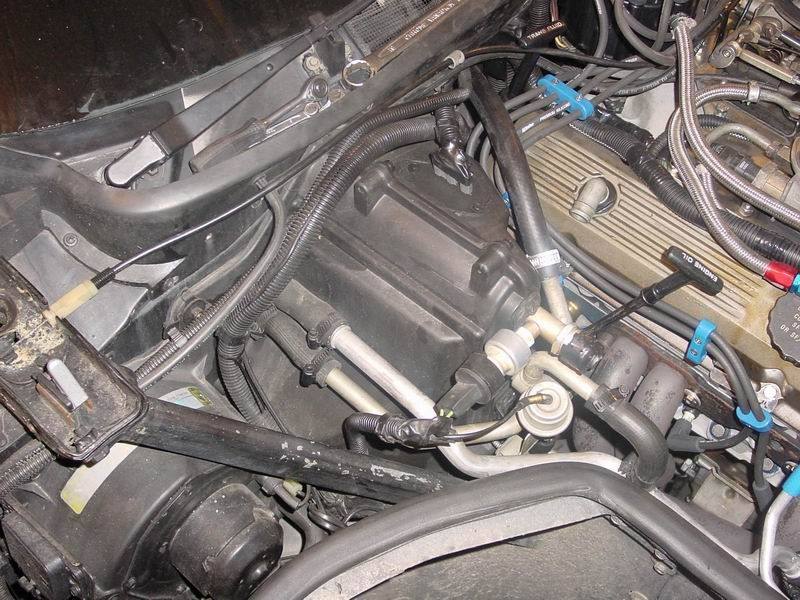

'85. - did you change the water pump or leave it stock? - -also are those braided fuel lines upper right of the photo? - that's a little house cleaning -
https://www.summitracing.com/parts/s...02?seid=srese1
can you use something like this for the alternator?
I replaced the water pump with a short standard rotation and reused the stock pulley. No problem for years.
Those are old pictures. I have an 84 and modified the stock alternator/power steering reservoar bracket to use a turnbuckle.

I removed my AC since it has never worked. I'd just bought a new reverse rotation waterpump so I routed the belt slightly differently and bought a shorter belt. I have the smog delete pulley still. I'll change the waterpump soon enough and get rid of the belt tensioner and smog pulley next.

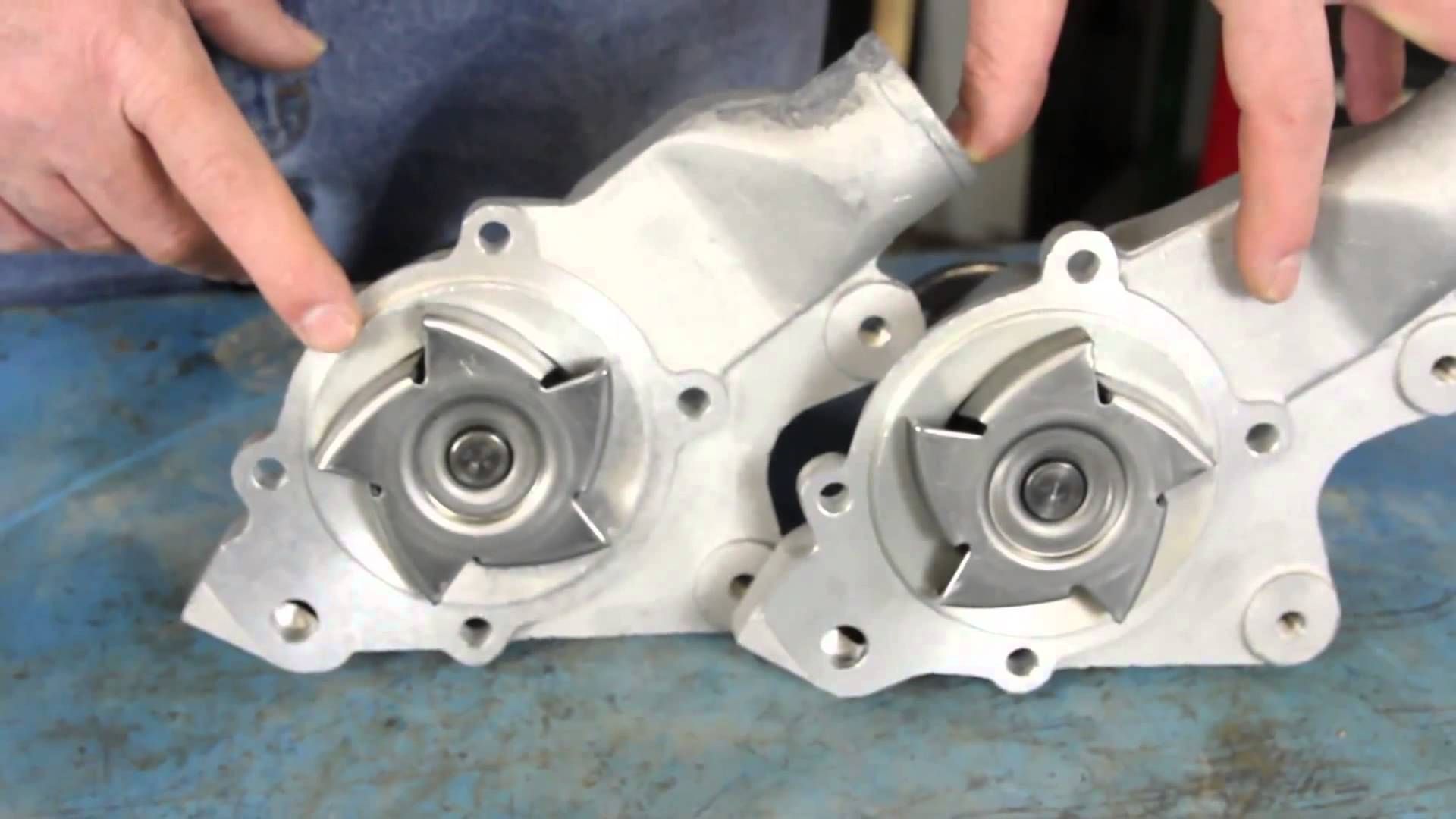

reverse rotation/standard rotation crank rotates clockwise correct ? (looking at the engine) - tensioner gone or still in place? - sorry slower than usual brain day for me
Old Apr 23, 2021 | 03:57 PM
sb66's Avatar
sb66
Joined: Jun 2016
Posts: 1,058
Likes: 108
From: Ohio
maybe the question should be when we say standard rotation are we saying stock which if i understand correctly is counter clock wise? - no need to change the pump after removing everything even if the direction of the pump changes?
Old Apr 23, 2021 | 07:06 PM
JoBy's Avatar
JoBy
Posts: 2,150
Likes: 304
From: Timra, Sweden
Standard rotation is when the water pump is turning the same way as the crank. Like with old V-belts.
On the TPI Corvette the pump is driven from the back side of the multi rib belt so it is rotating in reverse compared to the crank.
The only differance to the waterpump is that the impeller is mirrored.

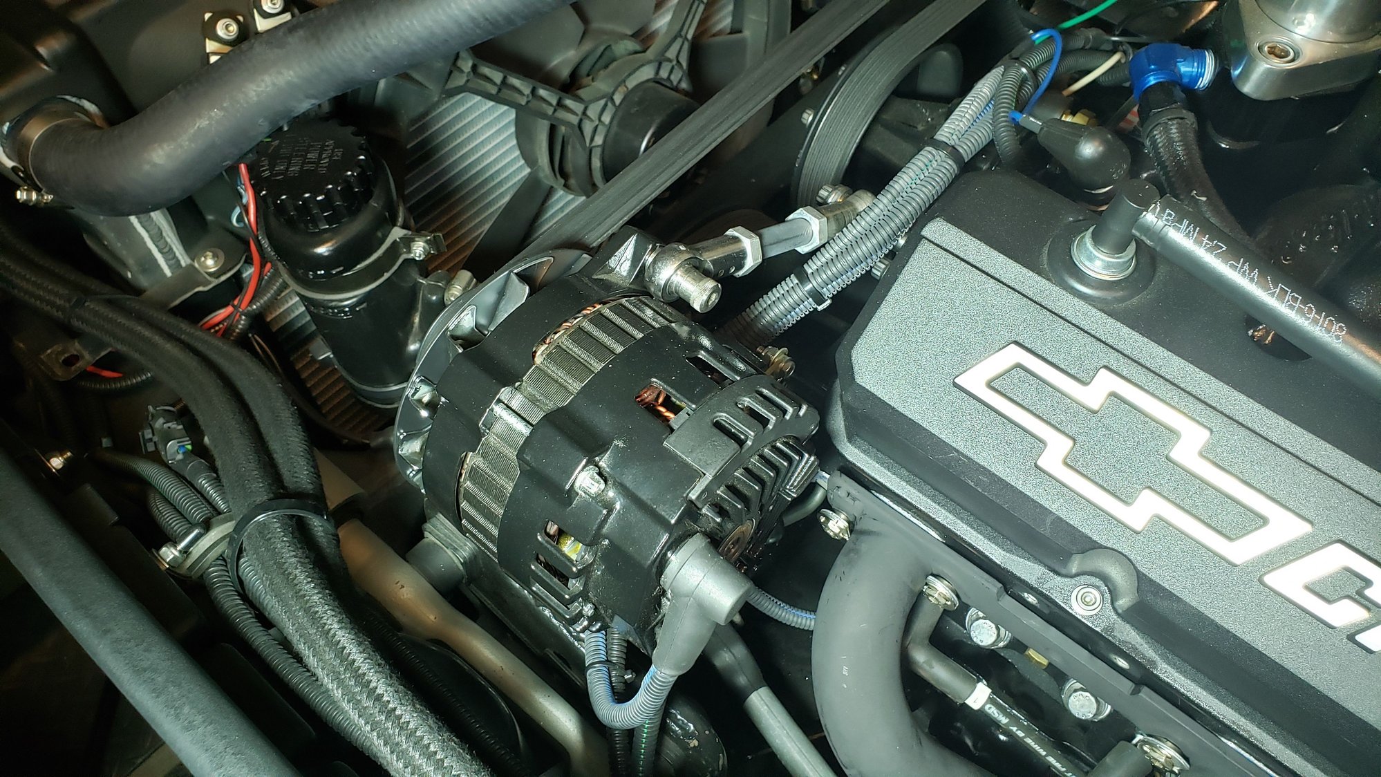

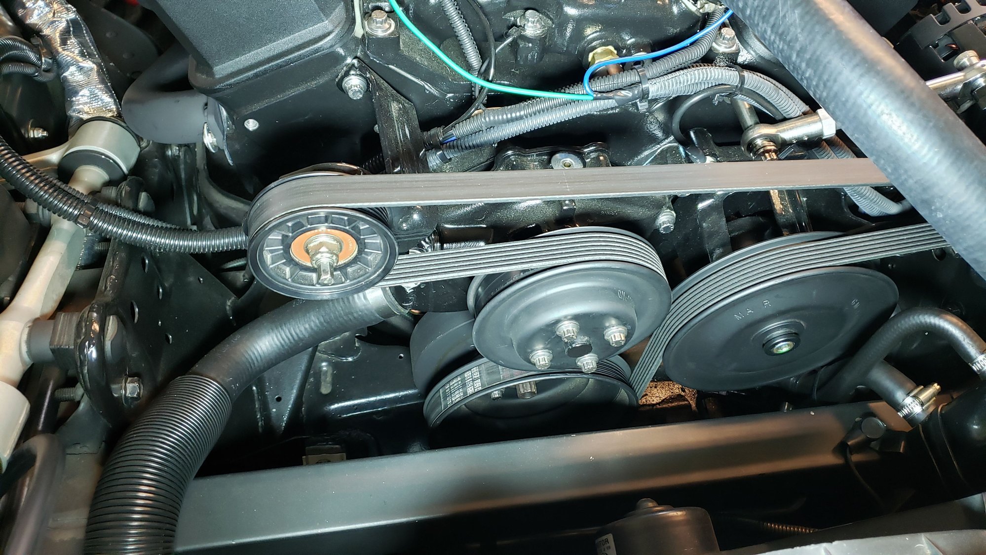

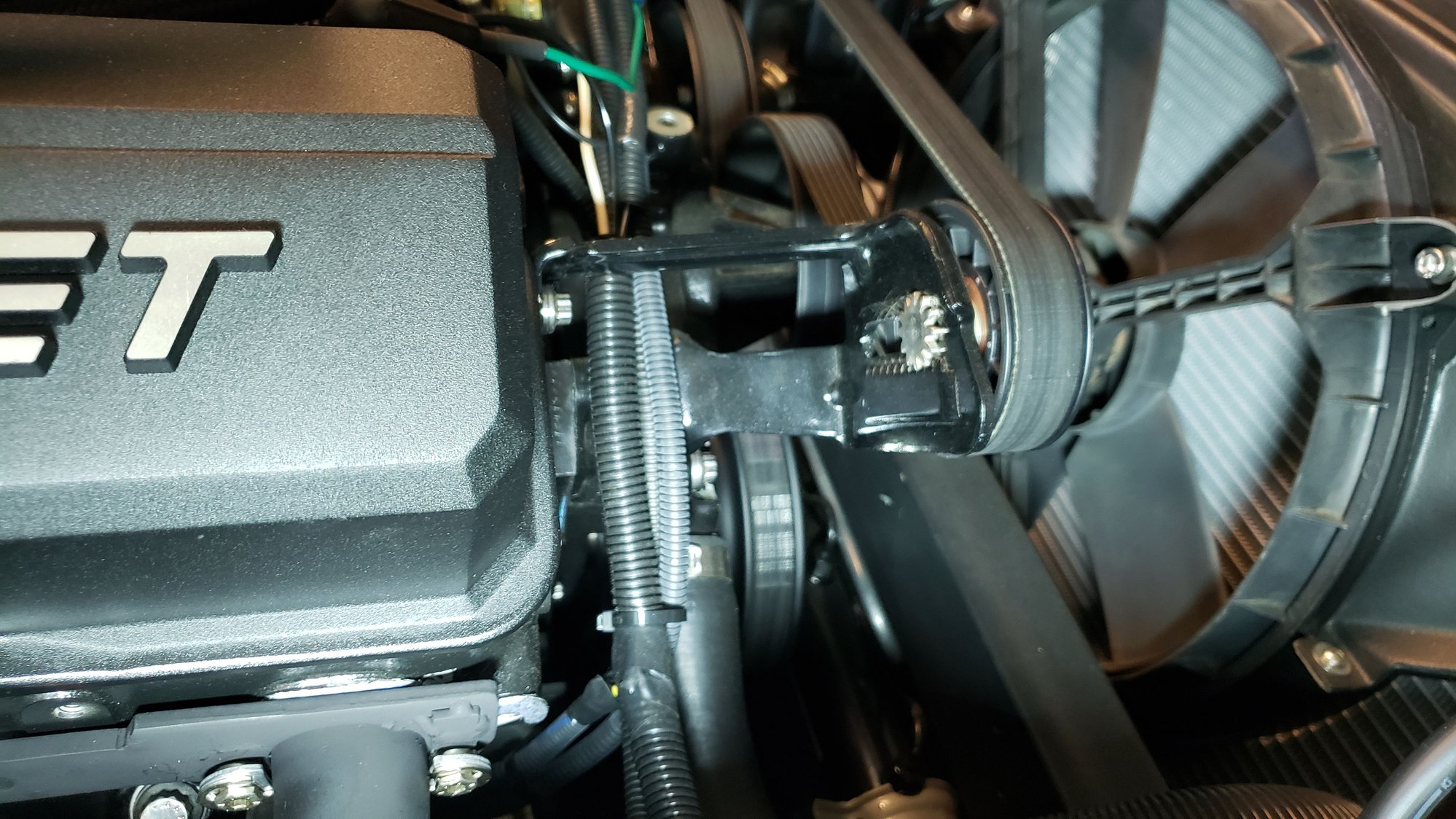

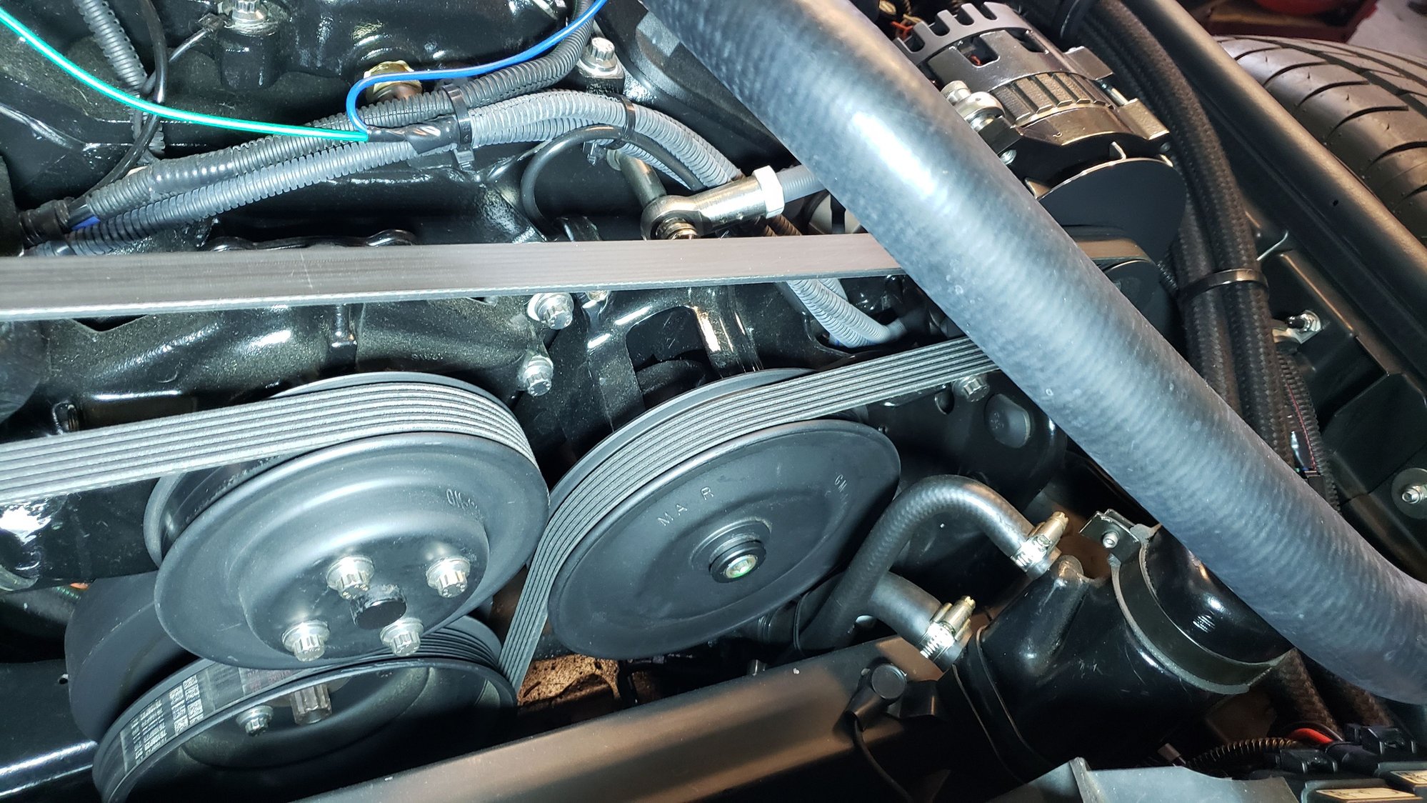

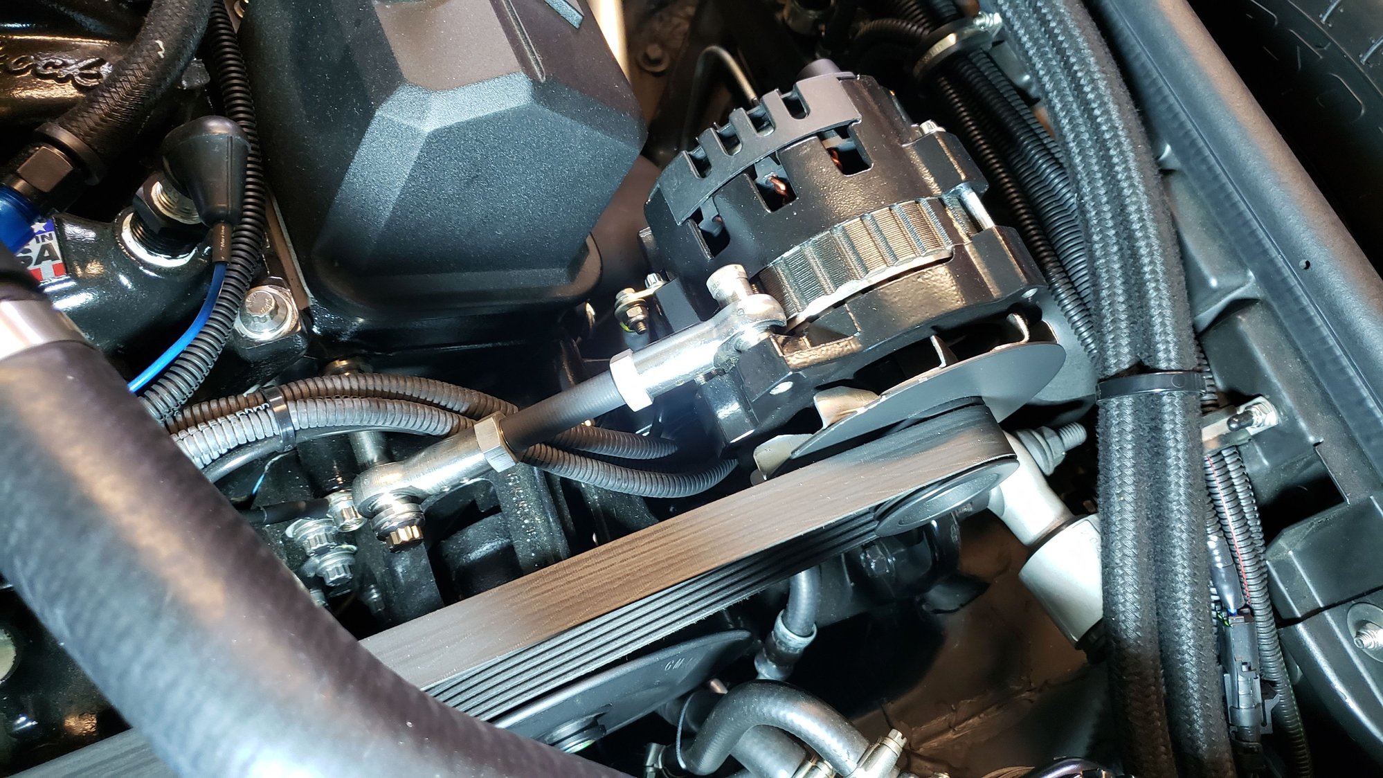

My 383 i built for my 88 has no ac or air pump
I can post pics of my setup with part numbers if you want, but basically I have-
-tuff stuff black 1 wire alternator. Fits the stock lower bracket that was original to car. Upper is a adjustable rod I made that goes to head.
- stock type aluminum waterpump for an 88, and original pulley
- stock type p/s pump with original pulley
- on pass side i have a Mercruiser belt tensioner.. adjusts easy as hell. You can change/adjust belt in seconds.
- stock crank.pulley
I'm a boat guy and after seeing this setup for 20 years now I did it to mine. Works great. No belt flap or any other issues.

Old Apr 24, 2021 | 03:08 PM
