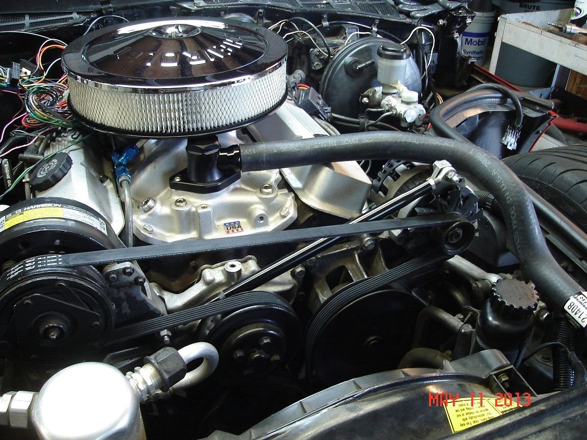

is this possible? could even eliminate the tensioner and put a adjuster rod on the alternator - maybe - this way I would not have to change the water pump yet - I am going to eliminate the smog stuff since the bearings sound like they may be going - I know they have delete kits But i was seeing if this may work to avoid adding anything else at the moment ?
thanks delete altogether

excellent - so you used a longer adjuster in front of the alternator - what did you connect that to? you also used a different hose and re-routed it? removed tensioner? (sorry so many questions)
