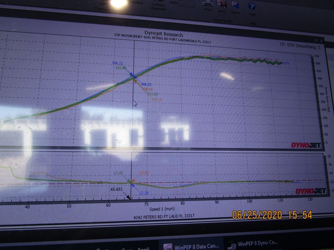

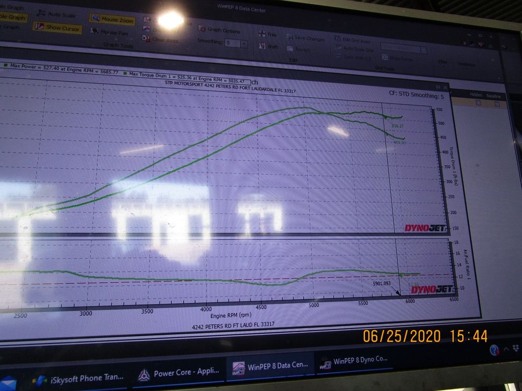

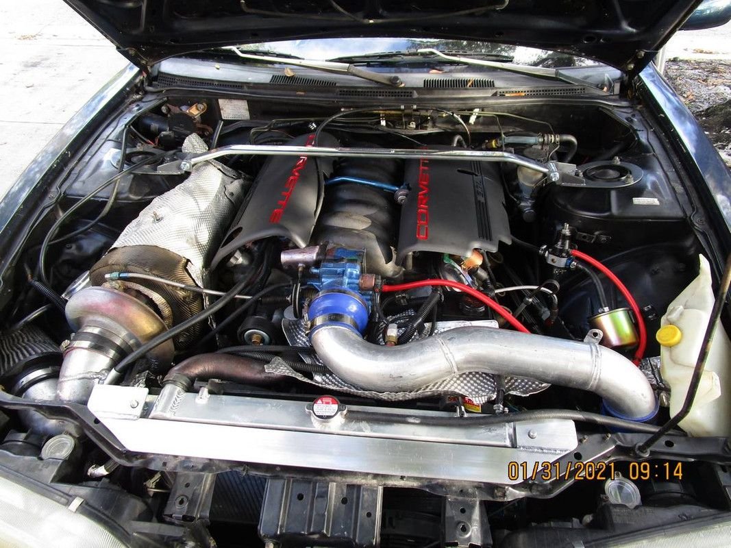

My first LS engine as it sits more or less today
Built from many scrapyard parts, $40 of exhaust tube for the turbo, a free used engine. But does it perform well?
Chassis dyno'd it last year to see where I was at, a benchmark if you will
I'd been driving it at about 490rwhp for almost two years at that point. Enough experience, and with these dyno results I could tell the engine would handle more easily with no issue.
