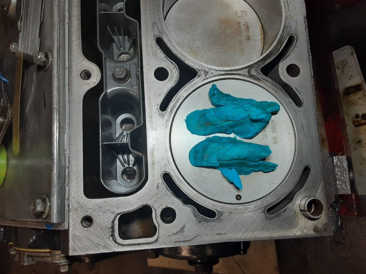

So I had a thought today. I wanted to check piston to valve clearance before I sent my heads off to be ported. That way I would know how much could be milled off and not worry about it. So there are several different ways to do this. I prefer the Play-dough method. This requires me to steal my daughters Play-dough and put it on the piston. Bolt the head on with an old head gasket. Then put on two rocker arms with push rods and then turn the motor over a few times. Then measure how far it dented the Play-dough. The issue with this is that sometimes the lifter will collapse. They sell "test" springs and solid lifters bla bla bla. I'm not spending money on more tools so I made my own solid lifter today.

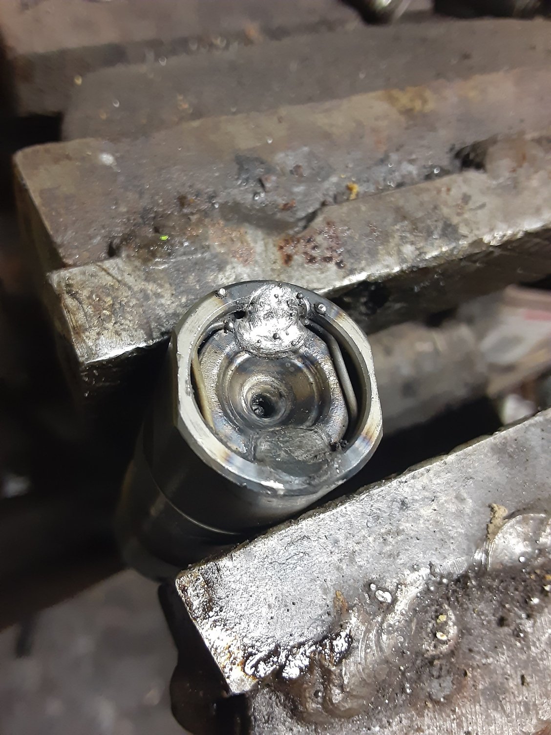

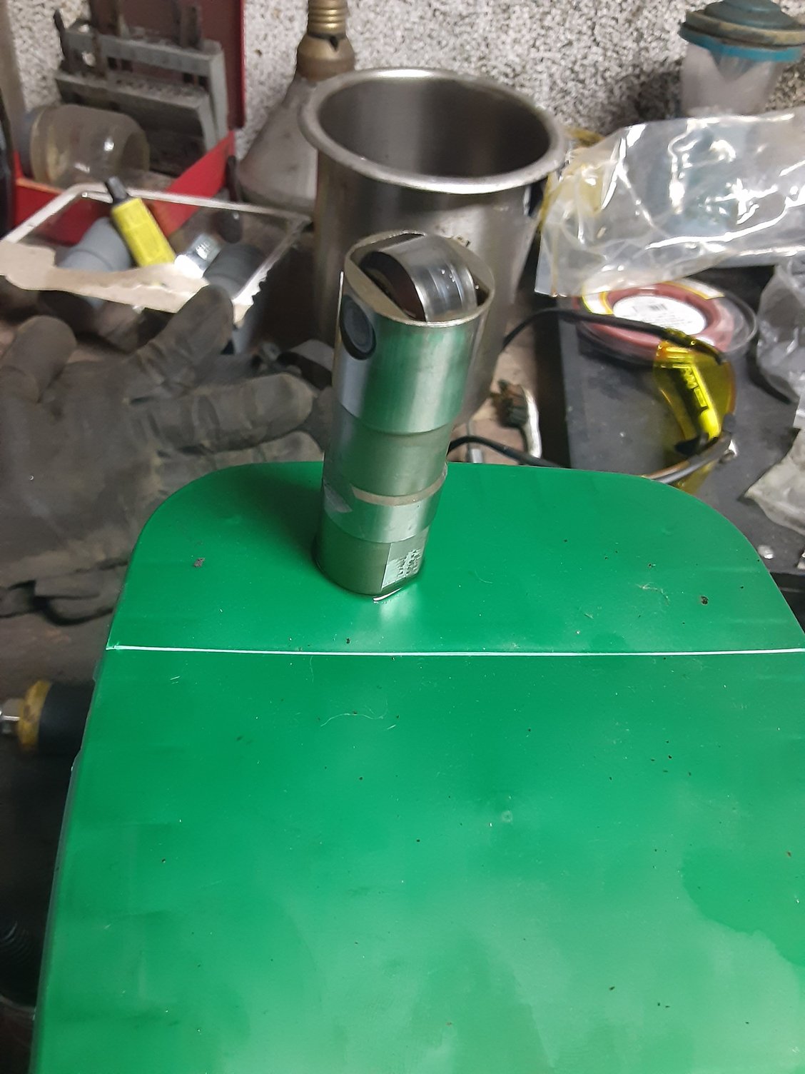

So I dug through my bin of random lifters and found two promising candidates. They didn't look collapsed and not too rusted.
So these will serve two purposes. I can use them to find the piston to valve clearance with the old factory springs that are on the head. And I can use them when I get the heads back and need to check push rod length. Or maybe I'll just weld 14 more and have a solid roller cam.

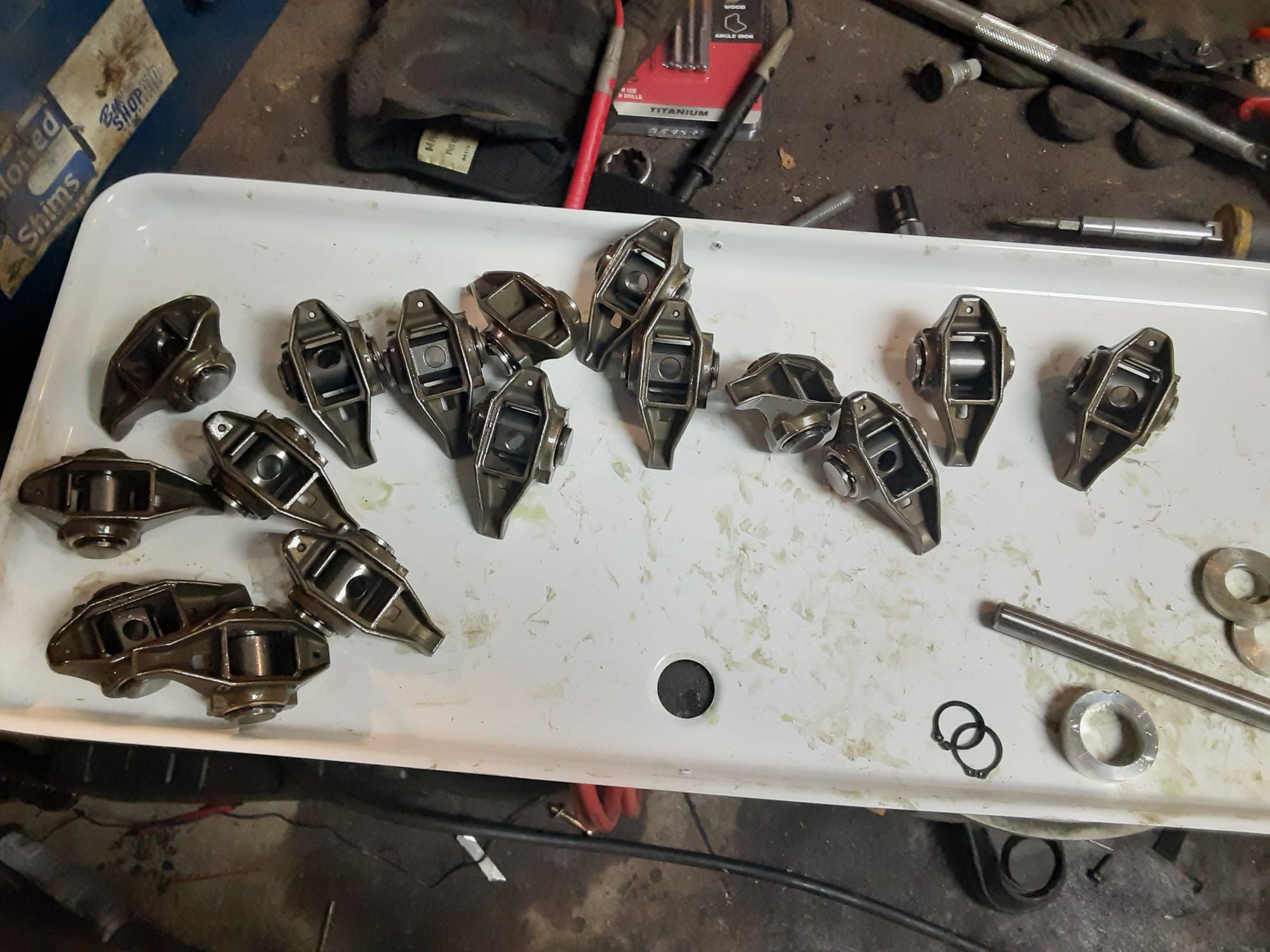

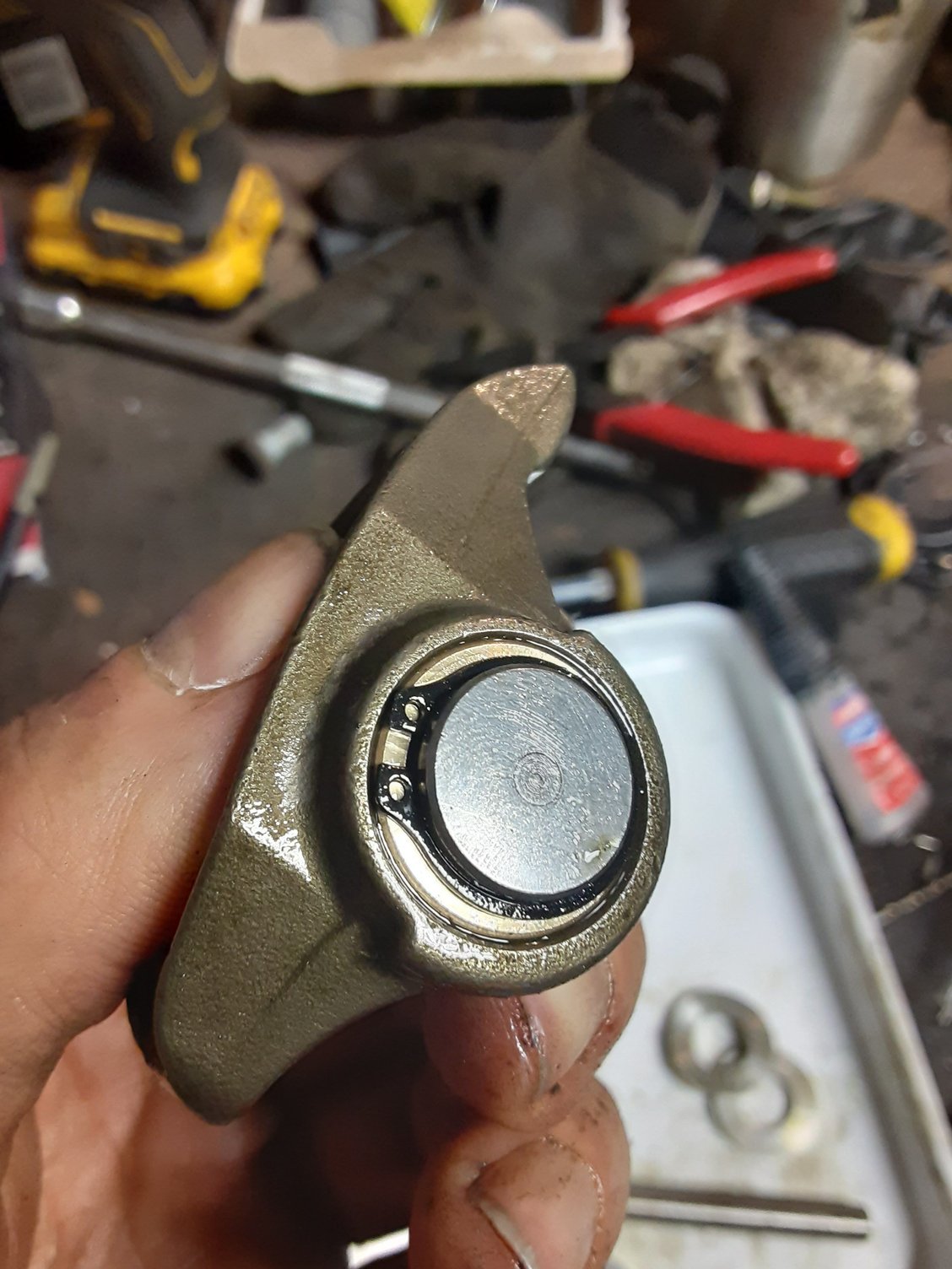

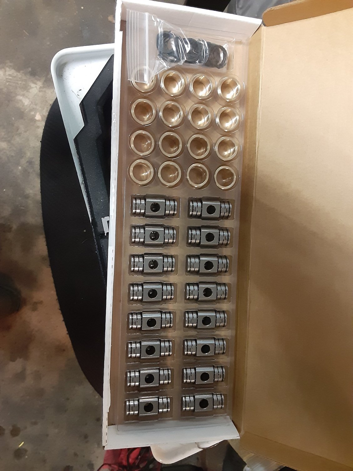

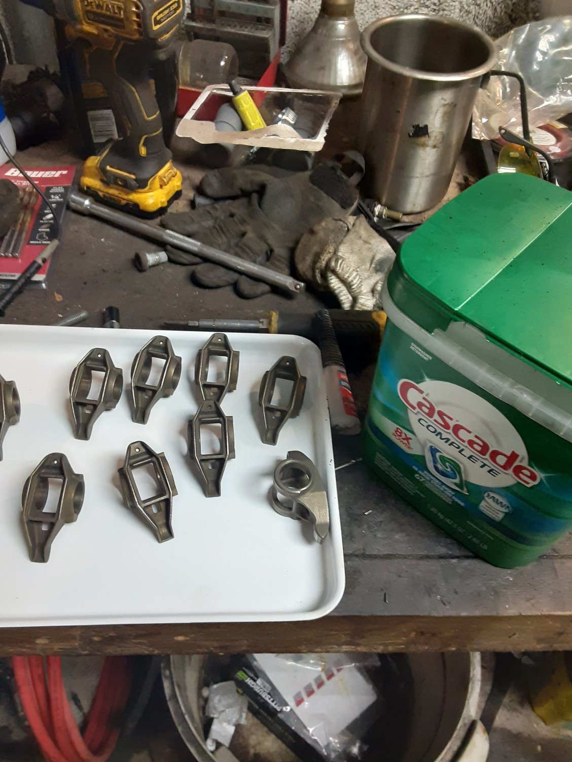

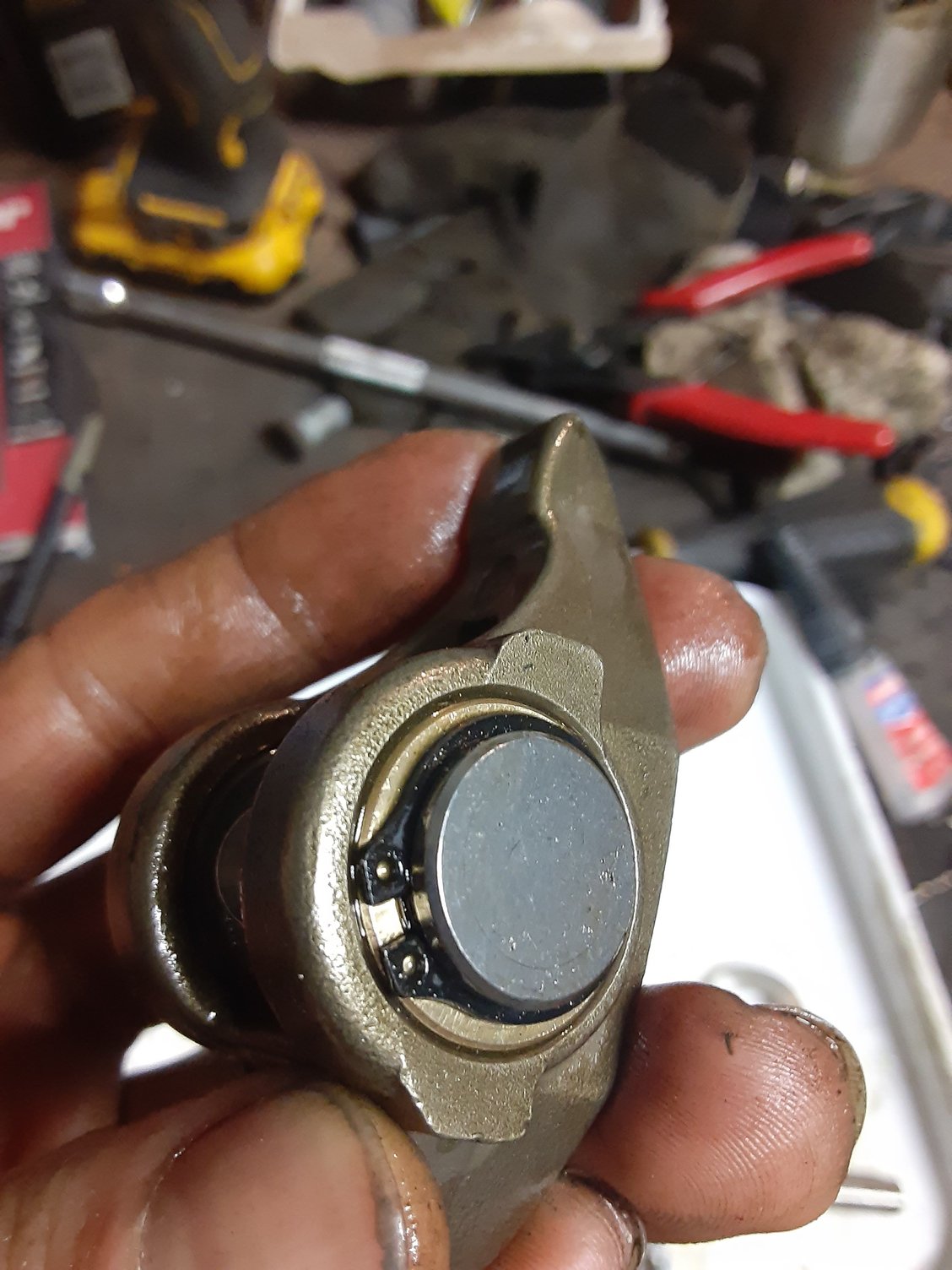

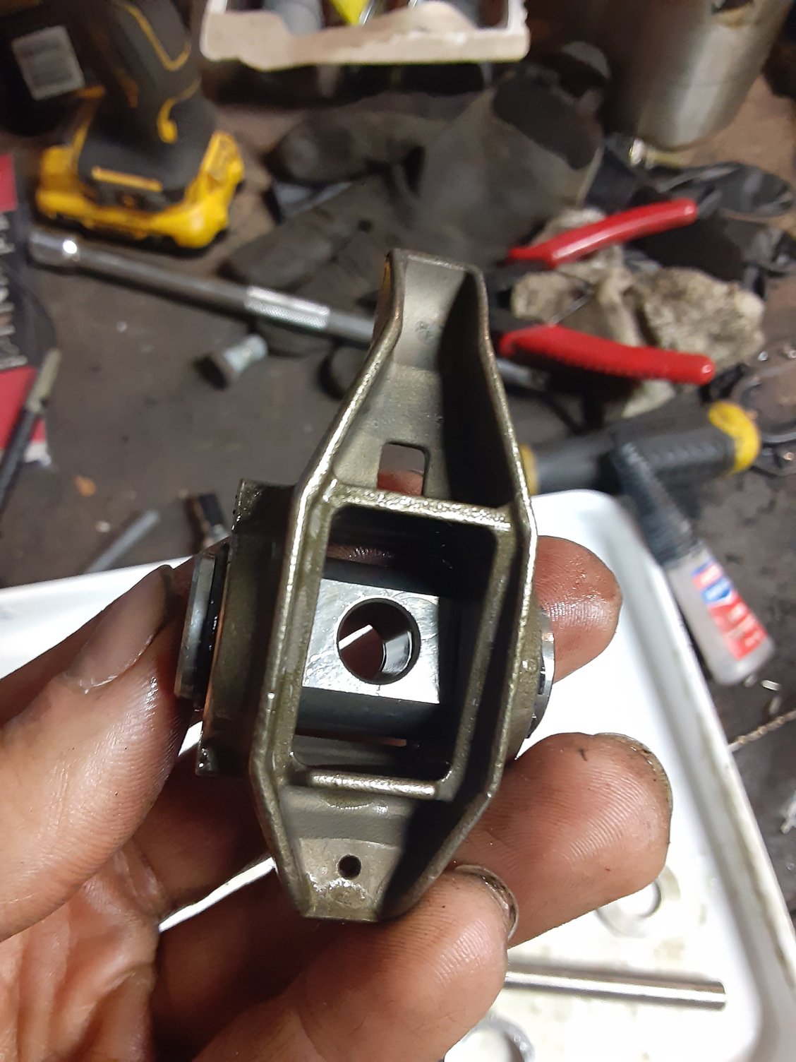

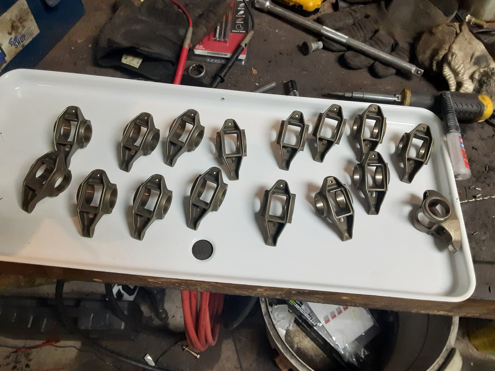

So today in the mail I got a new set of LS7 lifters and a Summit Racing rocker trunion upgrade kit. I know I said that I was going to put in old lifters. But the LS7 lifter from Summit were cheap and the old ones I had were pretty rough. Most of them had over 250k miles on them. So I pulled the old lifters out and put the new ones in. I had pulled a set of rockers off of an Impala SS last year. They only had about 50k miles on them. So I ran them through my super high end Cascade Mineral Spirits parts washer.
I had already pressed the old bearings out the other day. So this is what I have to work with.
The Summit kit was really well packaged. I felt like I was opening a case full of jewels.
So 30 minuets later I had them all done.
The Summit install tool works well and I feel it was worth the $15. But you could do this without it if you have a collection of sockets.

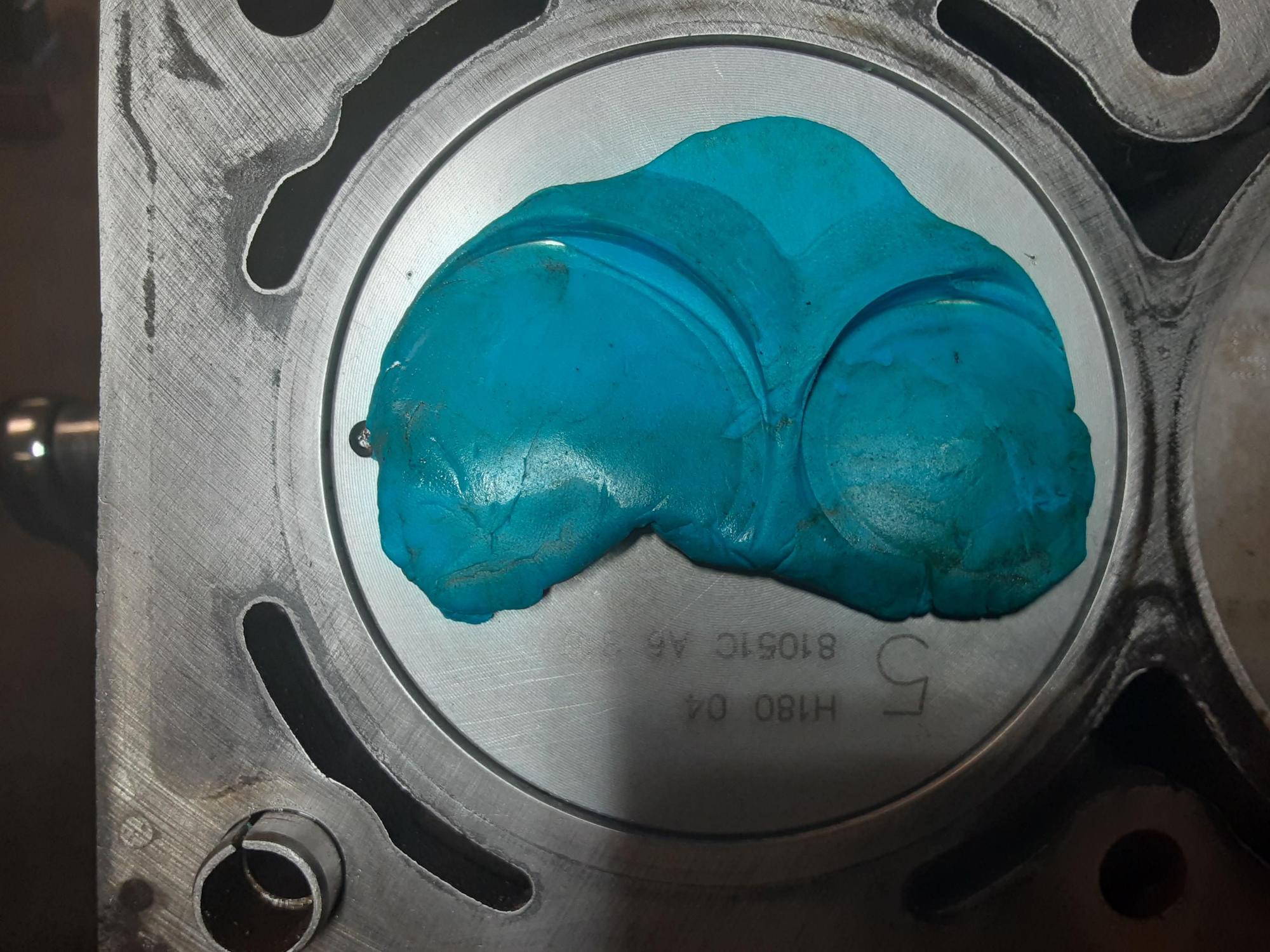

I bolted one of those greasy 799 heads with an old head gasket to my motor. I threw in my two solid lifters and a couple old push rods.
Best I can tell I have .200" clearance on the exhaust valve and about .230" on the intake with the stock 799 heads. At least that's what the blue calibrated Playdough has told me. From what I have read if I have at least .100" I'm good to go. So this should mean that I have lots of room with my cam and pistons to have these heads milled anyway I want.
So if I send the set of 799 heads that I pulled last weekend off to be ported they will finish with a 69cc chamber. I think I'll have them mill that down to a 65cc. That will give me a 10.8:1 static compression ratio and a 8.46:1 dynamic. I think that will run on 93 octane and be an awesome street car. I'm not sure how much nitrous I can get away with having that much compression. I'll start with a 150 shot and see what happens. If it blows up then I guess I went too far. Then I'll have to swap the LS6 back in. I guess if that's my worst case scenario then I'm in a good spot.
I do want to mention that I haven't 100% made up my mind that I'm going to have the heads ported. It's a lot of money for 30-40 hp. And I do HATE parts being in machine shop hell. So I'm toying with the idea. But these heads very well may just get bolted on as it. Well I might clean them first.

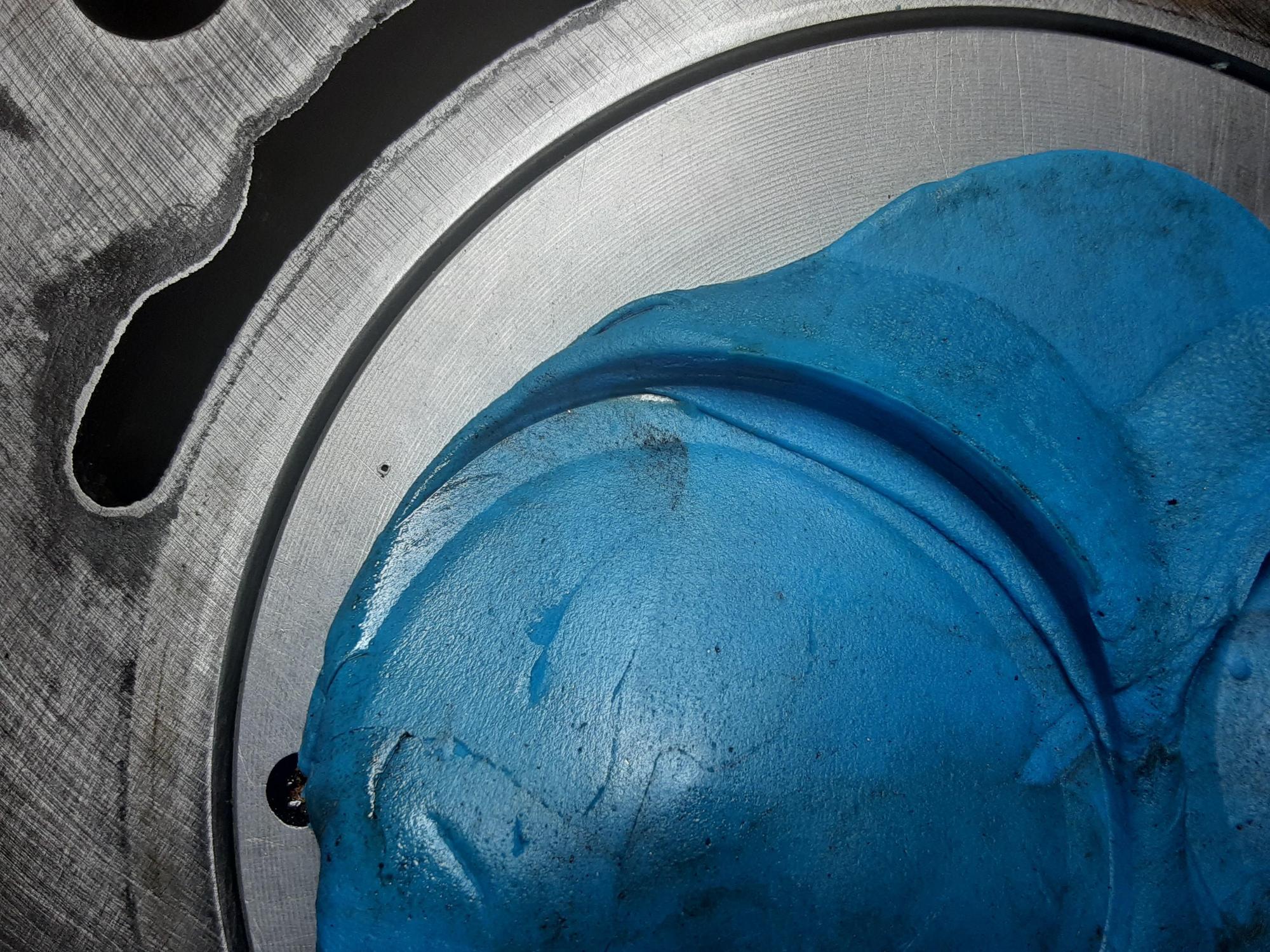

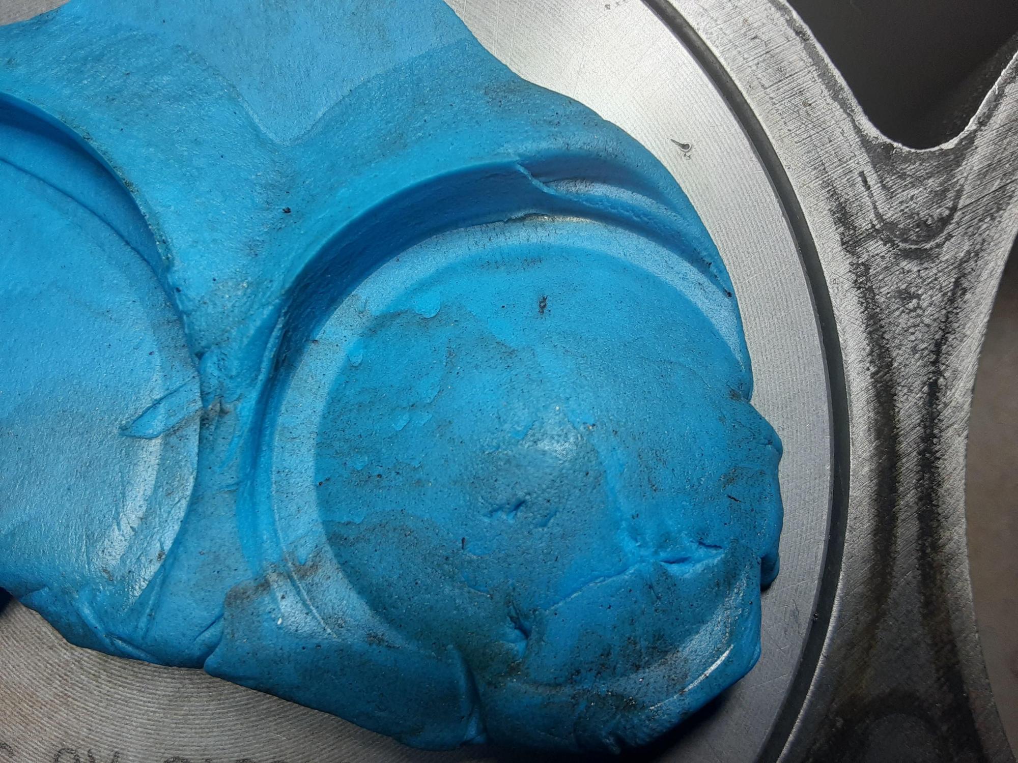

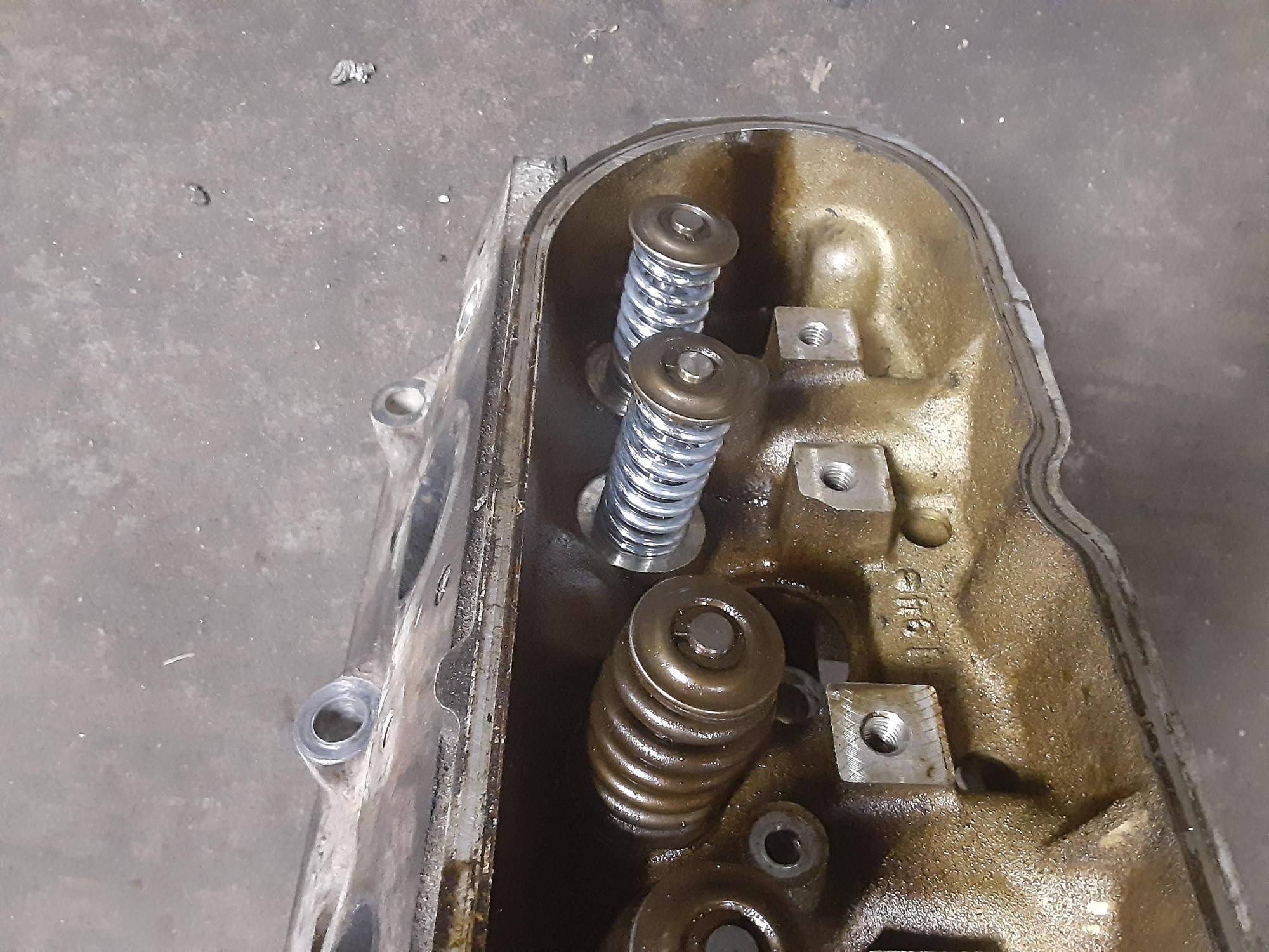

Ok so I have a problem. I need some advice. After I made my last post I was cleaning up and I noticed that both of my welded lifters had broken the tack welds that I put on. The stock spring pressure was too much and broke the weld. This collapsed the lifter. So my readings were way off. No big deal. I made a trip to Tractor Supply and got a two pack of springs that fit in the place of the stock valve springs. Then I plopped my Play-dough back on and turned it over. This is what I saw.
So now I'm left with a dilemma. The only reason I went with this cam is because the tech at Summit told me it would work. I thought about advancing or retarding the timing. But if I understand that right it will act like a see saw. It will give less clearance to one valve and more to the other. The only option I'm seeing is to get a different cam. What do you guys think?

I feel like something was off on your 2nd attempt at checking PTV...
I've ran much larger cams than that one and didn't have anywhere close to issues with PTV.
Are you sure that the stock length pushrods were the correct length for you?
Why not just use stock lifters and calculate preload to rule out possible issues with lifters/pushrods?

I'm not sure that the pushrod is right. This is what I'm going to check when I get home. To be honest I'm not sure how to calculate preload on an LS7 lifter. I know they have .200" total "squish" but in this situation I don't know how that translates into PTVC. So what I'm going to try is to use my welded lifters and then a push rod length checker. Put the cam on base circle and set the checker to zero lash. Then try again. Hopefully everything will be fine. But like I said I have low expectations. I didn't see that valve move at all with the factory pushrod. But who knows, I may have just missed it.

How much did you mill the heads?
I would use less clay too. Put it on pretty thin, like .150".
From the pic of your welded lifter it looks like the tack welds might be interfering with the pushrod and not letting it sit all the way in the cup. Can you use another lifter and lock the plunger some other way? Like with small washers or something?

As far as I know the heads are stock. I pulled them off a wreaked truck. The pushrods seem to fit all the way into the lifter when I hold the lifter and a pushrod in my hand. But there could be something I'm not seeing. Either way if I'm understanding it right, I should be able to find zero lash with these lifters and a push rod length checker and try it again. If that doesn't work I can try taking a lifter apart. I have a bucket full of them. Also I plan on filling the chamber of the heads with water to get a rough idea on CC size. It won't be exact but it should tell me if there is anything crazy going on.

Ok so I have at least a little figured out. The stock length push rods are in fact too long. So to check this I threw out my welded lifters. Then I took a lifter apart and flipped the internal plunger around backwards. This basically makes a solid lifter. I found a video showing how this works. I put my length checker in there with my new solid lifter and set zero lash. My checker says that I need a pushrod that is 7.324" long. The factory rods are 7.380. I did the clay test again but so far only on the exhaust side and got .180" PTVC. So my piston to valve clearance is good. But this raises a question. Were these heads decked or do Summit cams require shorter pushrods? I pulled the heads off a truck in a junk yard. So anything is possible. I need to figure this out because with stock heads it would put me at 10.9:1 compression. I don't want to go any higher.

Might not hurt to try and measure the chamber volume in the head if you have a piece of scrap plexiglass and a graduated syringe. I think Jegs/Summit sells a kit for $20 as well. I'd highly doubt heads from a completely stock junkyard truck would have had work done to them, but better safe than sorry I suppose.
There's a more in depth way to measure valve clearance with checking springs and a dial indicator if you have the time. Although the playdough method is probably fine as long as you get consistent measurements if you repeat it.

Ok so after annoying the **** out of everyone over on the LS1tech forum and a very long night of tinkering, I think I have this all sorted out. So I was under the impression that when you check piston to valve clearance that you need to use the pushrod that you intend to run in the engine. This is NOT the case. With a solid lifter in the engine and clay on the piston and a light test spring in the head. Use a pushrod length checker set zero lash on the base circle of the cam. Then turn the motor over. Pull the head off and measure your clay. You are NOT taking lifter preload into account when you are checking for PTVC with a solid lifter.
So then I wanted to see what my pushrod length would need to be. So on base circle I set the checker for zero lash. Pulled it out and saw 7.29. LS7 lifter preload is .075 to .100. A factory LS pushrod is 7.385. So 7.29 + .100 = 7.39. So that means that I can use stock pushrods. What I wasn't understanding is why I can't check PTVC with a stock pushrod. I thought the lifter "pumped up" and added to lift. I didn't realize that it doesn't gain that preload distance on the valve when oil pressure filled the lifter
So on to the heads. I was wondering if these old heads had been milled at some point. I found out that the deck thickness from the deck to the bolt face on any of the front facing head bolts should be about 1.625". Mine measure ranging from 1.618 to 1.626. So I am going to guess they have never been milled.
