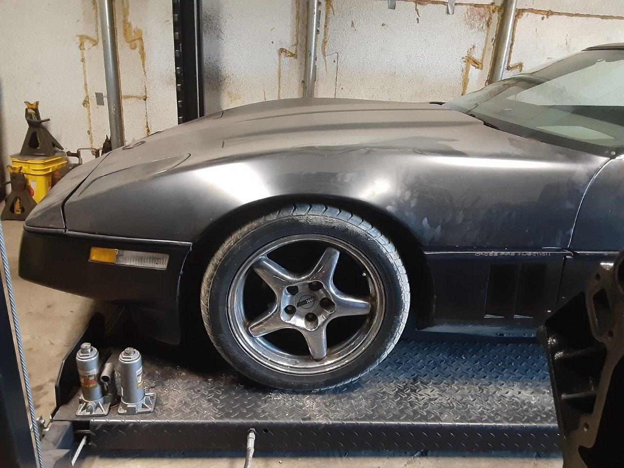

So this is what I ended up with. Or well not exactly. This is how it is right now. Griffin radiator, QA1 coil overs bla bla bla. Anyway It runs better then anything I have ever owned before. Well that wasn't good enough I guess. So I started planning. I had already swapped in a Dana 44 with 3.73's almost 20 years ago. So I figured it would probably handle most anything a street engine (on street tires) would throw at it. So I needed a better transmission. The 4L60e isn't bad. Well yes it is. It kind of sucks from a power handling standpoint. I wanted something that I could beat the snot out of and not care. So I went 4L80e.

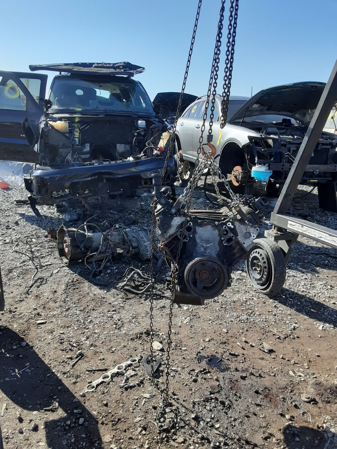

This came from a 2009 Chevy Express 1 ton work van. U Pull & Pay was having a sale that weekend. Any motor with a transmission for $200. So I got this with a 4.8L V8 attached. It had the TBSS intake and 799 heads. Now for you LS guys you're already seeing dollar signs just like I did. So I made almost $900 selling the heads and intake. That means I got paid $700 to take this transmission. See this is how car building should be!!! So the 4L80e is in the car now. After making a C beam adapter, putting in a 3600 stall FTI converter and having a driveshaft made it's ready to roll for the summer. But wait....I said this was an LS build thread. Yeah so about that.
I always wanted an LS2. But I just couldn't afford one. That and my LS6 was doing just fine. Then one day at the junk yard I cam across a 2004 Cadillac Escalade with a 6.0L Now for those that don't know the Escalade's have an LQ9. These 6.0L's are just a little different from your garden variety LQ4 truck or van engines. They use LS2 pistons. Now this particular day at the junk yard was a 50% off sale. So it was like fate or something. Also someone had already half pulled it for me. The fenders were off of it. The motor mounts were already un-bolted. The exhaust was off. Oh and there was already a hoist attached to the motor. Someone the day before got it ready to pull and then figured they would come back for the sale and grab it. Yeah I'm an *******.

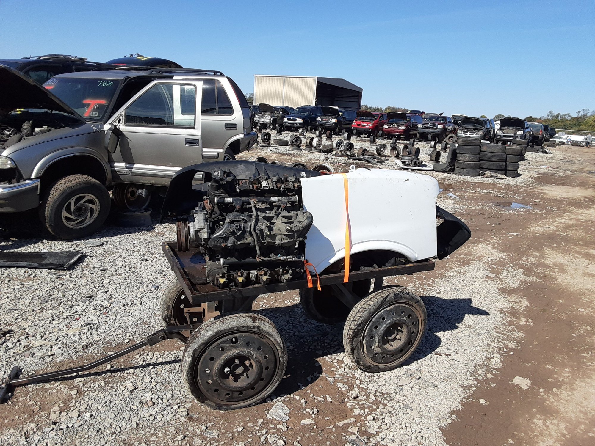

If you want an LS engine like this on a 50% off sale day you need to show up at 8:30am and wait in line. That's just how it is.

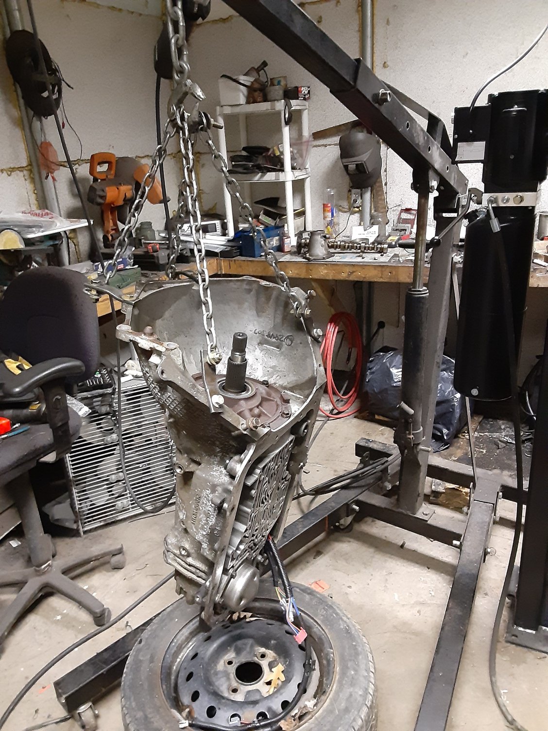

So after lugging this iron beast around the yard finding some parts that my friend needed for his work van I figured it was time to go home. Now there is some fowl language in the next part of this story so reader beware. On my way out I wanted to stop and look in the Escalade just to make sure I didn't leave any tools there. I found this written on the dash in marker.
Sometimes when I'm feeling down I look at this picture as a pick me up. Moving on.

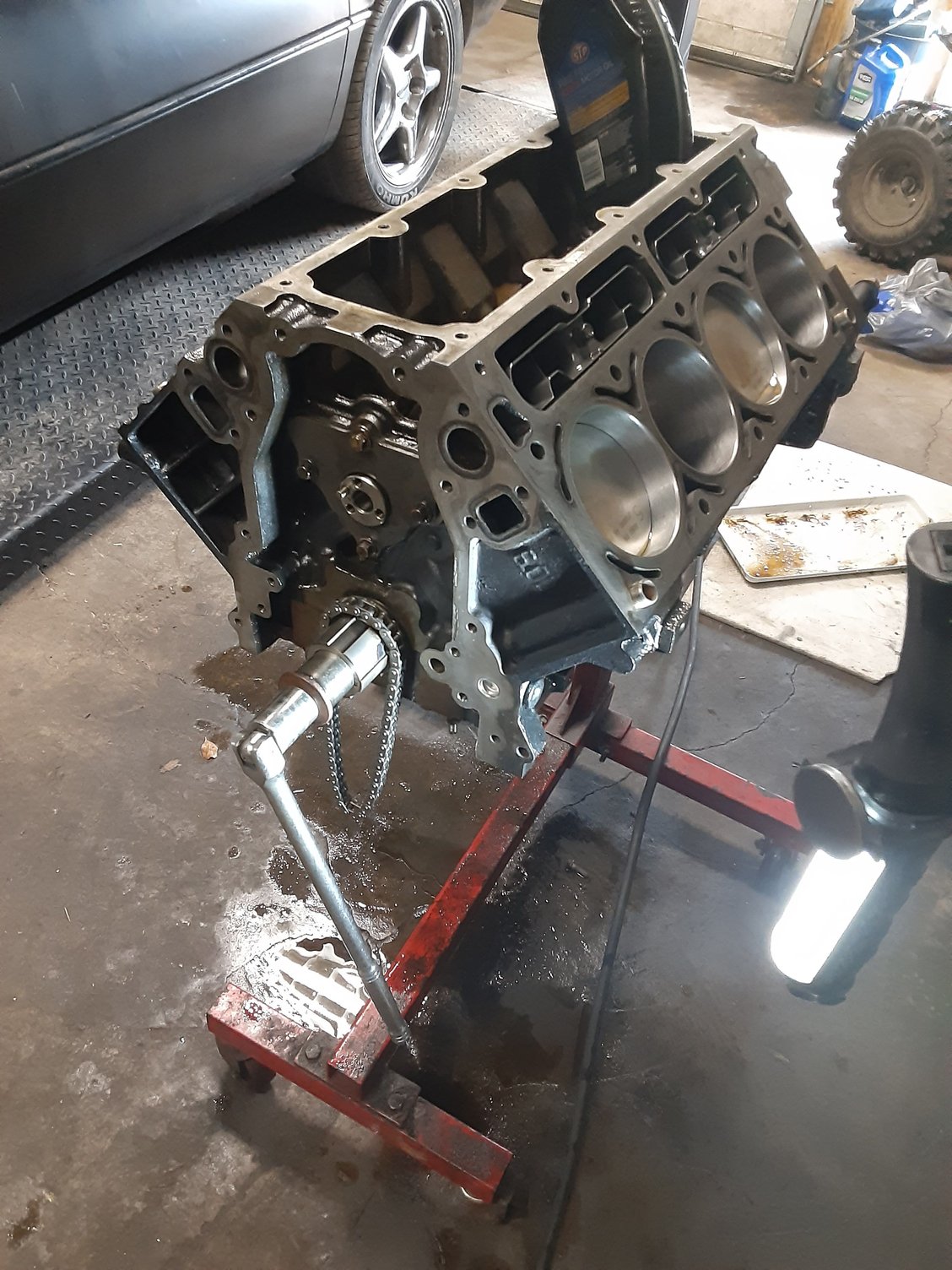

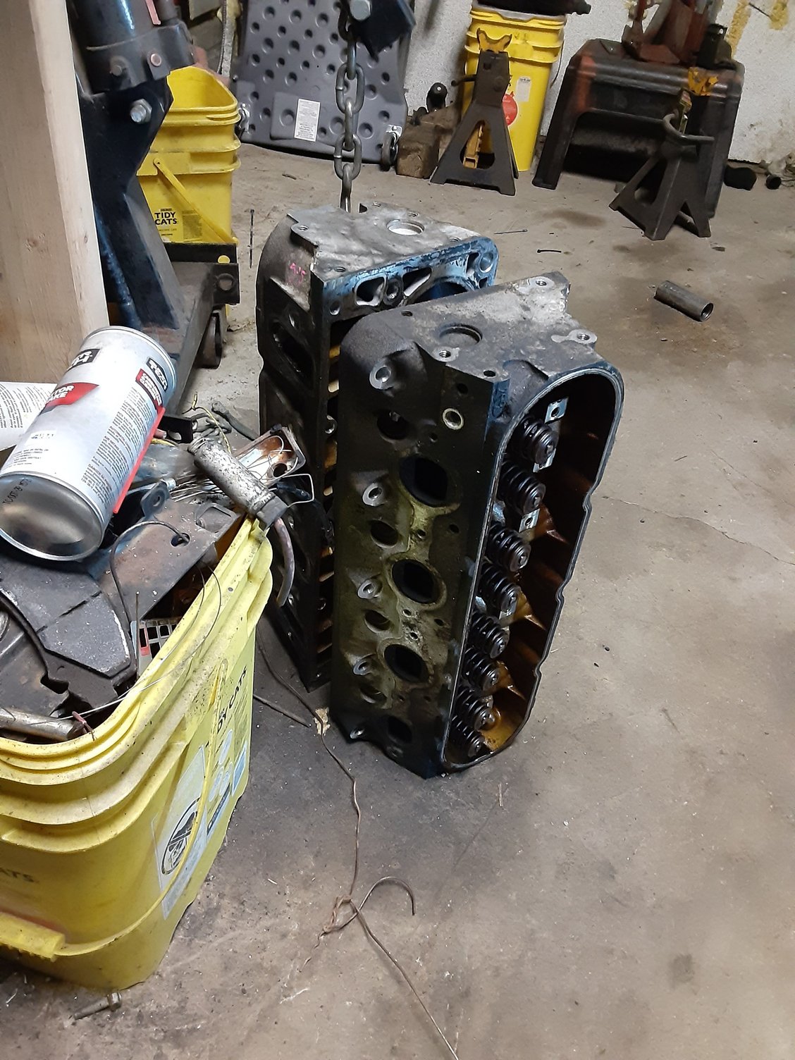

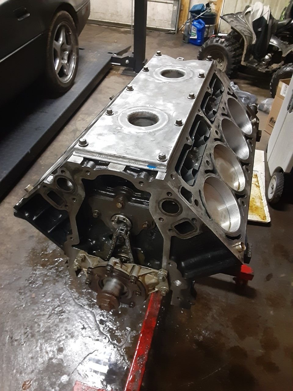

So I pulled the motor apart. I knew that if I built this and put it in my Vette as a replacement to the LS6 that it would NEED nitrous. I mean come on. Gaining 110 pounds from the iron block I have to get some benefit out of it. So I needed rings gaped for a power adder. So over the last few months I started cleaning. 3 cans of oven cleaner and some rubber gloves got the block kind of clean. The bores looked really good just a little glassy. So I went after them with a flex hone. Then I ordered a Hasting piston ring set with a steel top ring and gaped them for the juice.

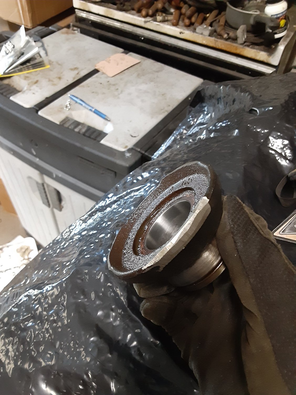

Now I made the mistake of looking at my cam bearings. I know if you look at them that's what makes them go bad. Well I did and they were bad. So I did in fact change the cam bearings. I threw in new rod and crank bearings too. I wasn't going to just for the fun of it but they weren't that expensive.

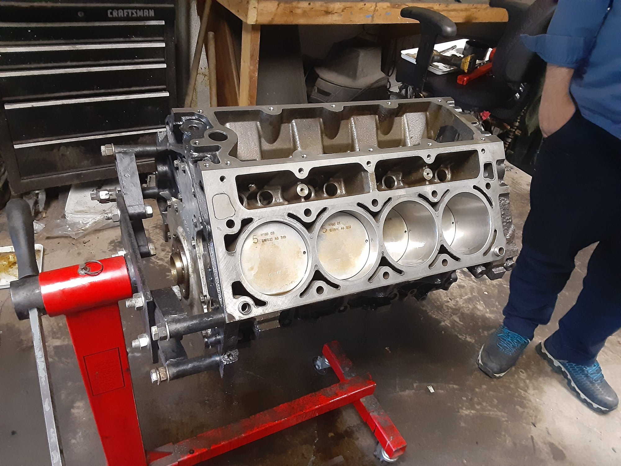

So this is what it looked like with the decks cleaned up. New bearings and rings. I even used plastigauge on the main and rod caps. I was so proud of myself.

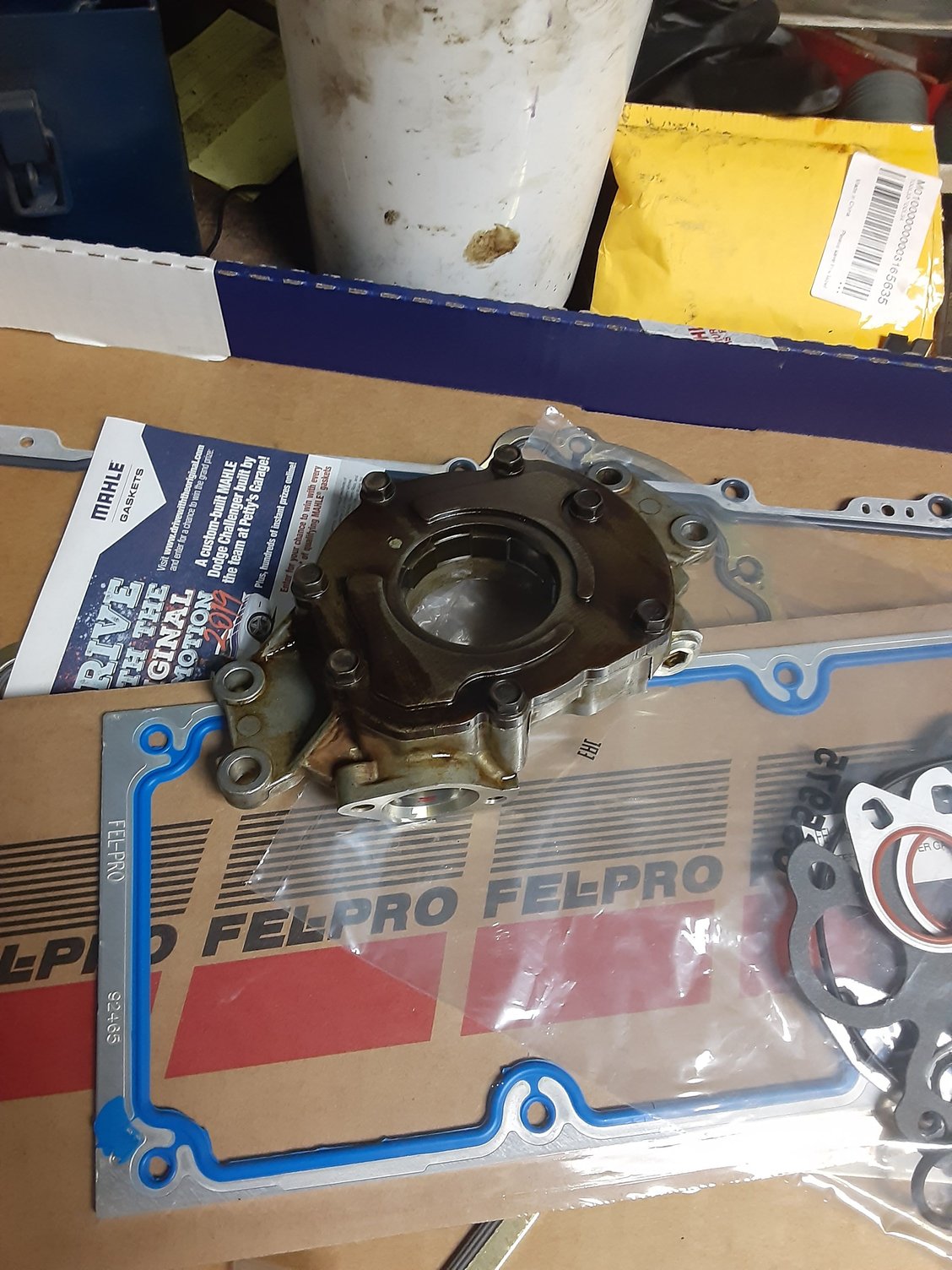

So last night I ported and shimmed the oil pump that I pulled off that 4.8L It seemed in way better condition then the one that was on the 6.0.

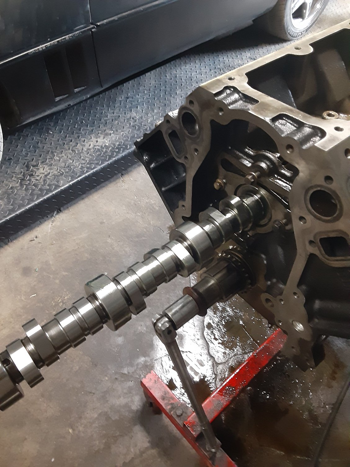

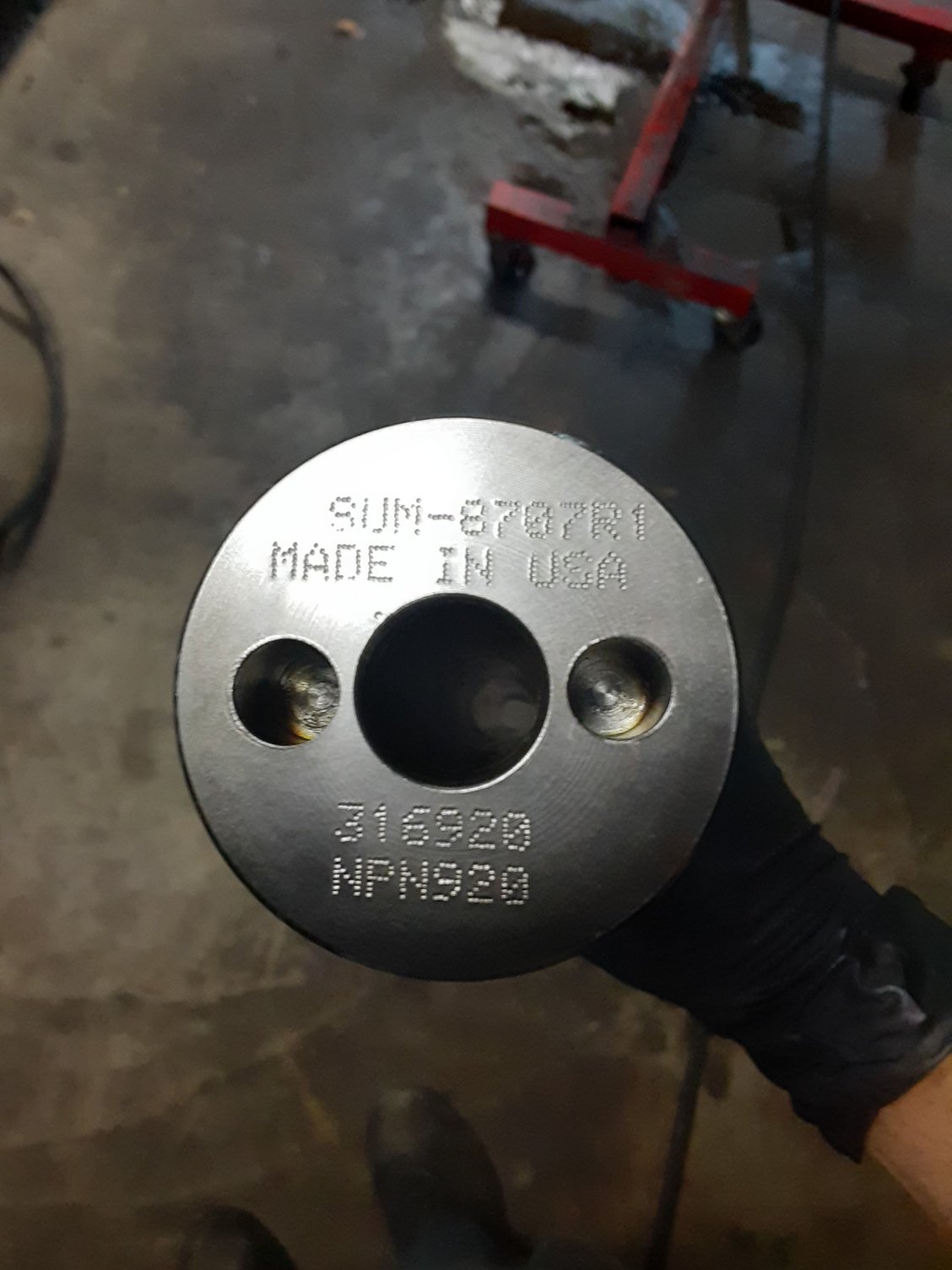

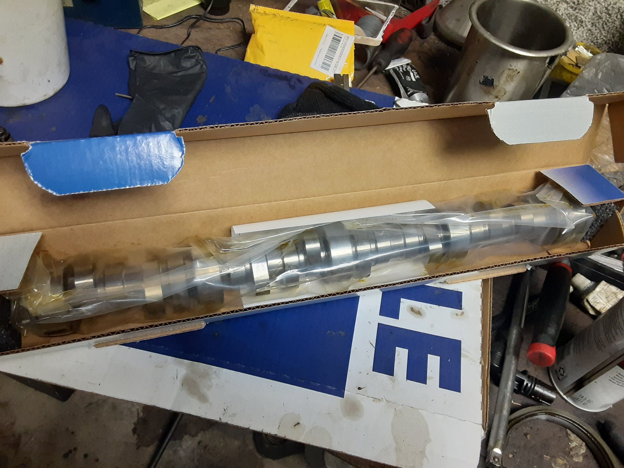

I get home today and find my Summit Racing order showed up. That means it was CAM TIME!
I think I am going to love this cam!

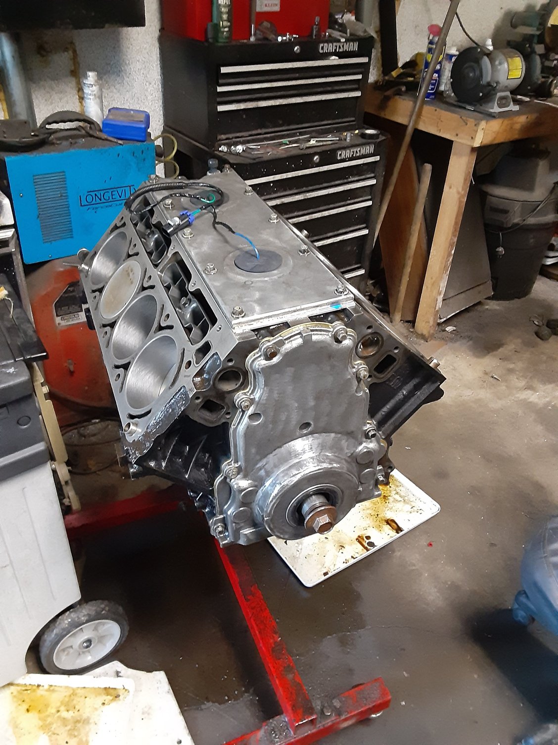

So this is how it sits now. I got new lifter trays from Summit along with a new LS2 timing chain. Not sure why but it was only $30 so why not. I slapped in a set of LS4 lifters that didn't have too many miles on them and there you go. My plan is to put a set of stock 243 heads on this to get me 11:1 compression. Same as an LS2. Then splurge a bit...or a lot and buy a FAST 102 intake. I figured it should be fun with a progressive 200 dry shot being controlled by the Holley. And if I blow it up I'll just put the LS6 back in.
I can't find my cam sprocket anywhere so I guess I need another one before I can button up the front cover.

She looks good but it's just not going to make it. So I gotta jack it up at least an inch overall. I guess that's the great thing about coil overs.
