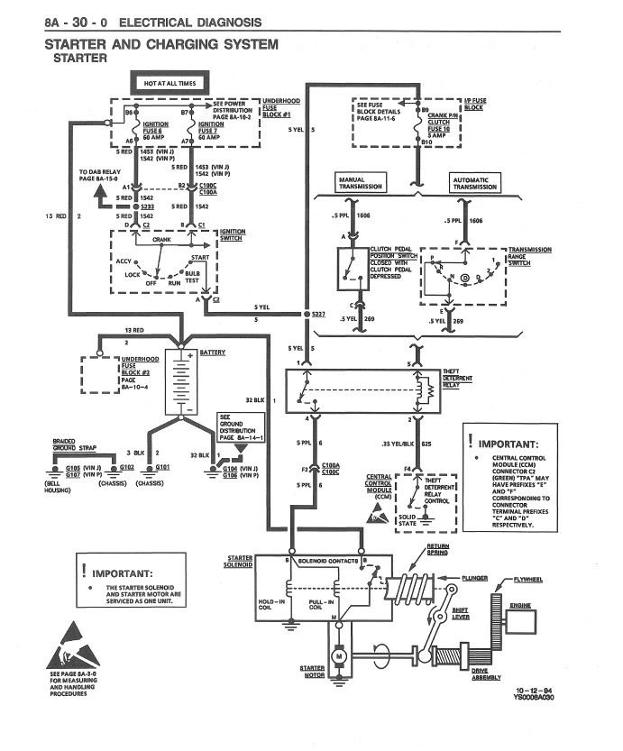

ZF swap is out the door at this point. I can't find where the clutch pedal would mount to under the dash. I cannot find the clutch release switch wires anywhere under the dash(purple and yellow). Everything about this car looks like a prior manual except under the dash..that looks like an automatic. The only purple/yellow wire I can find plugs to the wiper motor.
SMH. I am completely lost at this moment. Can't even get the d*amn motor started. I got the correct resistor hooked up to VATS, security light not blinking anymore, but still no crank = N safety switch. But there is no safety switch to be found.
Do you have the FSM? The theft relay is left of the column behind dash and both PPL and YEL will be available there and you could trace to where the clutch operated safety switch actually was. If you have the FSM the 8A-201 section has many images that could help you. Without the FSM this car could be quite a challenge!!
Old May 10, 2021 | 09:16 PM
WVZR-1's Avatar
WVZR-1
Joined: Sep 2003
Posts: 25,398
Likes: 2,742
Old May 10, 2021 | 10:20 PM
No FSM. I got your PM and sent you an email.
I eventually found the safety switch wires. It was cut short and already bound together all the way in the back. Safety switch bypassed. Starter Relay tested and also replaced. Correct VATS resistor in place(plugged into the end of the orange line that was pulled from the ignition cylinder). Still no crank. Security light is solid now(was blinking yesterday). Waiting for my VATS bypass to show up maybe that'll make a difference but I doubt it.
Going the pull the starter tomorrow and check the solenoid. I dont think there's much more outside of that.
