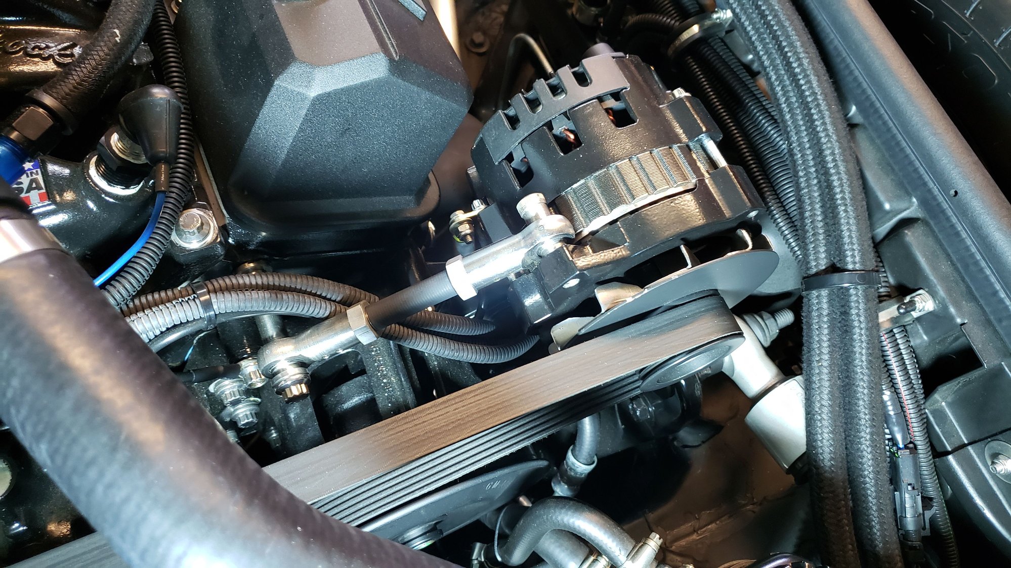

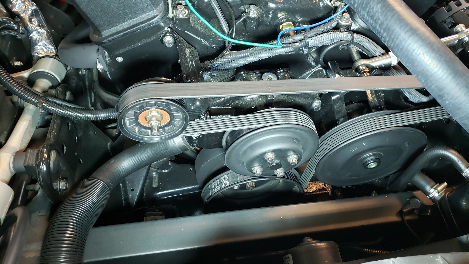

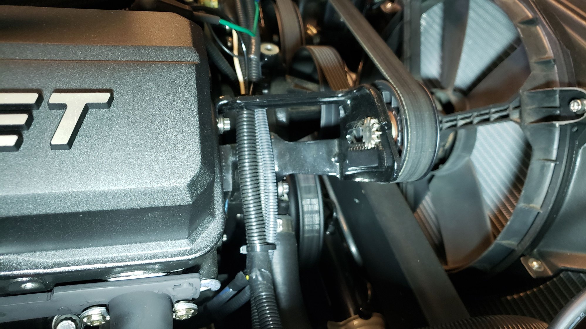

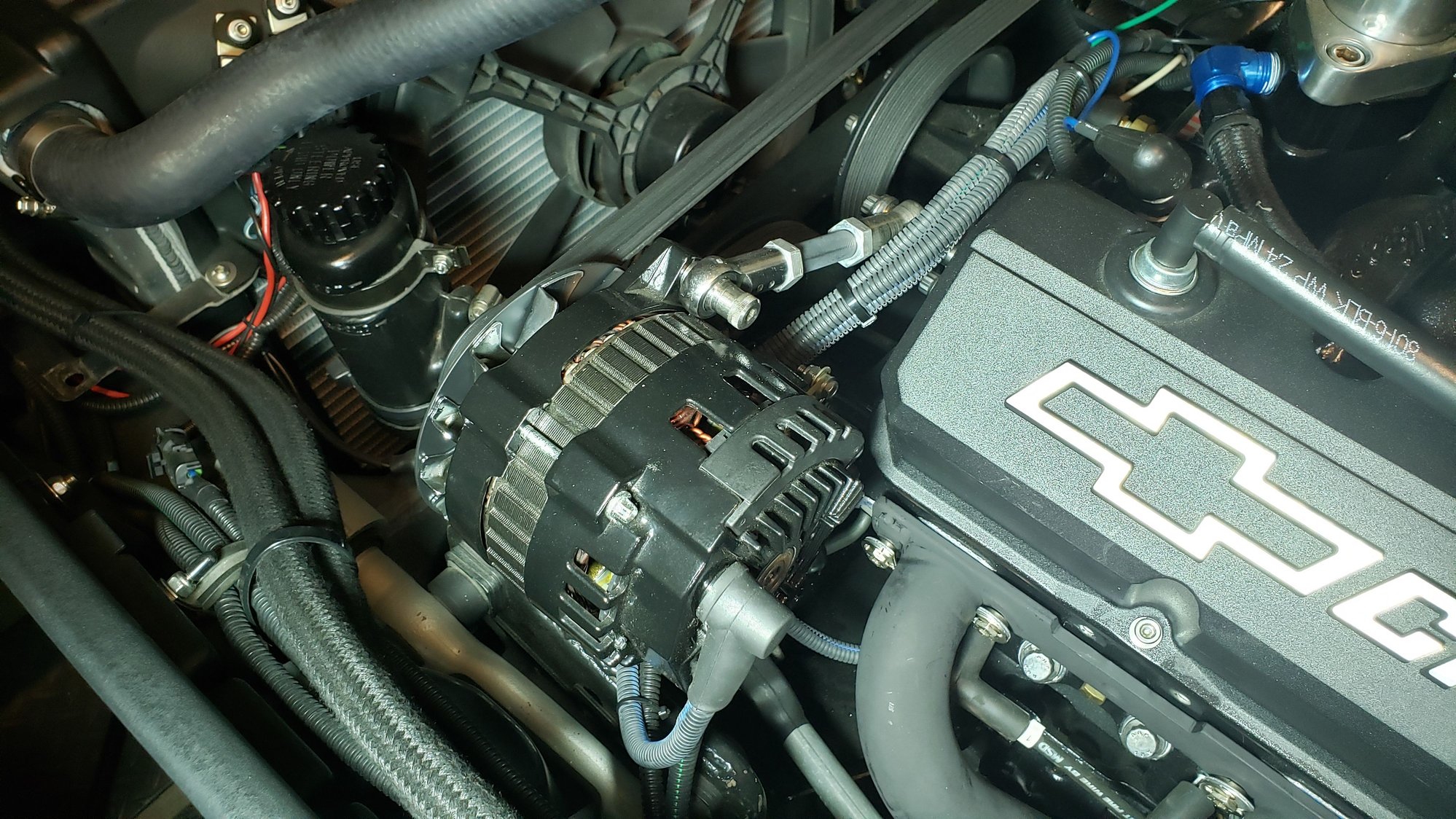

Old Jun 13, 2021 | 08:54 AM
FostersPerformance's Avatar
FostersPerformance
Joined: Jul 2003
Posts: 3,500
Likes: 879
From: Saratoga Springs NY
This is mine. 88.
The left pulley is from a Mercruiser setup.. if you have a marina near you they could sell you one cheap. It adjusts with 2 wrenches and works great. Had to modify bracket a little (still don't know why, I have GM fastburn heads). The alternator is a 1 wire unit that fits the stock lower alternator bracket (but had to drill out lower hole in alternator 1 size bigger, no big deal). And then on top I made the support rod. Engine uses stock crank pulley, stock power steering pump, and stock waterpump.....was easy to do.
as far as headers I cant help you there. I have heddmans and they fit perfectly..
Just throwing some ideas at ya.
