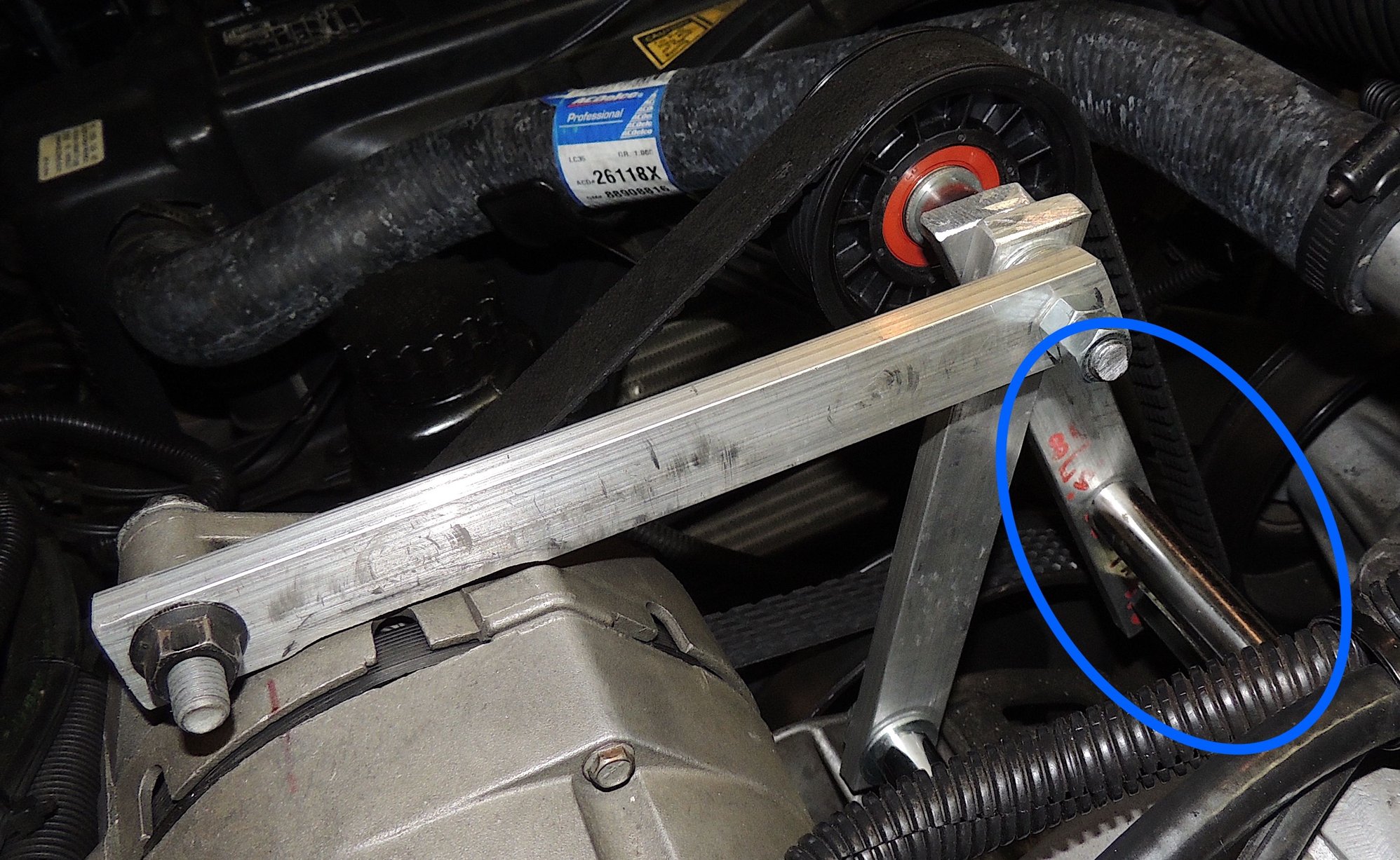

I may have found something
the only thing I could think of that changed physically and was attached to the head on this side only was the bracket. I removed the circled bolt and spacer in the bottom pic circled in blue - it appears the sound may have left. I thought it was tight - my questions are how tight can I make that before breaking something - and maybe even the other question is - do I need that one? the top pic shows the triangular formation of the brackets - i wonder if that will be enough
any thoughts?
thanks
Sean
any thoughts?
thanks
Sean
The end pad bolts can go like 25-30 lb-ft iirc.

If it was that bolt, replace it with a grade 8 stud. Blue loctite it to the head then you can use a nut other side.

thanks - I changed the pcv - just in case - I will check again with and without the bolt - 2 other thoughts/questions - is there a target torque for that bolt? bracket for pump? and with the set-up is it a necessary bolt - ? I realize extra stability - just curious as I had set mine with an extra piece in the bracket creating a more triangular bracket?
