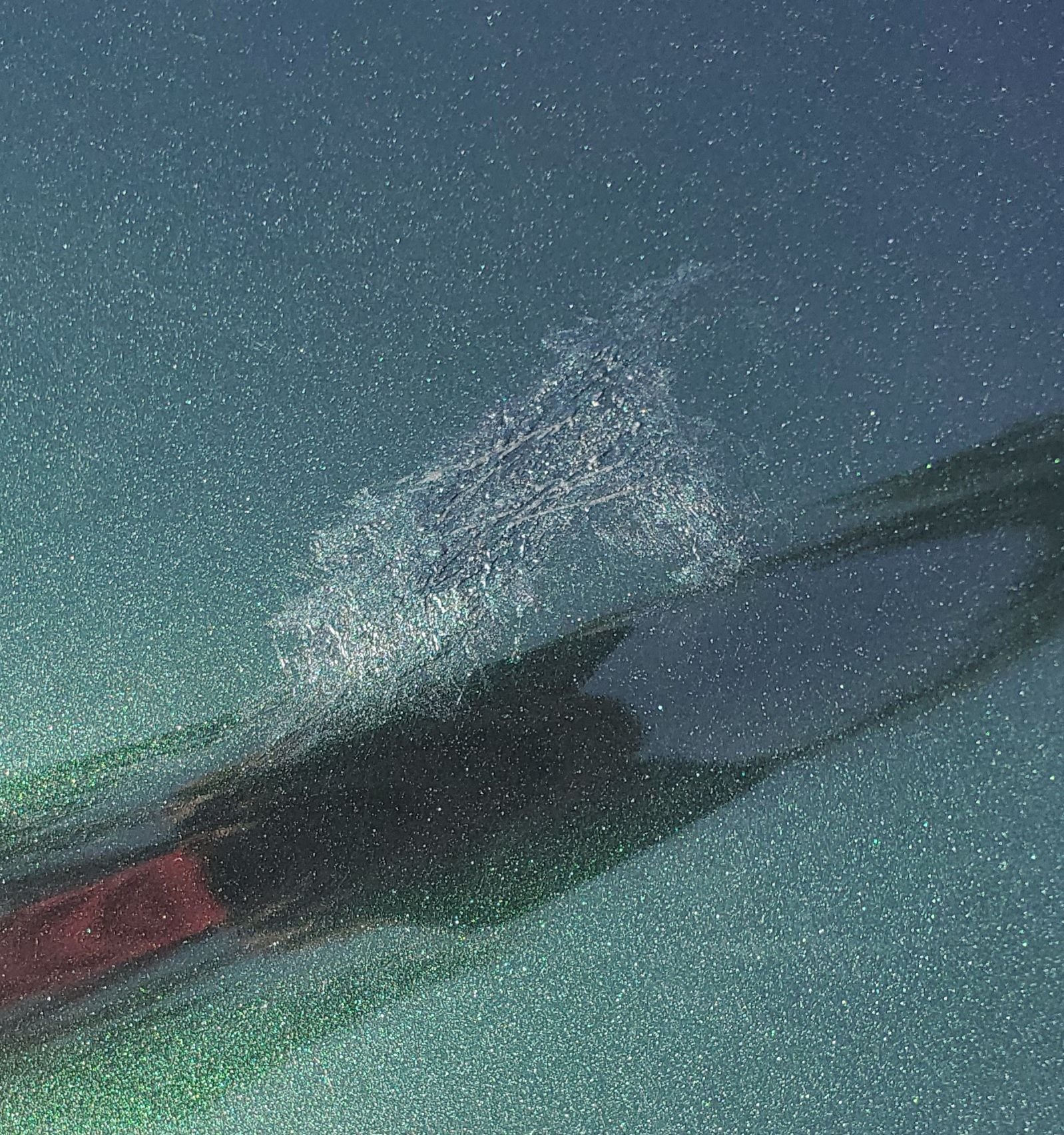

Going to repaint my hood, best results with a spray can or paint bucket with brush? Double clear coating the whole car as well. First timer painting a car btw. Vette is a 92 disregard my Username lol

looking to touch up only this spot. Duplicolor pen didn't match my car despite being same color code u3595. It's brighter than the first color. Made it worse by spraying emerald green metallic like a blockhead.

I would carefully block sand that botched touch up with a hard small block going from 800 to 3000 grit and then polish. If you don't go through the factory clear it should be 99% fixable.
Something like this https://www.eastwood.com/eastwood-15...block-set.html
A brush, rattle can, or roller is never the answer. Well, a rattle can maybe, but only in skilled hands.

Id wetsand it, perhaps fill the gouges w/clear then buff it out.
The post about legit car paint in rattle cans is accurate. PO did some areas on my 88 there was only 1 spot with flaws the rest you couldnt tell.
If you screw it up youre hardly out a thing. Bet a paint shop could so that super cheap in a day or so.

You lose absolutely nothing by taking the car to a couple of body shops and ask for a quote.
Block sand it really lightly to get those big ridges knocked down and then you can literally polish everything smooth with a random orbital buffers ..... then lets see how bad it looks.
Do it with a spray can and you're gonna kick yourself afterwards.

I mean I can go to a body shop and have them do it sure but I want to learn how to do it myself as well. Already sanded the part that needs to be painted on
