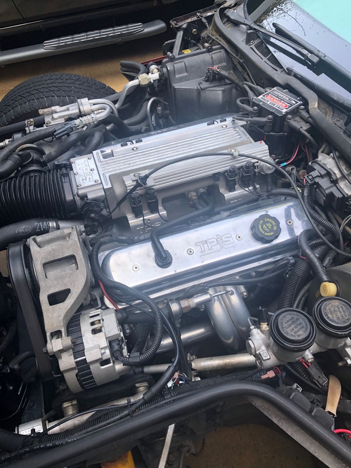

Purchased this 88 4+3 car off ebay two weeks ago, 49K miles, great paint, nice interior. It arrived late last week and we were barely able to keep it running to get it off the trailer. Once it warms up it seems fine, it might have a bit of a stumble when the RPMs drop but I've not quite nailed that down yet. I of course did the rookie mistake of throwing a few parts at it... new TPS (calibrated to .54 volts) and IAC valve but no dice. Seller did include all the docs from the previous owner including a Service Manual and a ton of receipts. In the manual the page on Rough idle is dog-eared and a page of notes on what he tried. I think the original owner that did all the mods (circa early 2000's) struggled with this issue from the get go, sold it to the guy I purchased it from a couple of months ago. He probably realized he was in over his head and sold it via eBay (without disclosing the idle issue). To his credit he has offered to help if it gets costly to fix. I don't see an EGR valve on this setup so I kind of ruled that out. Also the AC is out but I knew that before buying, I mention that because I read it might effect cold idle?
Any and all help solving this mystery would be much appreciated!
Mods are:
TPIS/AFS Heads - Unable to determine specs yet
Mini Ram manifold and fuel rail kit
ZZ9 Camshaft
Long tube headers
170 degree thermostat
Level VI PROM, Mini-Ram, 86-89 F&Y (this is the updated PROM maybe?)
Attempting to attach video of cold idle
