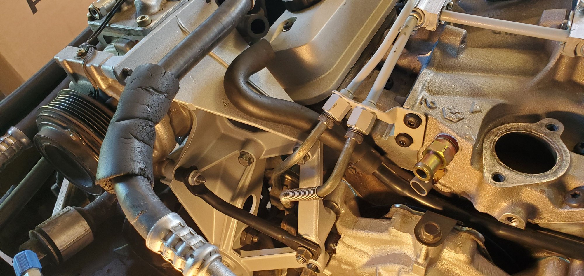

You don't have to do that. I have never considered this possibility, but this is the most likely answer to your problem. On the '89, the fuel lines and O-rings at the connections are exactly the same size. I figured this out a few months ago when I did mine; the factory parts diagram calls out two different part numbers for the O-rings (with different diameters) but the documentation is wrong. Some '89 models (at the very least, maybe all of them) have the same size lines and O-rings for both the supply and return.
https://www.corvetteforum.com/forums...gs-1989-a.html
Originally Posted by 89_Aileen
And you’re certainly right ajp01, that old FPR diaphragm was rotten!
Yeah, ask me how I know...
Last I remember I reconnected the lines precisely as they were when I first disconnected them to change the injectors. That was the first time I messed with the fuel lines. Is it possible that someone before me could have switched the lines to the wrong connections, and the car still ran in that configuration?
No, it would never work.
Or it could be that I fixed the problem by changing the injectors, FPR, or something else, and then created a new problem as I put the car back together by mixing up the fuel lines.
Yes, yes it is. Here is a picture of what they should look like connected. The line with the ribbed protection coils wound around it is the fuel supply line, and it should go to the rail directly. The other line, the one without the windings, should go to the gray tube (return line) on top of the fuel rail.
