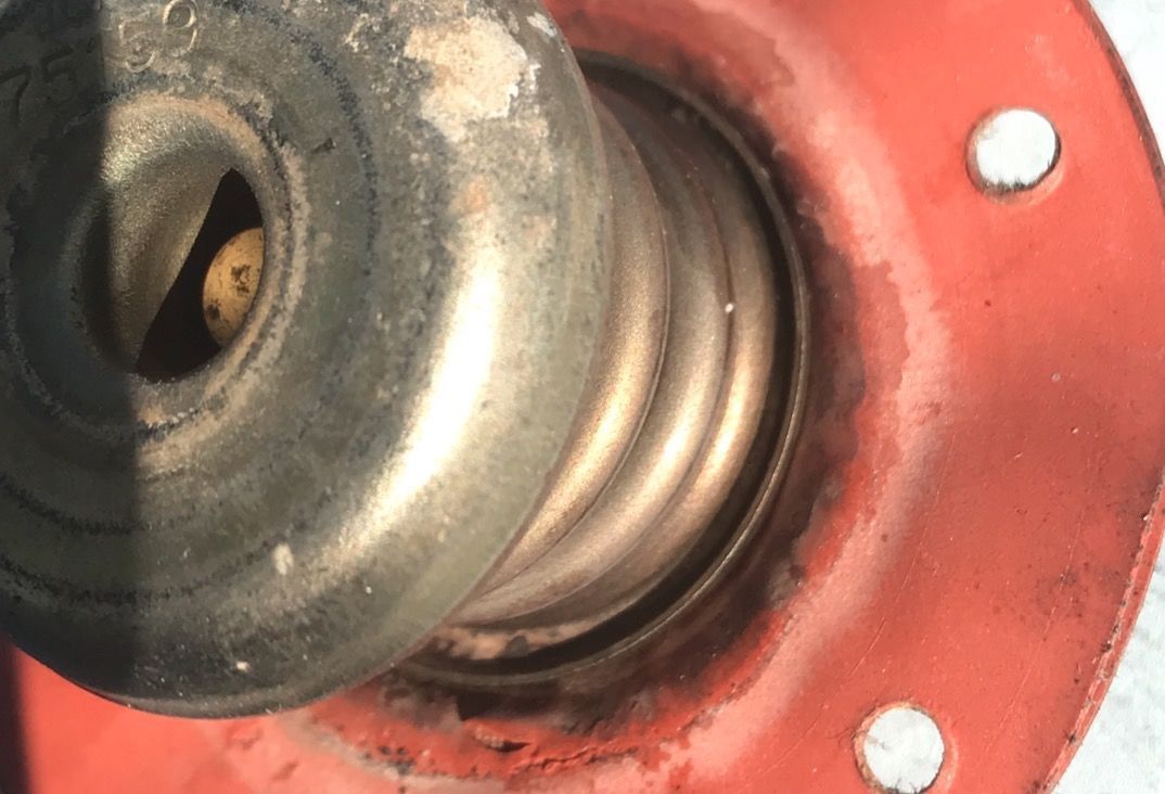

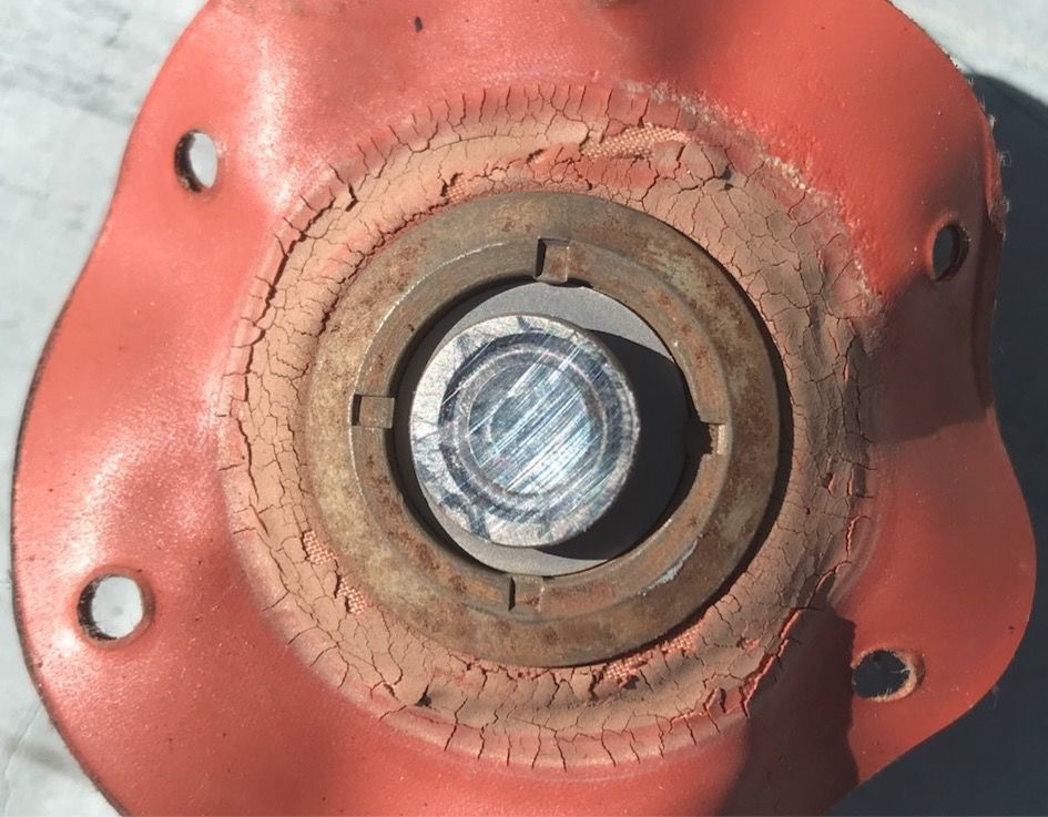

Maybe give the fuel pressure regulator a look, too. But you have to pull the plenum and if you go that far, you may as well swap it out anyway.
Here's what the fpr looked like on my '90 when I yanked it...
