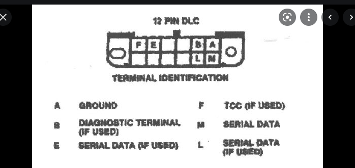

It's probably an intermittent issue. Try reading the codes with the paper clip technique and see if a code was stored. That should lead you in the right direction.

Jump the A to B port on the diagnostic connector and get the code that is the first step.
If I have to take a guess it would be the MAS power relay or the burn-off relay. Those will pop on at the first hint of a problem but if the condition is only intermittent the car will run fine if the condition fixed itself. My 1988 firebird with a MAS and TPI would turn on the check engine light as soon as it was started but run fine, it was the MAS burn off relay. I would immediately turn the car off and restart and no light, but a code was set so I replaced the relay and problem solved.
This is my guess but check the code.

https://tech.corvettecentral.com/201...trouble-codes/
