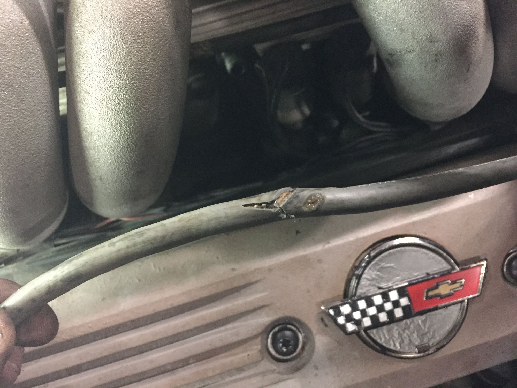

Herers an untouched stock plug wire at 49000 miles.

Originally Posted by SloJo
I just looked in my 93 FSM and on page 0B-6 Item 6 it states: Replace spark plugs every 100,000 miles.
Have you removed and examined the plugs? FSM makes assumptions on how the car will be used, weather, gas and all kinds of other factors.
Better to examine the plugs, make sure. My '87 sounded a little rough and started eating oil, checking plugs found one oily and black as night. Long story short, that cylinder turned out to be the problem alright.
