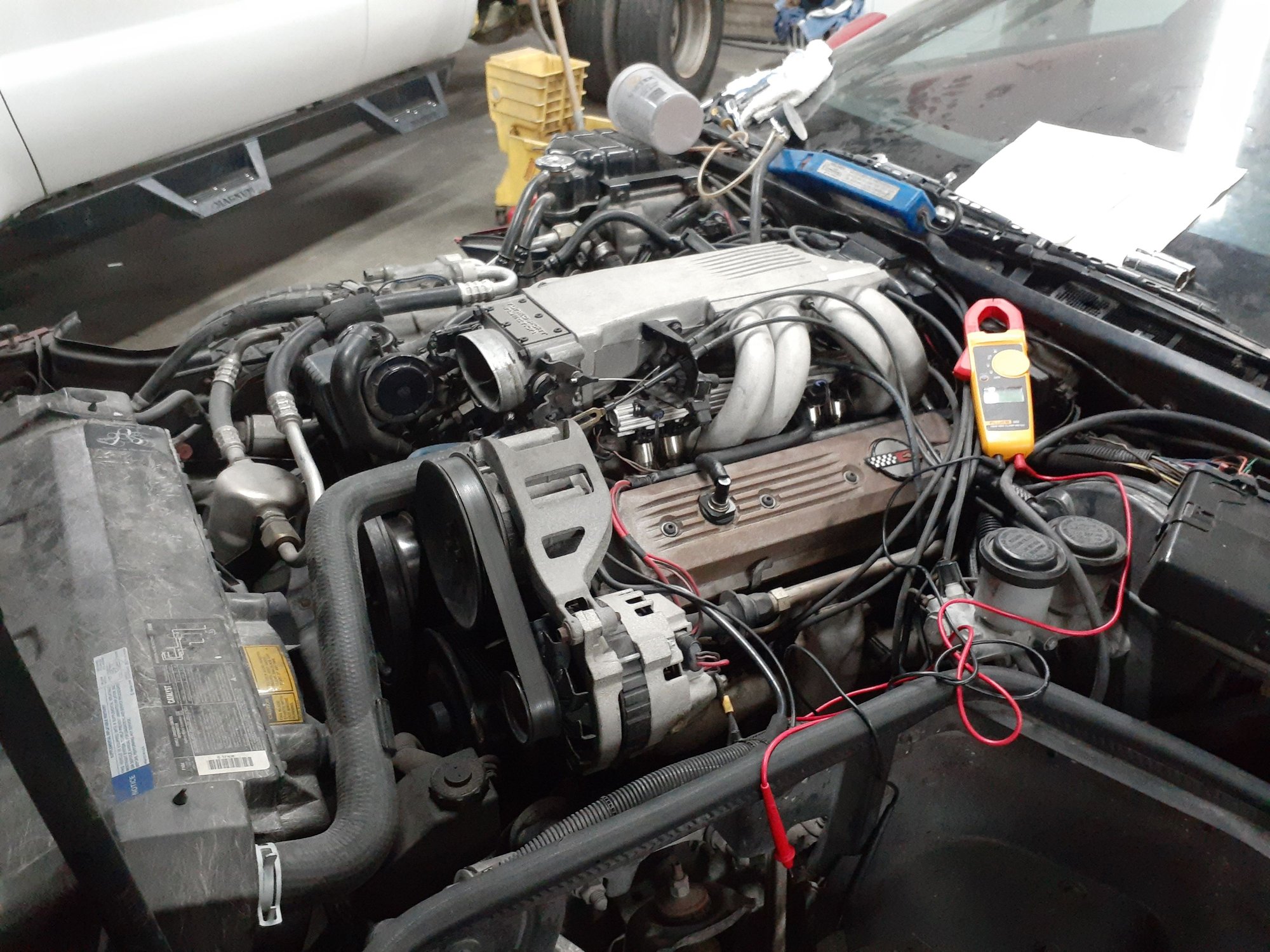

Old Nov 15, 2021 | 07:32 PM
Robert_'s Avatar
Robert_
Cruising
Joined: Nov 2021
Posts: 10
