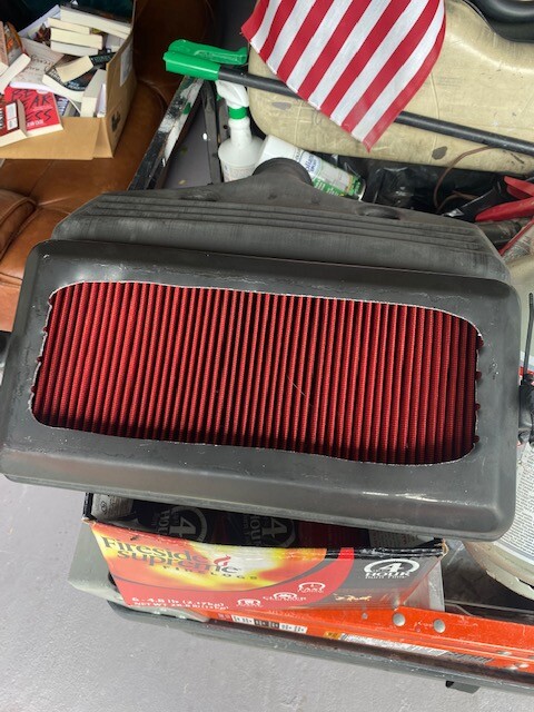

so I finally got around to pulling the air box today and found this.
looks like he chopped something off of it and also added a K&N filter, the car still does the rev up/down when stopped and the amber service engine light has come on but it goes back off.

could this be my issue?
What did you find...I see nothing???

Owners often “cut the lid” in an effort to generate more airflow is all that is being shown in your photo. It really doesn’t do much if anything for improving airflow but this is not something to worry about.

If the the filter was over oiled it could cause a problem with the MAF.
