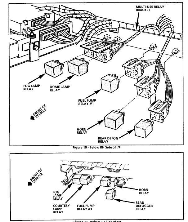

Fog Lamp, Courtesy, Horn, Fuel and Defog relays are under the Right Side of the IP. You do have 'courtesy' lamps.
Being a new owner it's always suggested that you get a FSM (Factory Service Manual) and it would be wise. The relays aren't a difficult reach.
I can't PM you because you're a new user - Drop me a PM or an email using the links to the left under my user ID and I'll share some information.
They're arranged in this sequence under the right side;
