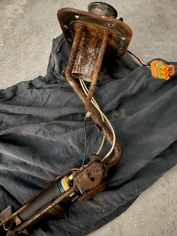

I wound up going with Corvette Mods. Not OEM, but for a 35 year old car that needs more work, I went for the Taiwanese product. I got it for $204 complete with pump and gasket, including shipping. I found a coupon online to save about $23.
Took less than an hour for removal and replacement. Got 39 PSI at the rail and it started right up.
The old unit had quite a lot of surface rust/oxidation on it. Hopefully all of that particulate matter stayed out of the fuel system.

Ok that's ugly, apparently at some point car spent some time off the road with minimal gas.

Ah. That makes sense.
I was with my dad when he bought it at the dealership in Florida in 1986. He lived overseas, so it sat in storage stateside for about 10 years with minimal driving.
