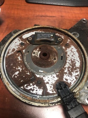

I would not throw away that opti. I can be corrected by the experts but that looks like an original mitisibusi sensor. You would be better off sending that to the optidoctor to be rebuilt. If you really want one from China I think the optidoctor will buy that for $80.00. Dan

The new Opti is in with the new plugs and wires. She's fired up like a champ, all the codes are gone for now. Life is good! Got the new coolant in after two water flushes just in time before the temperature dropped into the teen's. Now I need a few good days of rain to clear the roads and take it out for a drive.

I tried emailing Dan, no response. I am happy to sell the old Opti and if it keeps a C4 on the road great. Better than throwing it out. Maybe he's busy with the holidays.

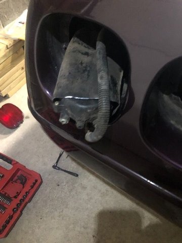

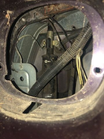

Thank you! Your's will get fixed. Tonights task was fixing a broken antenna mast cable. The suggestion to go through the license plate holder to the taillights is a great suggestion. I had the motor out, removed the broken cable and back together in 45 mins. No need to pull the tire. I was listening to the radio while I cleaned up. It's the recommended way to do it for a mast replacement. I will say one key to getting the old mast out is a quick sharp tug. Don't pull hard with even pressure it will just bend the bracket.

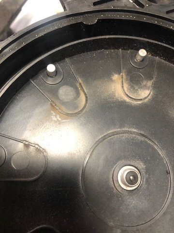

Question for the group, well two actually.
1. The bolster switches didn't work both Passenger and Driver side. I had the seat base off to work on something else (see question #2) and I figured what the heck. I saw a Youtube that they are easy to clean. I pulled both and they both had heavily oxidized copper contacts. Very green, I cleaned them off and everything works fine now. Any ideas while they would get so oxidized? Great zero $ fix, just time and a few curse words getting the seat base latch over the plastic retainer.
2. I fixed the lumbar air pump diaphragm with the bike inner tube trick, another zero $ fix. Easy to do. Question do you really feel the lumber air bags pump up or is this a gimmick? Either way I have to look into it more, air is going in just not pressuring. Not sure if it is a bad release valve or blown air bladders.
Thank you for reading, I am curious about why the switches would get like they did.

I think it's fairly common for the switches to get corroded. Did this same cleanup on my son's 1990 with inoperable controls and the switch internals looked like this:
My thinking about cause is that failed weatherstripping allowed for excessive water incursion. Also, the fact that they were gummed up suggests that maybe the initially had some dieletric grease coating in there as well?

Thank you, I guess its a common issue, 30+ years. I also have a small amount of parasitic battery draw, after cleaning these switches I wonder if it will stop. I know they are hot switches and don't need the key in the ignition to work. I will take the battery off the tender for a week and see. I also have a driver side door hatch switch that doesn't work. I have seen a few different threads for the issue. My center console and Passenger side switches work find, so I think it is the switch itself but I will get a meter on it and see what nets out. On to the next fixing adventure. Side note I did get the car out today, the road are clear of salt after the recent rain. All my fixes seem to have work. I have good power and no codes. I feel a little flutter at a constant speed but my feeling is that is injector related from sitting so long and not running. I will have to watch and I get more miles under my belt.
