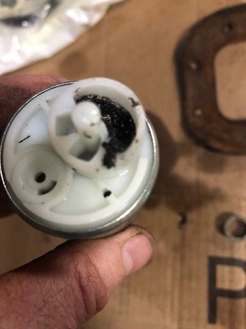

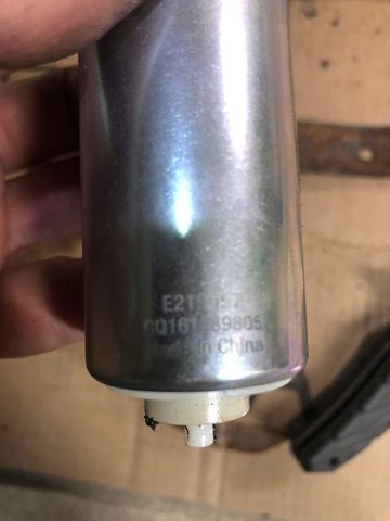

My Corvette adventure continued tonight. I got some free time to pull the pump. Overall not bad, but what I found was amazing. It is a shock the pump was able to draw as much fuel as it did. The PO said they replaced the pump, maybe? The filter sock was destroyed, the fine mesh screen on the pump was packed solid with black crud, maybe the pump filter, maybe pump filter with other stuff. Anyway I am going to change the fuel line filter tomorrow because who knows what passed past the pump. After that with any luck I will give the car a test run on Sunday.

good job on the diagnosis leading you to the failure. personally , after seeing that, i would also flush the line from the tank to the filter.
id probably run a whole can of carb cleaner through it in a few different applications giving it a bit of a soak between.
u could blow it out with air hose too to see if you have chunks. perhaps fastening a white sheet of paper or white rag over the end that catches the blow off for viewing

Guess I got that one right, post #37. Like you, I wondered how the car was able to run at all. My guess is you will see a huge difference.

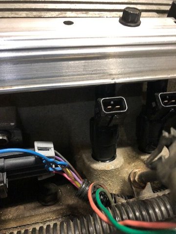

I snuck in the time tonight and I did the fuel line filter and the rebuilt Bosch 3 injectors. Pressure tested for leaks after I was done, did three cycles no smells or leaks. She fired right off. The car wants to run despite these little setbacks, I know she will get there. Thank you everyone for the help when I need it.

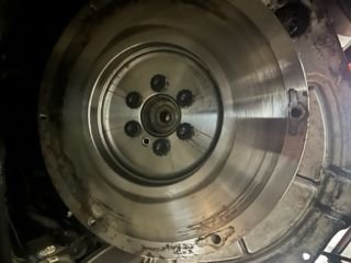

Hello All, Happy Friday! I got my transmission out and its going off to Arizona to get some tender loving care. I am sure it will come back in perfect order. While I have some free time and a bit of curiosity I striped everything down to the flywheel to see what condition that was all in. These are the pictures. I see that the car was converted from the dual mass flywheel. I don't see any identifying marks to see what brand this is, any ideas? This is also the clutch and throwout bearing. There are little markings to identify these, the clutch is marked PHT D1063 and the pressure plate is marked C70043. Any opinions on the wear of the fly wheel would be helpful. It looks like there are a few hot spots and the clutch has that ring mid way in the friction zones. The best I can guess is there is about 5000 miles on the clutch from the amount of miles the second owner added. That doesn't mean all that much I have no idea how they drove and being the trans needs work I kind of think not well anyway I digress, thanks for the help!

Arizona, instead of D&L Transmission on Long Island? Larry has a great reputation on the C-2 Muncies, not sure if he does newer ones or not. I was happy with what he did with mine.
