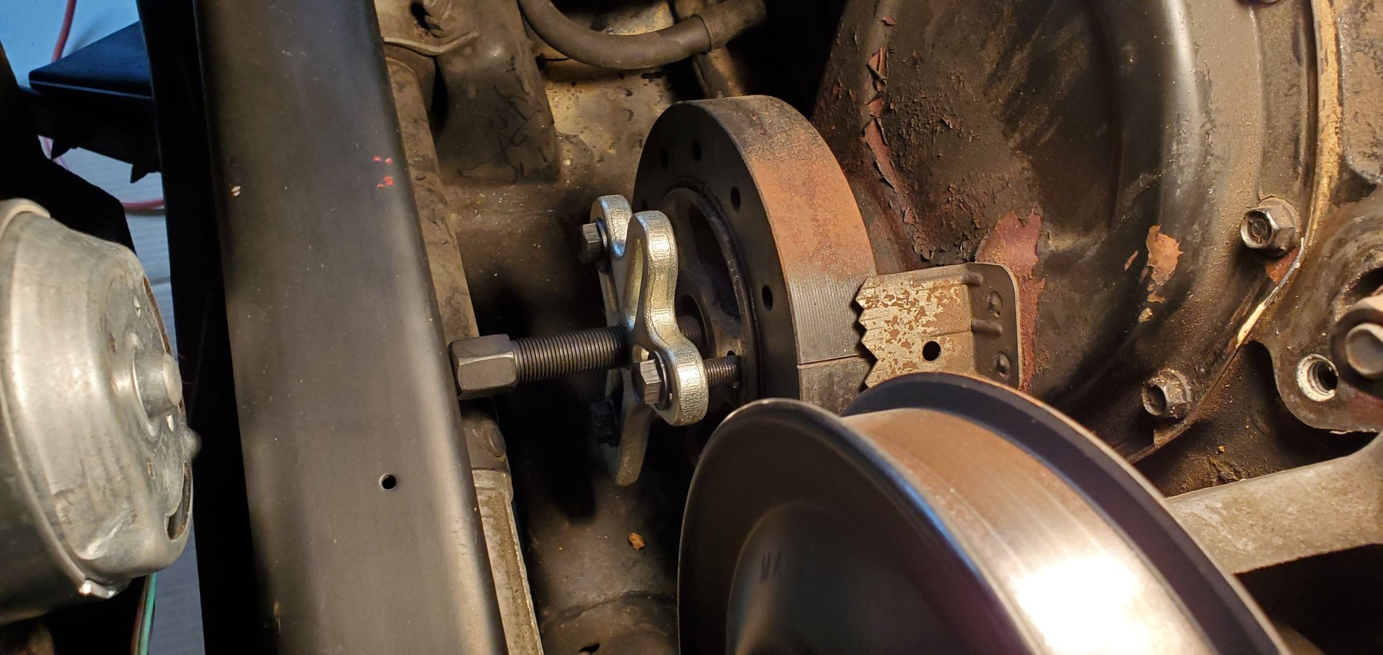

Can it be removed while in the car. Pulley looks close to rs rack.

Yes it can. It's tight but if you use the tool setup that I mentioned here it can be done.
Timing cover:
https://www.ebay.com/itm/23394940808...IAAOSwbbtgZMVC
Tool setup:
https://www.corvetteforum.com/forums...post1604460845
