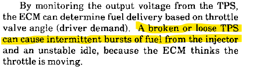

I think that this point - if you have the ability - it might make sense to hook up a cable and log some data while it's doing this. I wonder: Could you have a bad throttle position sensor? Is the ECM perhaps trying to respond to what it believes is a movement in the throttle cable? Data log would show what's going on with the various sensor readings. Given the money you've put into solving this so far, a Moates ALDL cable would be a comparatively small investment.
Just so you know this isn't totally out of left field, here's a clip from the FSM for a 1990:

That could be possible. It's not just having idle issues, it also refuses to rev. It'll backfire and won't rev up if I give it throttle. Could this also be a TPS symptom? I'll look into the ALDL cable, it would be useful to know what the ECM is thinking.
