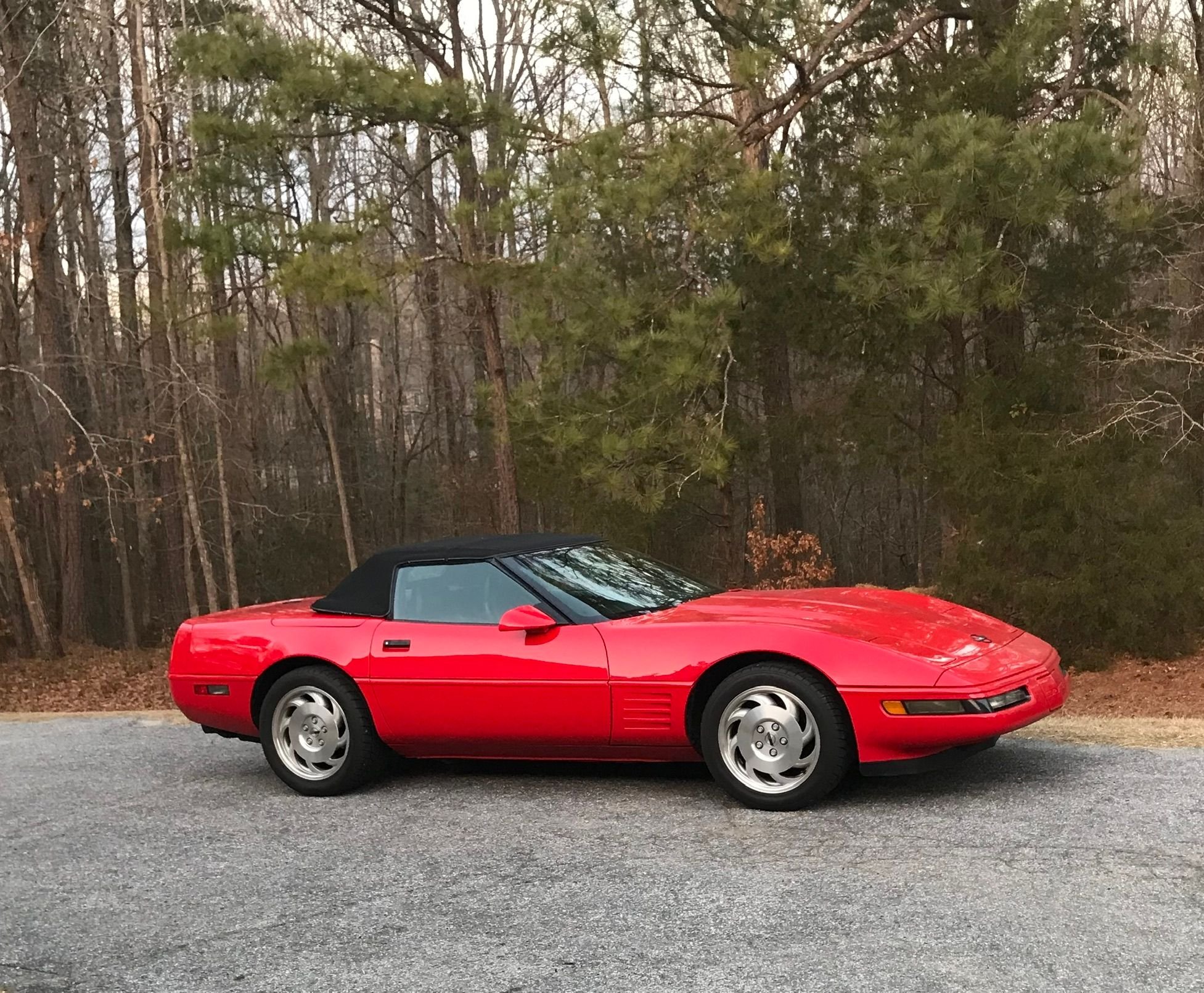

I have a nice low mileage (59k)1994 Corvette with an LT1 engine. It’s a garage kept nice clean red on black convertible. I have a problem that seems to be getting worse. Several months ago my car started idling funny. The idle speed was normal but about every five seconds it would get a slight stumble. Then the idle speed got faster, around 1000 rpm in park and would still slightly stumble. Then I went to accelerate fast one day and it bogged completely out, if I drove it with normal acceleration it was fine. Now the idle seems more erratic. I have not received any check engine lights or anything. I was told the 94 model has OBD 2 connections with an OBD 1 system so I’m not sure what code reader to even try. The Opti Spark Ignition was replaced about 15 years ago but it only has about 8,000 miles put on it since then. I messed it up when I accidentally got some antifreeze on it flushing my radiator, smoked it. I never wash the engine and I don’t see any leaks now. It started running rough and backfiring back then, a little different than what I’m experiencing now. The fuel filter has been replaced. I’ve tried injector cleaner additive. I’m not sure if there is a scan tool or something that could help pinpoint the problem and I don’t trust taking it to a Goodyear type shop with a 20 year old mechanic that does not know what an Opti Spark system is. I don’t have an independent mechanic yet since traditionally I’ve done my own repairs. I was a dealership mechanic in the early 80s but l lost touch with the newer technology. I don’t want to start swapping parts like the throttle position sensor, coolant sensor etc., because that could add up to a lot of money and not fix the problem. I thought about starting with the throttle position sensor however, still undecided. I really don’t want to swap out the out the Opti Spark ignition again because that’s a tough job. I’m not sure if it’s an electrical problem or fuel injector problem. I’m hoping some of you experts can guide me on where to begin to diagnose the problem, is there a scanner tool that would work on this car with OBD 2 connections? Should I try to check for engine codes through the dashboard even though I’m not getting a check engine light? Do my symptoms sound like a throttle position sensor or anything that commonly goes bad with these cars? I know it could be one of a thousand things. I don’t know who to trust to work on it and I don’t want to just start throwing parts at it any advice would be great thanks!!

BTW, your car looks quite familiar.
