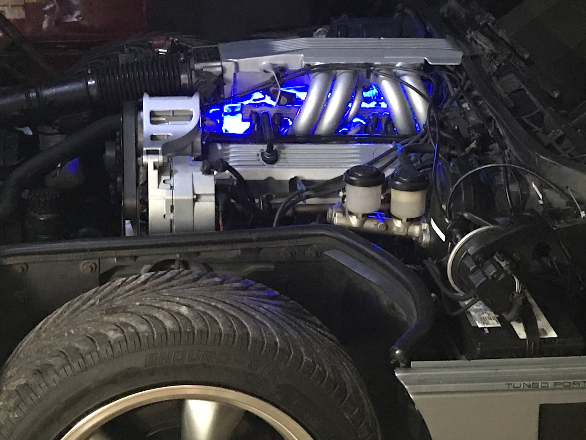

While you're putting this all together, consider doing what I did with my 85. I had the intake apart to paint everything the same color as the car, and I added a strip of blue LED's under the plenum. With the intake manifold painted silver, the blue reflects off and makes that engine glow! Nobody else has this on an engine, and at a show-and-shine, it will actually drag people over to have a look at this cool engine. It's a great talking point!
