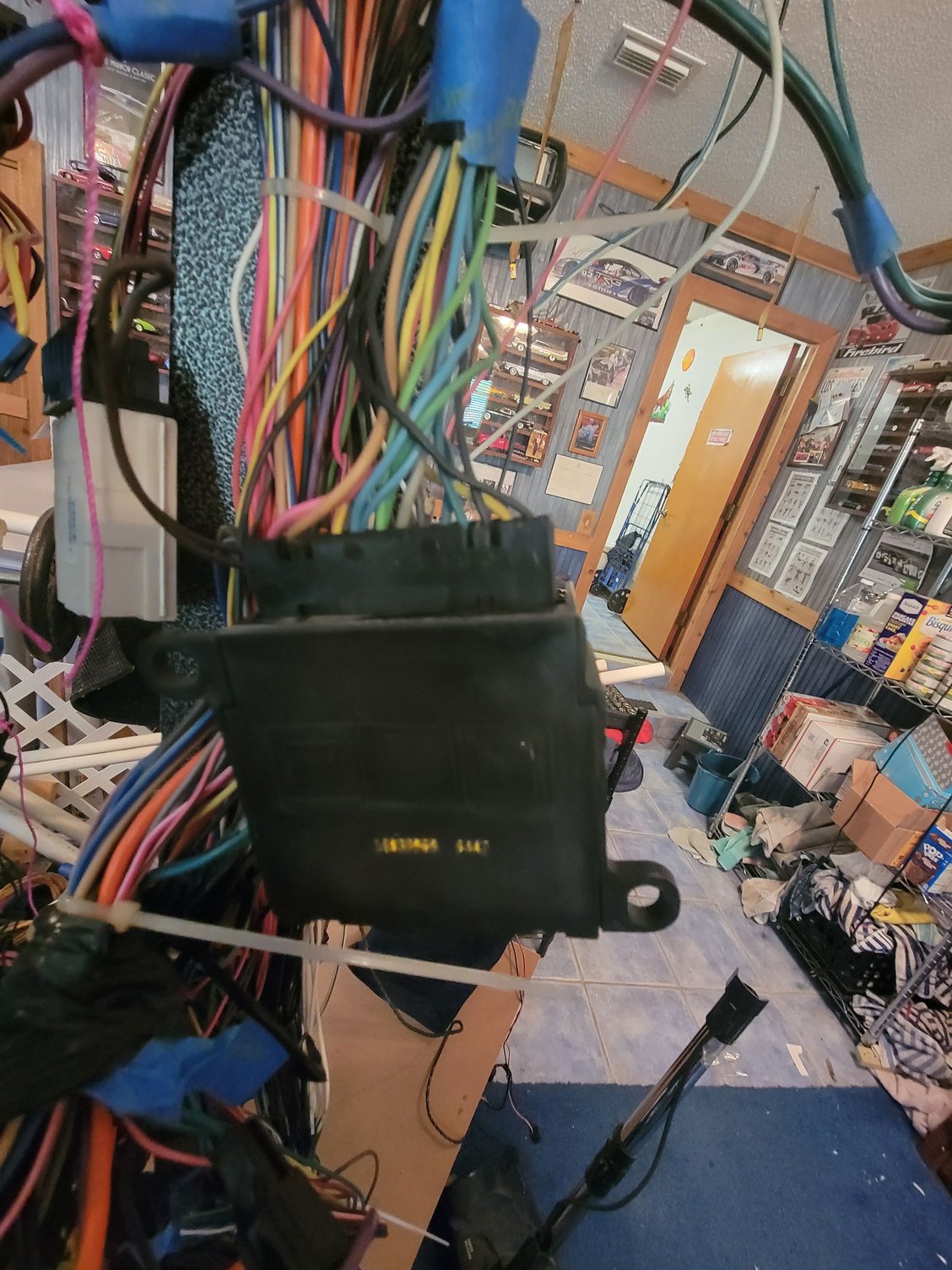

Is this the vats. If so
1. Where is it mounted
2. Are they all the same in each year
3. Are they problematic and should bypass it?

Well, thats very cool that I dont have one. So what is this black box? Light or sound controls?

Sure there is. Is it broken? Car won't start if it is. Leave it alone if not

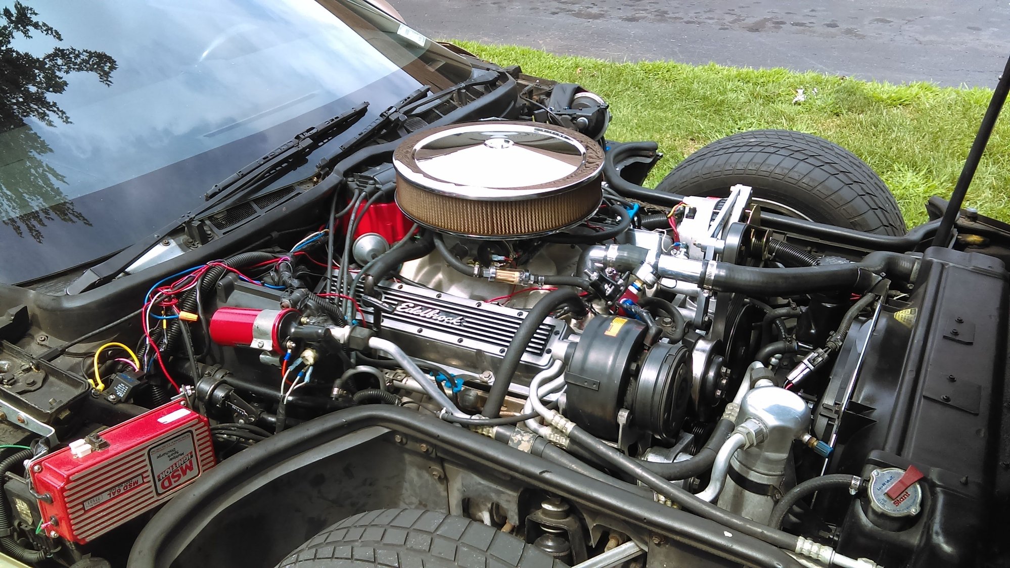

my 85
It's had to see, but the remote start button is still there on the cruise control bracket. Still hooked up. Makes it easy when doing engine work. Tractor Supply 30 amp momentary push button switch.

Nice looking engine. Did you cut the hood for air flow. If not, how do you deal with the fuel percolation issue.

Yes, I needed 1.5" to get the setup I wanted .
The hood is home made using a real 427 hood scoop, and set up like the 427 L88. A tight fit into a hole in the hood. I also have a 6 speed Richmond - which was not a great choice, should have gone Tremic but It was done 15 years ago.
