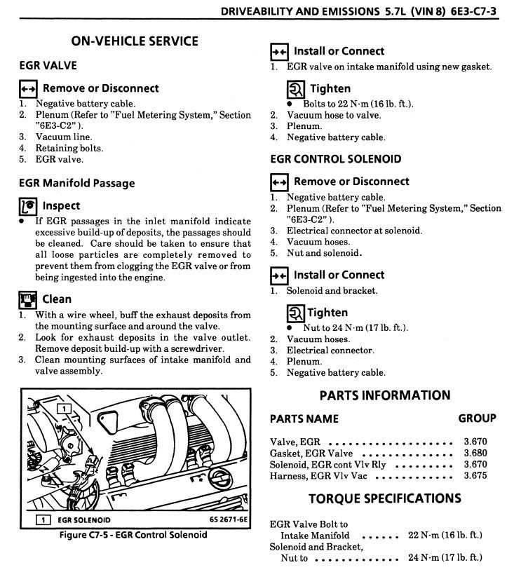

Thanks guys..............Does anyone know where the EGR solenoid is on the 90?

Here are pictures from a 1990 FSM. They claim you need to remove the plenum to remove the EGR Solenoid. I don't know if that's true for a 1990. You don't need to remove the plenum on my 88, and the 85 EGR Solenoid is on the other side of the engine.

The EGR system on the 90 is the same for 91.
The solenoid is located on the rear mounting bolt for the thermostat on the intake manifold.
I have had two EGR solenoids fail and cause 32’s. I got tired of digging under the plenum, so I relocated the solenoid to the bolt on the AIR pump.
First, check your spaghetti lines for the entire EGR route. Mine were old and brittle and kept breaking. I pulled all new rubber lines. You do not need that little manifold on the solenoid - it just keeps track of the hose routing. I eliminated mine and just plugged my vacuum lines directly to the solenoid.
Recall your system has ported vacuum. Before you start yanking lines, make sure you document where they start and finish.
The EGR solenoids are not cheap.
