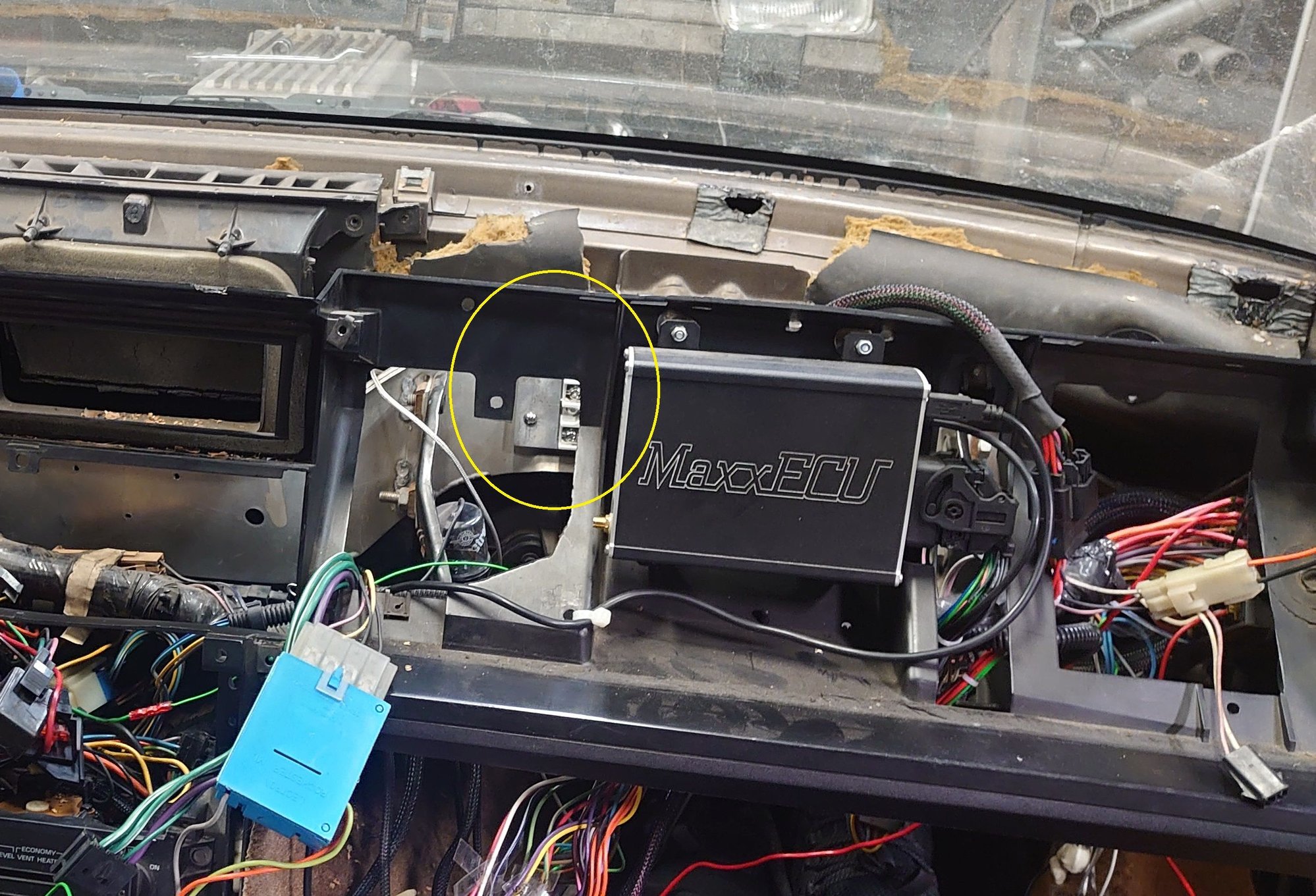

Originally Posted by JoBy
With my MaxxECU I also use PWM and a SSR to have speed control of the water pump. I am going to remove the thermostat, but I hae not done it yet. During warmup the pump is running at 20% duty for a few seconds and then waiting for a while. This way no thermostat is needed. After initial warmup the pump is running all the time with increased duty as temperaure gets closer to target.
Thermostat seems pointless with this control strategy; totally agree.
I really wanted to use something like your control strategy but with a more traditional Meziere electric water pump but I couldn’t get any information from Meziere on whether their pump could be safely controlled via PWM and if so what frequency switching speed to use…
I’d honestly like to use a strategy like BMW does with their electric thermostats -higher temps at highway cruise for mpg improvement and lower temps when you want performance but I can’t figure out what to use as the X and Y inputs for the custom Holley pwm table… temp and throttle position?
How do you protect your SSR from water? Any pictures? I’ve used a water proof plastic electrical box with the SSR and electrical connections inside the box and then a hole cut through the box with the heat sink attached to the outside in a brewery application before and I’m thinking the same solution would be pretty perfect for automotive apps, too. (I’ve never used 12v SSRs; only 120v and 240v.)
adam

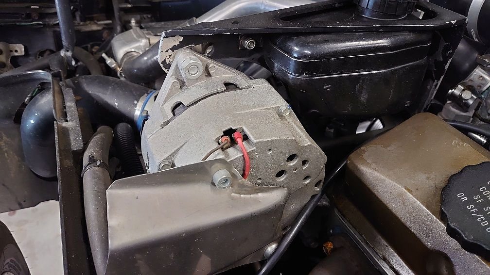

One thing I notice, and this is not new, is that the stock alternator does not really keep up with demand, especially at idle. Running four fuel pumps, electrical fan, electrical water pump, AC converter for the laptop, It all adds up.
There are more powerful alternators that fit but from what I have read they seem to fail from overheating, There are modern water cooled alternators that might be an option, but a new bracket would have to be manufactured.
How many amps is the stock alternator on your car?
I’ve got a C3 so the stock alternator was only 60 amps, I swapped to a CS144 alt because the lower rpm performance is so much better; I planned to switch to a 140amp model but 170amps was all I could find. I’m vain so I got a polished aluminum Tuff Stuff alt, but maybe the alum case means a tiny bit more natural cooling?
My experience is running electrical stuff close to its capacity is when heat is an issue- when I oversize everything heat doesn’t seem to be a problem.
Adam
Adam
Don't really know. I bought replacement many years ago. Don't remember the brand.
Edit: I actually found the box for the alternator. It seems to be a 17SI 108A alternator.
A CS144 conversion might be the simple solution as that alternator seems to have improved low rpm charging.
adam
It is well protected with a good heat sink.
You can barely se the edge of it in the circle.
