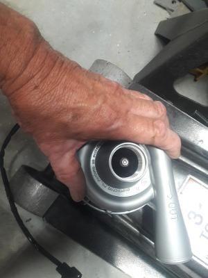

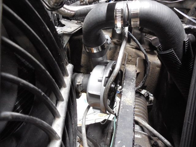

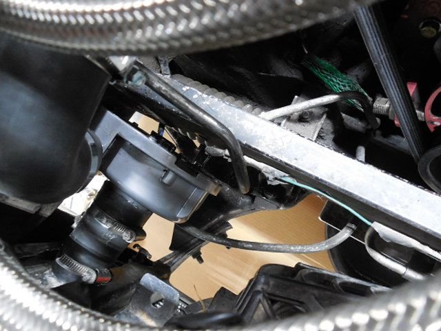

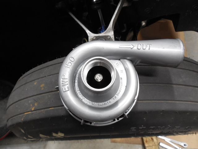

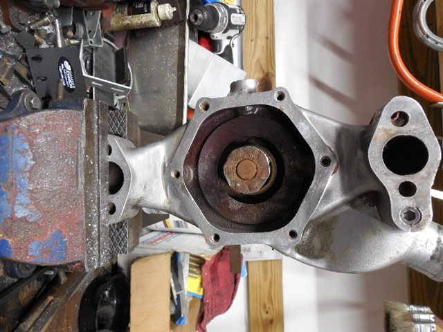

..... This weekend's previously scheduled 2-day bracket race @ Bradenton was postponed due to the weather forecast . So , to get my racecar "fix" for the weekend ... I decided to upgrade the cooling system with an electric remote water pump in an effort to promote faster cool-downs between rounds . I decided on a Davies Craig EWP 150 rated at 39.6 gallons per minute . To make the install a little less complicated , I opted to keep the engines mechanical water pump in place (less the impeller) to keep the serpentine belt running in the same circles as it was . The Davies Craig pump is fairly compact and was installed at the radiator lower outlet . I was disappointed by the cumbersome hose configuration but it was necessary to make some splices to connect things up . The factory lower hose is 1.25" diameter except at the water pump ... the remote pump comes with 1.5" nipples ... same as the water pump inlet nipple . I drilled 4 eighth inch holes in the thermostat flange (D-C recommends 2) and removed all of the blades from the engine water pump's impeller . The engine pump is now an idler pulley and water distribution device ... The only part that I overlooked was the abolishment of the stock belt tensioner (too much plumbing work) ... so now I need to make an alternator/ belt tensioner to tighten up the serpentine ... I will report back with the results of this mod .....

Turned your WP into a water manifold, I'd be temped to completely gut it, press out the shaft and get rid of the pulley, then weld/epoxy the front shaft hole shut. Since it's a drag car, I'm betting you just have an alt and no power steering. If so I'd do the mod most do to when they delete AC, tensioner & the air pump to make the alt adjustable n tension the belt that way. Only run a crank pulley and alt.

..... I wanted to keep the pulley in place for the serpentine belt ... my car still has power steering and 2 alternators .....

..... Driveway update ... I finished my adjustable upper alternator bracket and fired the car up ... it didn't take long to feel some heat in the upper radiator hose , I guess the 4 -1/8" holes in the thermostat pass more water than I would have thought ... the BEST part was the after shut-off cooldown ... this is exactly why I put an electric water pump on in the first place ... it took about 3 1/2 minutes to cool the engine from 170 to 140 with the fan on low speed ... should happen much quicker with the fan on high speed ... the true test should happen this weekend at either Gainesville or Imokkallee ... depends on which has the better weather forecast ... Gainesville is 3hrs North and Imokkallee is 3hrs the other way ! .....
