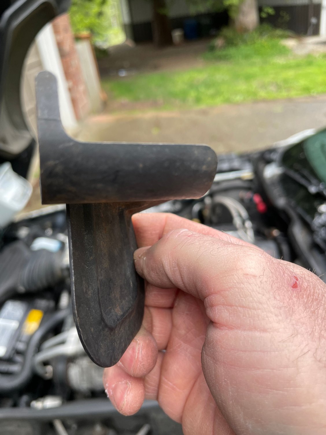

Default Part identification
This came off a '95, and I think it was from the alternator area. Anyone know where it goes? I keep thinking its meant to protect the Alternator live wire, but I can't get it to work for that purpose.

Pass side, rear intake stud is where it mounts. It protects the wire harness from the air tube that goes off the header to the rear of the intake.

op, i see that your engine is an lt1.
the location you are seeking in the above photo is on the passenger side of the engine at the rear just above the valve cover and bolted to the intake manifold. the half moon portion holds down the wire bundle and the wing is vertical. if i knew how i would have circled it.

I see it there. Thanks.
