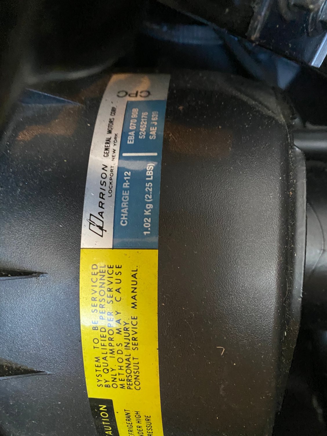

The 1990 model requires 2.25 lbs. of refrigerant.
