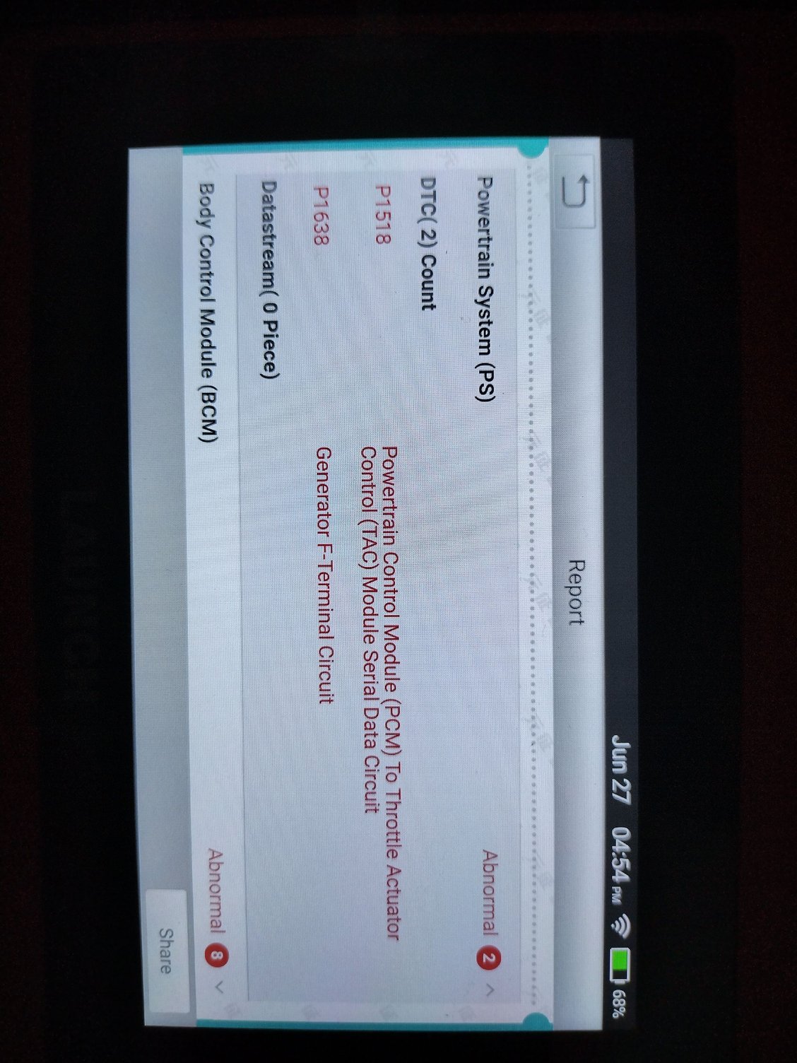

I've been recharging the battery while it's in the car. When the battery is fully charged, just opening the driver door drops the battery to 60% charge that quick. It's acting like there is a direct short somewhere but only when relays and such are activated. Because of this huge drop in voltage, I'm unable to read any codes.
I will take the new battery in and have it tested.

My code reader did capture some error codes. It looks like there is a dead short someplace.

And there is more.
