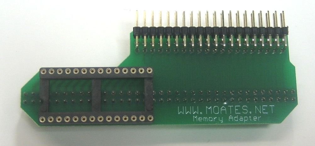

EDIT: So you know....There is a 3-4" long "chip" (PROM) in the 1227165 ECM. It get's yanked. In place of it, most people use one of these "adapters" from Moates....
A chip plugs into the lower left. The long prongs (upper right) plug in where you pull the stock prom. (It's called an adapter because you are burning another type of chip -- and using this "board" to adapt it for the ECM)
This doo-dad burns chips using [free/cheap] software downloadable from the net - like TunerPro/TunerCat. Really, you're only entering numbers in a "spreadsheet-like-format" so your ECM's processor knows how to control your new motor....fuel, air, shift-points, idle, etc...
Ramming is the
