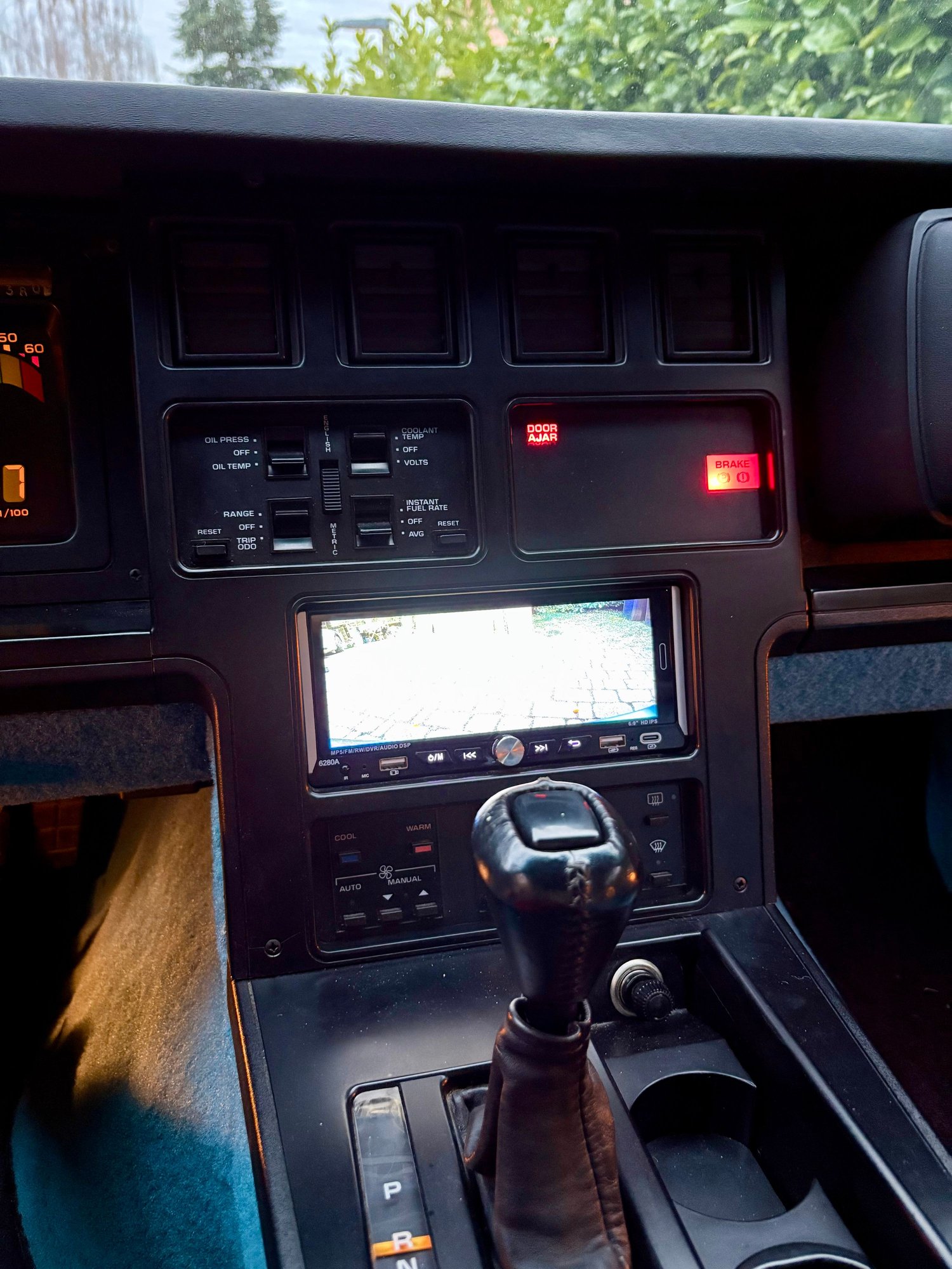

1.5 din 6.9 inch , cost nothing, you can even have a backup camera and digital radio. And you get CarPlay/android auto
What brand? Where did you get it from? How's it mounted...is it an actual stereo with amplifier built in?

AliExpress, mounted with home made bracket ( simple pieces of L shaped aluminium riveted to radio mounting frame). 4x40W
Any other pictures? What are your overall impressions of it so far? Seems to fit very well, I don't understand why so few manufacturers don't offer 1.5 DIN....there's definitely still a market for it!!! Thanks for posting this, gonna look into it, still on the fence about if I'm going rebuild amps and keep the Bose, or go modern....my days of multiple amps and sub-woofers are long gone....but I do want cameras front and rear, wireless Bluetooth, GPS, etc...I'd do a smaller 4-channel amp for the factory speaker locations, but no MDF box in my vette....does it have front/rear/sub pre-outs and remote turn-on wire for an amp? Anyway, looks good👍

Yes all pre-out, remote amp and antenna triggers. Built in amp is not terrific but it works with my JBL stage 3, less than 200 for radio + speakers. Do not stuff rear speakers too much. Front are in the dash (drilled the plastic and changed the fabric) for better clarity. Did select the wiring from comvette project.
Unfortunately can’t find a pic of the brackets.
