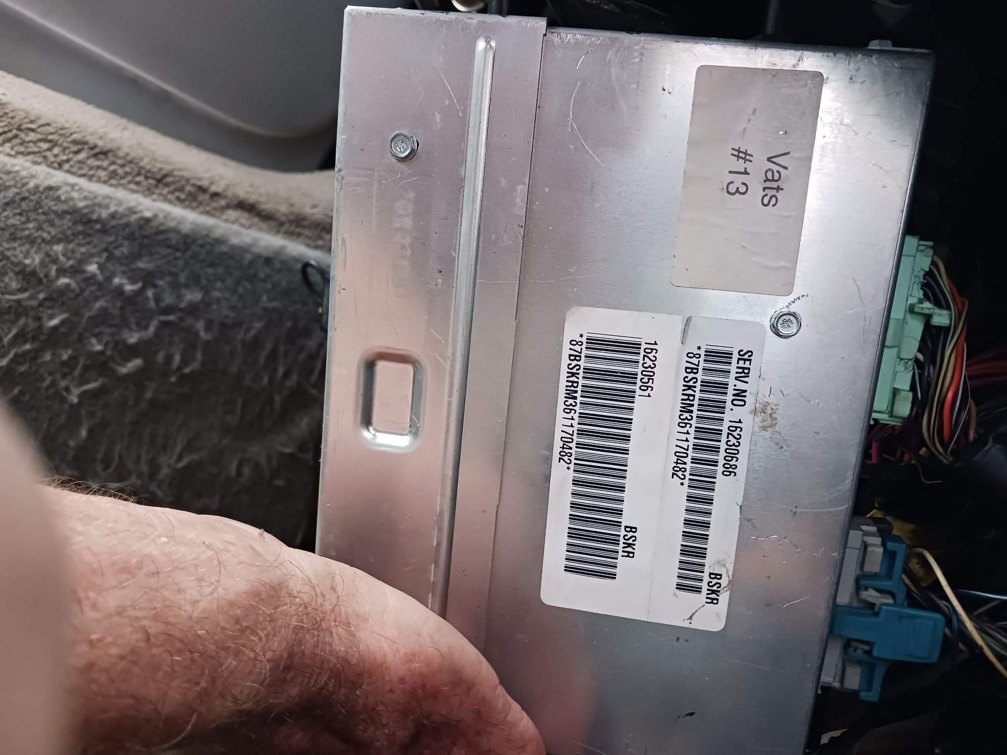

I called the guy at PCM for less and he sent me a reprogrammed PCM. He set it for the cam per the cam sheet. Set it for 30# injectors, set the fans at 195. Turned off the skip shift. Turned off the lower O2 sensors. If I decide to bite the bullet on some headers I wont have to mess with the rear O2 bung. He never said anything about the VATS. I got the PCM plugged it it and the car runs great. I know he didn't turn it off because it was still working, the flashing etc. Fast Forward 1 year. I had to replace the starter actuator in my column because the old one decided to break. This was another new repair for me and took a while. I pulled the column to get easier access. I had to have the ignition switch out, I can't believe how small the VATS wire is, so I decided to bypass the VATS. I checked my key, 8K ohms, ordered the bypass module from Ecklers. Installed it and the car starts and runs as normal. Is the VATS info not housed in the PCM on the 96?
Thank you
No its not housed in the PCM for a 96 year model sweetie it is housed in the CCM (Center Control Module) its behind the cage thats behind the radio and climate control

Originally Posted by Tom400CFI
VATS is w/in the BCM.
Darlin' U help alot of people like me.... I think we have a good thing going on this VATS problem for alot of people look at my answer ❤️
