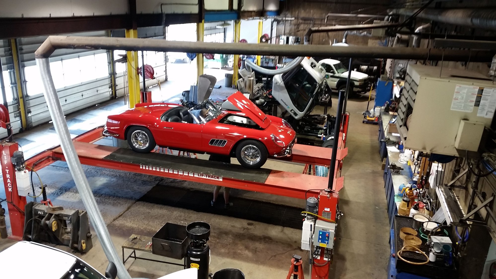

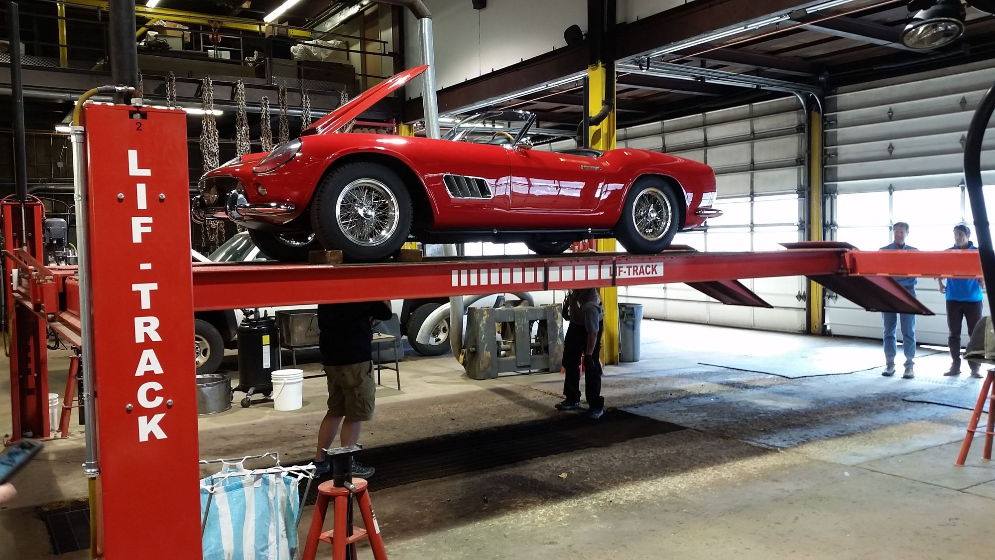

You should post up some pics of your shop! I'd love to see it. Here are a couple of mine....

Hoy ****!!! That's triple bad ***!!!
