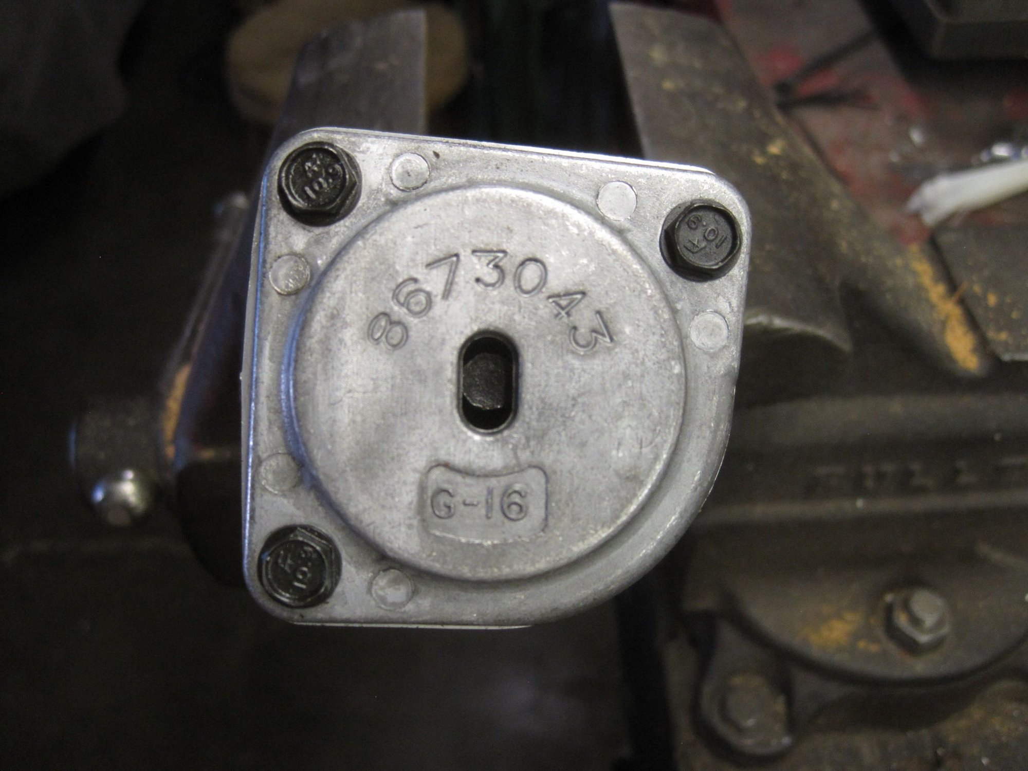

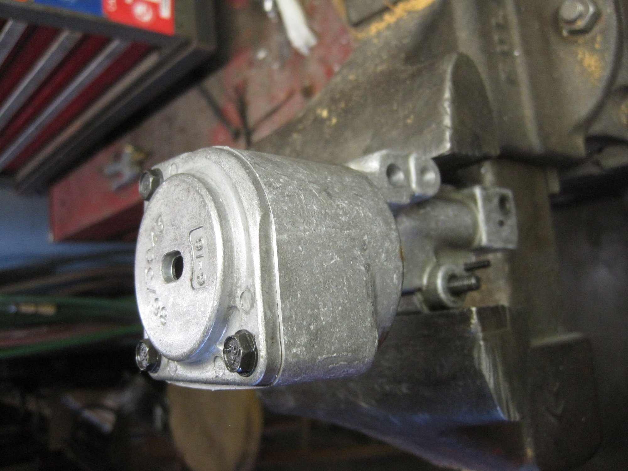

Originally Posted by IHBD
Yes, it will cause a loss of pressure in the forward clutch circuit. The accumulator is in this circuit. The accumulator cover has a hole it it. Pressure from behind the cracked piston now goes through it and out the hole in the cover.
You are describing correctly what would happen if the 1-2 or 3-4 accumulator pistons cracked. They don't have orifices to the outside. The forward accumulator, with its hole in the cover on the aux valve body does.
I just took these of an aux valve body I have in my stash:
I will investigate further. If so, I stand corrected.
