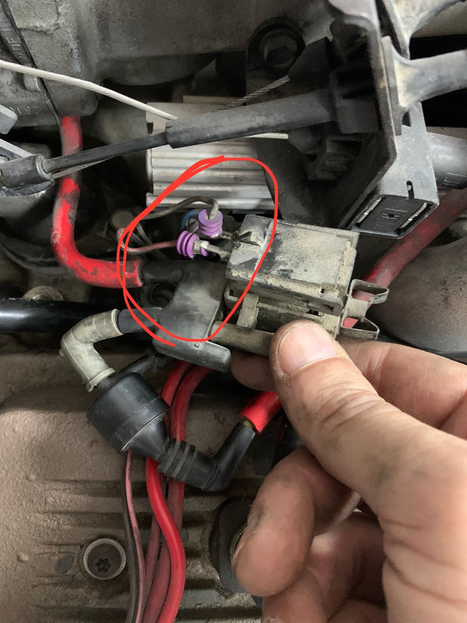

Need an advise,
when i removed the thermostat the below photos of a switch or connector was connected with the bolt holding the water neck (thermostats housing) looks like the electrical connectors are corroded and snapped when removed,…
I guess it is for the injectors and vacuum lines (correct me if I’m wrong) how this can be fixed or replaced.. any part number so as to orders a replacement?
Thx
