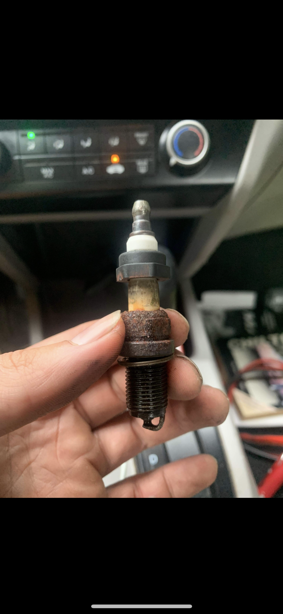

I changed the oil right after that but I don’t recall the color being off. The color looks fine now but it does smell a little like gas. when I took the old plugs out they were all pretty gunked up with I think oil.

Hard to see but that ground strap looks like its touching the center electrode?
I threw them out after I replaced them so I can’t look. But I remember the ground strap being bent and touching. They were all in pretty bad shape.

Sorry to say but if those plug grounds were bent, that's not good. That would be a physical interference issue.
